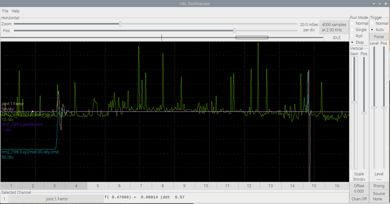

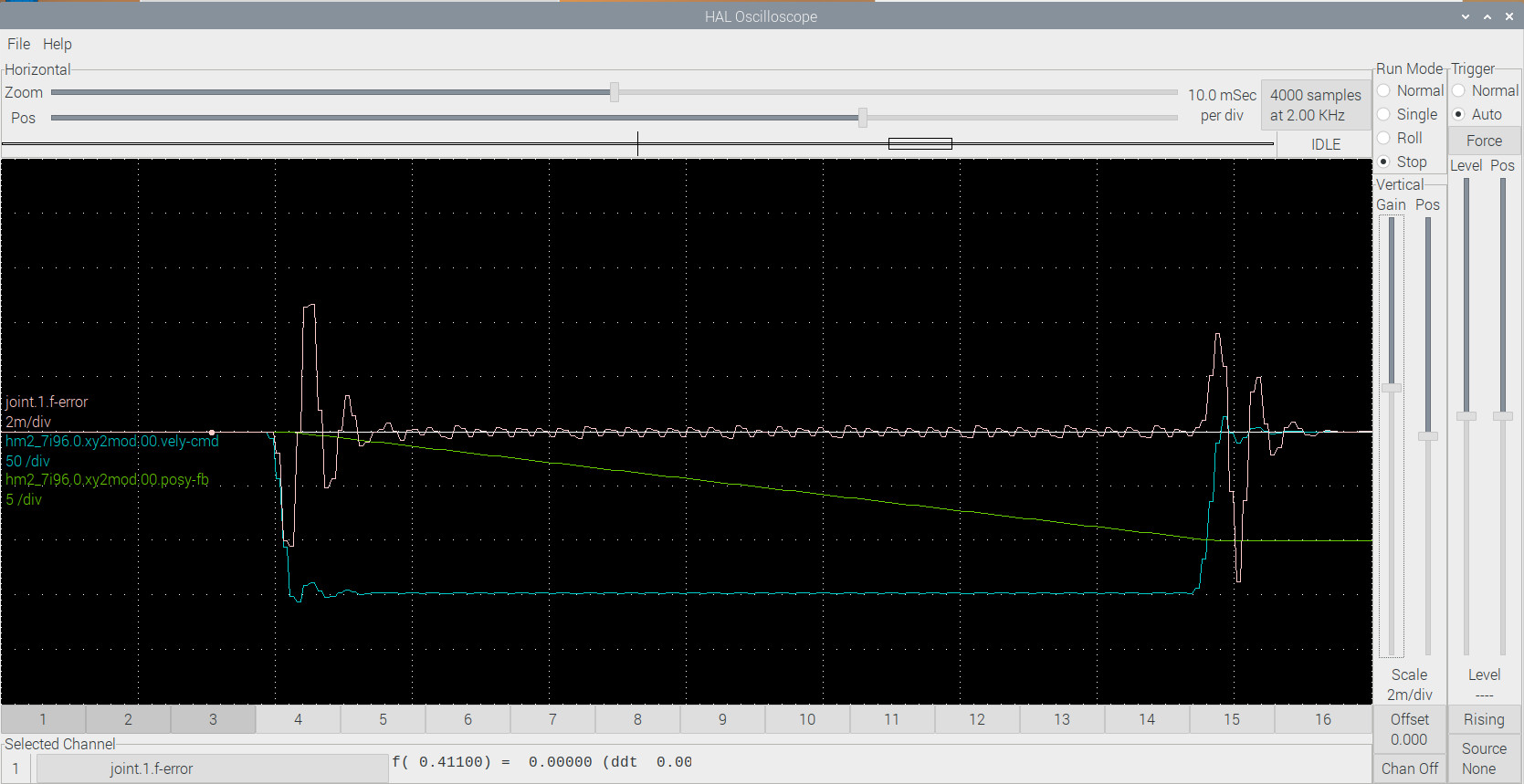

06 May 2021 00:05 #208046
by Limedodge
Replied by Limedodge on topic RPi4 & 7i96 XY2-100 Following Error at High Velocities
I noticed something interesting
These are both scope screenshots from the same run. F.error vs vel_cmd vs pos_fb.
The first is running "normally" (albeit with ringing). The second SS show the moment it fails (zoomed way in)
It almost seems like the pos_fb is "late". It has already been commanded to change velocity but the fb doesn't show any action.

06 May 2021 00:12 #208047
Replied by PCW on topic RPi4 & 7i96 XY2-100 Following Error at High Velocities
It may be that at 2 KHz on a RPI
you occasionally drop packets
You might back it down to 1 KHz and
see if you get the same errors

06 May 2021 01:24 #208057
Yeah timesyncd is almost guaranteed to cause this kind of issue
