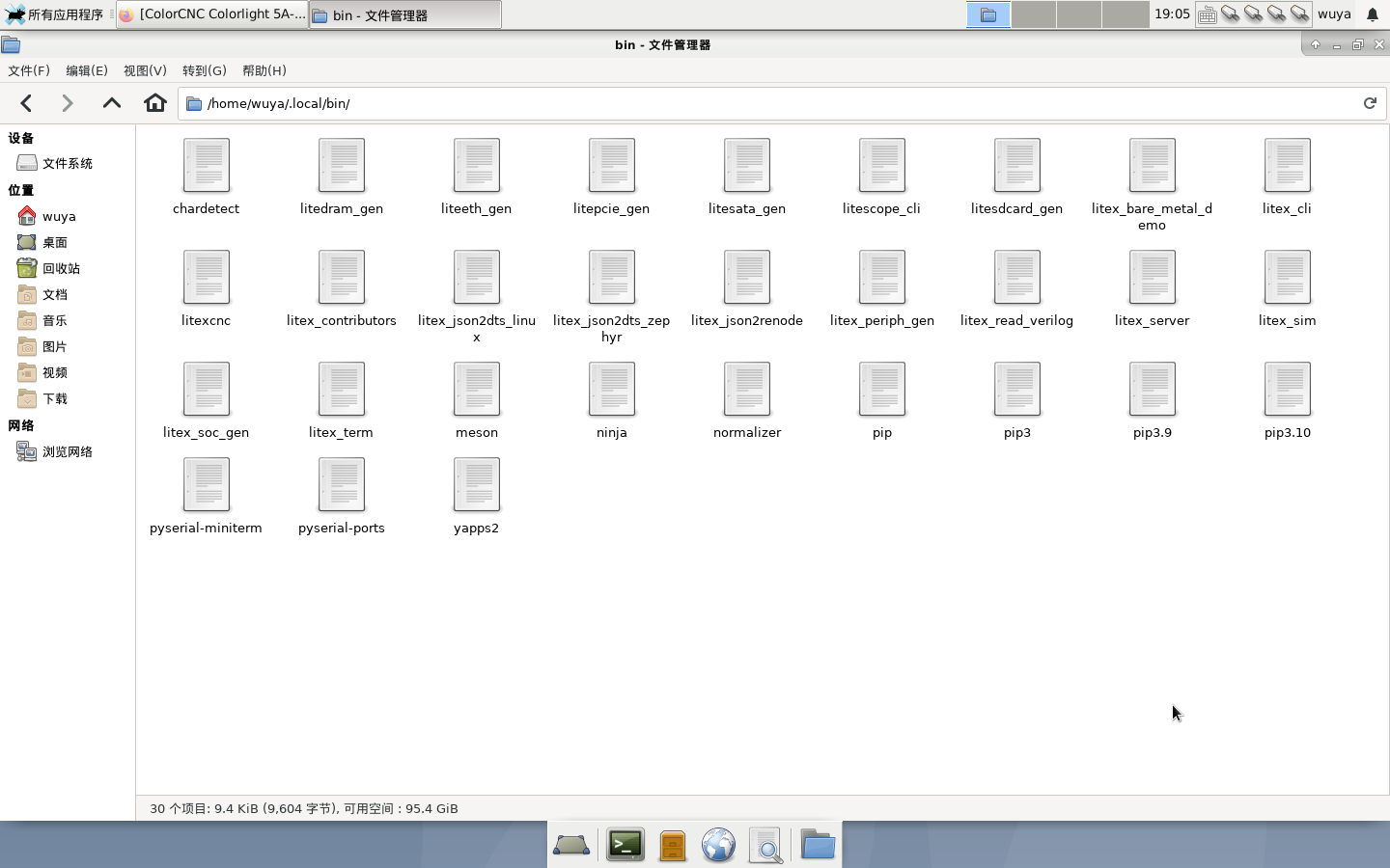

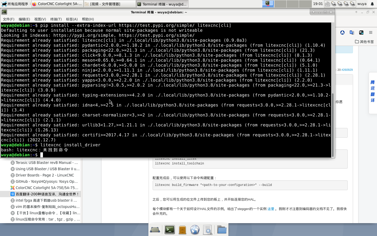

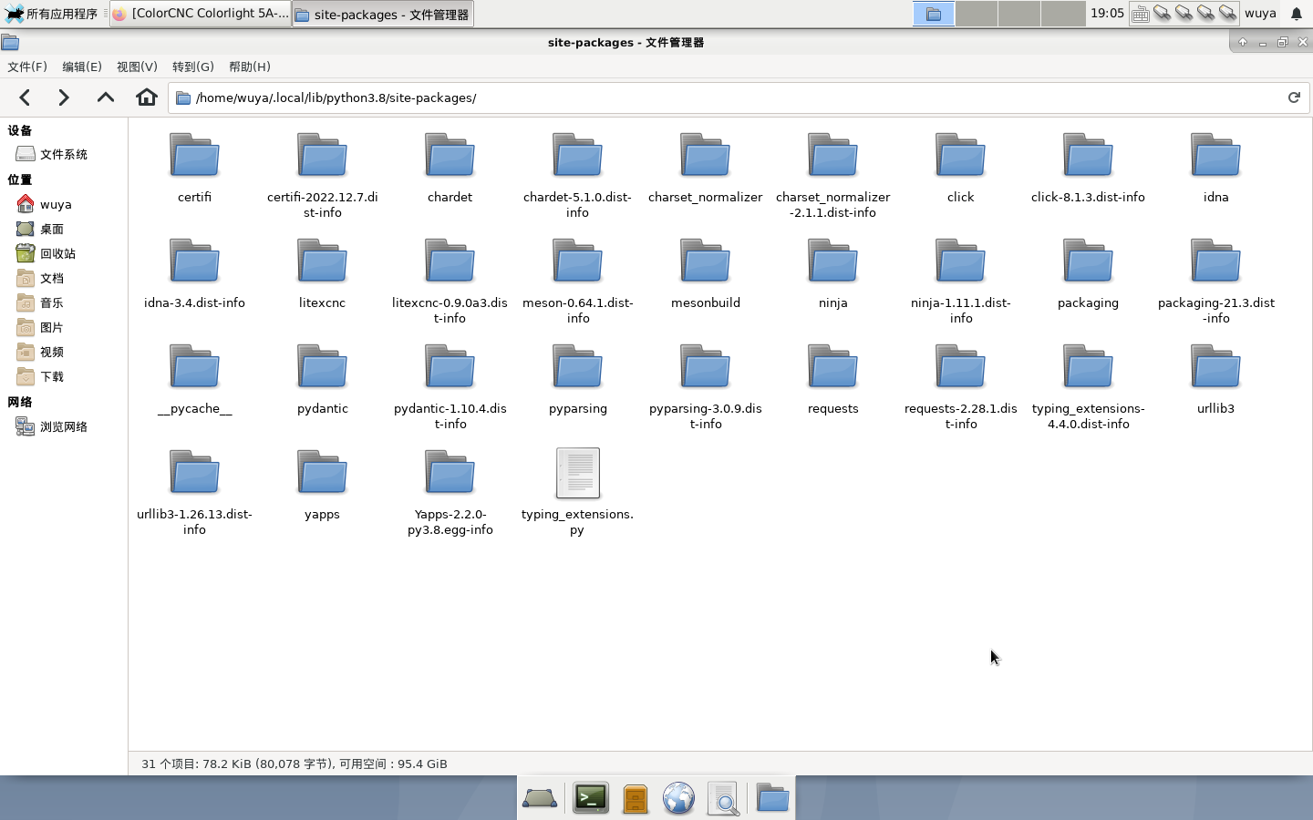

- wuyatom
- Posts: 42
05 Jan 2023 11:09 #260992

@wuyatom: Unverified, but I think you can also try to call:
I'm typing on a smartphone, so cannot verify at this moment.
Edit:
Just verified that indeed you can use the command above. Make sure that when you call python it starts the correct version where litexcnc is installed. In some cases you must use python3 or python38.
python -m litexcnc install_driverI'm typing on a smartphone, so cannot verify at this moment.
Edit:
Last edit: 05 Jan 2023 19:27 by TOLP2. Reason: Verified solution
