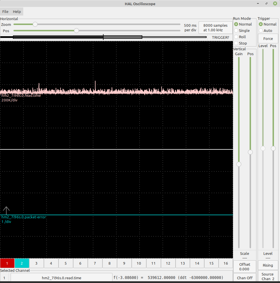

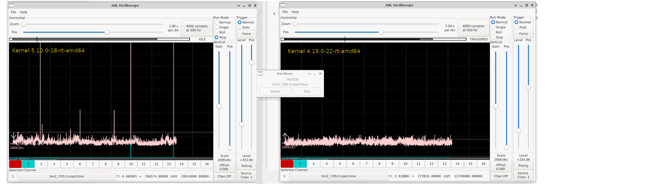

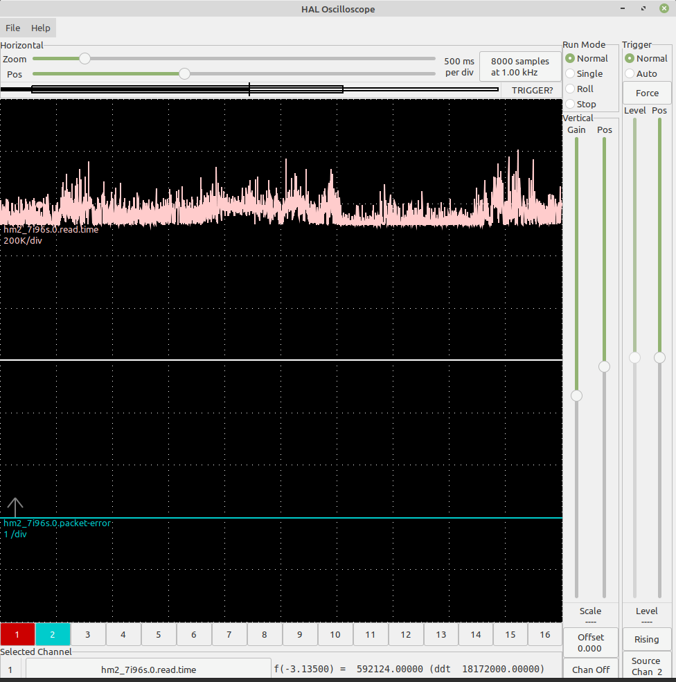

18 Oct 2022 10:21 #254386
by bensttech
Replied by bensttech on topic Mesa hm2/hm2_7i96s.0: error finishing read
4.19.0.22-rt still stable. For interest/completeness i have posed the scope plots of both 4.19 and 5.10 below same hardware and settings, scoping both the read.time and packet.errors. As can be seen the spikes in read.time cause packet.errors and enough of them and to you get a error finishing read. So far on 4.19 i have not seen 1 error or spike. I would be interested to see others who are running anything other than 4.19 to see if they hanging on the edge of failure or if there are other factors.
