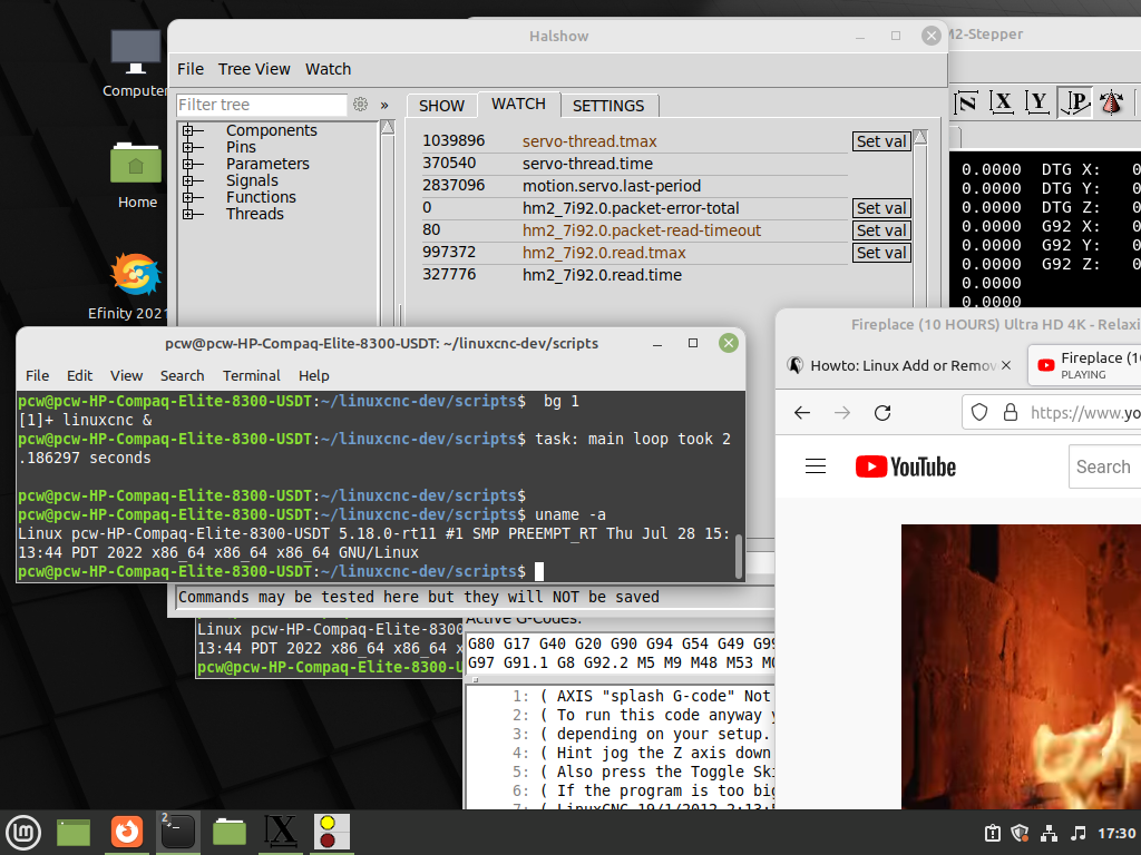

21 Oct 2022 00:34 - 21 Oct 2022 00:36 #254638 by PCW
I don't seem to have an issue on my 8300 USDT and a 5.18 kernel
(This is after a couple hours with a youtube video running)
Last edit: 21 Oct 2022 00:36 by PCW.
21 Oct 2022 01:05 #254640 by rodw
Interesting. what NIC card does HP use? This should report it
sudo ethtool -i eth0
21 Oct 2022 01:23 #254642 by PCW
Intel 82579LM
21 Oct 2022 01:35 #254643 by rodw
Intel 82579LM
Thanks, I thought HP would use Intel hardware.
That sums it up. The 5.1x kernels are crap with Realtek NIC's with real time.I wonder how we could report that back through Debian or the kernel maintainers?
It seems a bit silly to bring preempt_RT into the mainstrema kernel to be let down by non-realtime network access.
