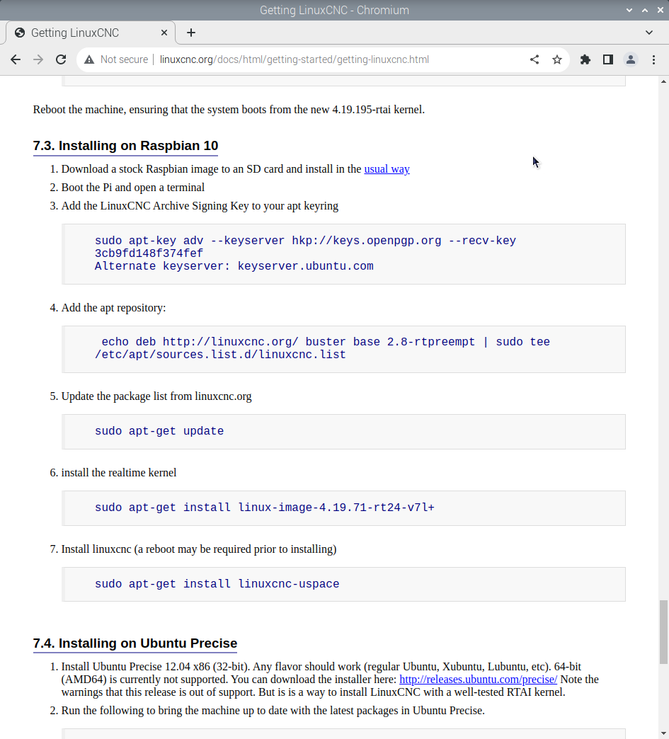

Perhaps, from what I see, the error may be due to the fact that the installation refers to a package .deb for the 32-bit version (armhf) while the Raspberry Pi OS (64-bit arm64) is installed.
03 Oct 2022 12:21 #253342 by andypugh
The thread title says 32 bit.
I keep telling him to just install the pre-packaged 64-bit SD card image with kernel and application already installed, and he replies with threats to close the forum down and (apparently) reporting me to the moderators (not noticing that I am a moderator)
Some people offer more motivation to help them than others.
03 Oct 2022 12:27 #253343 by andypugh
Anyway, the instructions on the web site specify Raspbian 10, and the system installed appears to be Raspbian 11.

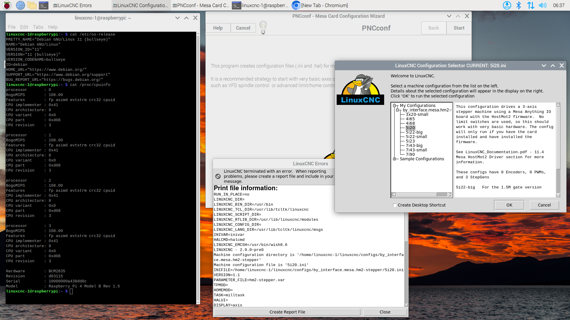

andypugh gives bad advice. I DID NOT follow any of his advice.
I have LinuxCNC running on a Raspberry Pi 4 8Gb (version 1.5 - new). Also, the sd card works in a Raspberry Pi 4 8Gb (version 1.4 - old)
I started with a clean install of:
2022-09-22-raspios-bullseye-arm64.img
Then I installed synaptic. Which I edited the sourses.list to point to Debian wormbook:
2.9.0~pre0+git20220906.02744cdef6-1
Then I installed LinuxCNC 2.9.0~pre0.
Screen shot:
Last edit: 05 Oct 2022 11:21 by kdsands88. Reason: Delete duplicate screen shots
