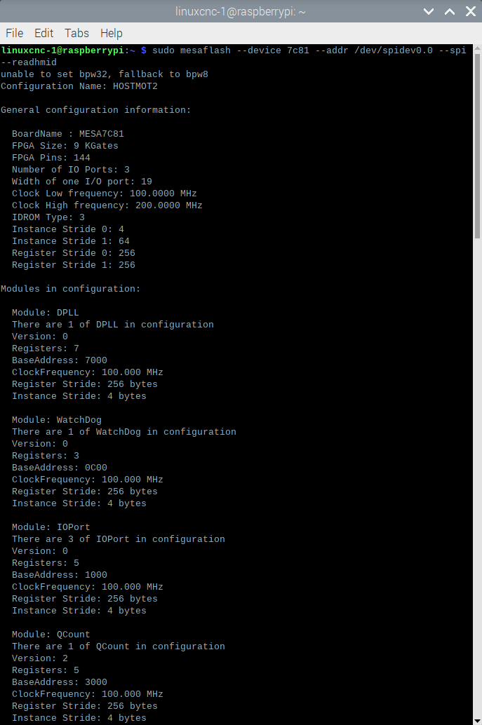

@PCW
You are correct.
Per:
www.raspberrypi-spy.co.uk/2014/08/enabli...on-the-raspberry-pi/
I enabled the SPI port and all is well:
You are correct.
Per:

Well you need hal/ini files setup for your hardware
Running pncconf for a 5I25-->G540 configuration should be a good start
You would just need to change the driver name (from hm2_pci to hm2_rpspi)
and the card name (from 5i25 to 7c81)

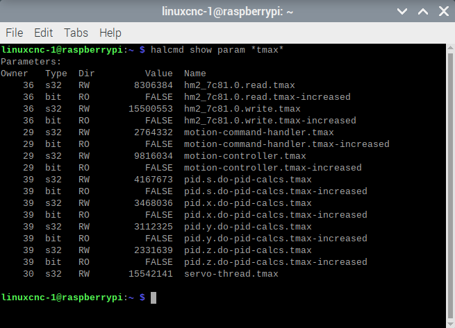

@PCW
I am now getting a Watchdog has bit error.
Per you post #136606
Output is:
How can I tell which Kernel I am using? Preempt-RT kernel or RTAI kernel
I am using Linux 2.9.0~pre0 from: ftp.us.debian.org/debian bookworm main
Which version of LinuxCNC for arm64 should I be using?
Output is:

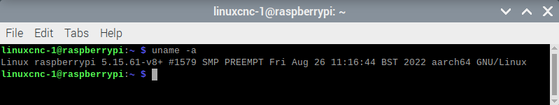

what does:
uname -a
report?
what does:
uname -a
report?
- kdsands88
- Posts: 28
10 Oct 2022 00:24 #253835
by kdsands88
Replied by kdsands88 on topic Raspberry Pi 4 8Gb version 2 / Raspberry Pi OS 32-bit / Mesa 7c81 / Gecko G540
- Posts: 18103
- Thank you received: 5326
10 Oct 2022 00:50 #253836
Replied by PCW on topic Raspberry Pi 4 8Gb version 2 / Raspberry Pi OS 32-bit / Mesa 7c81 / Gecko G540
Yes, that is not a real time kernel, you need PREEMPT-RT kernel

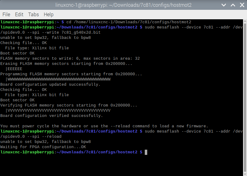

15 Oct 2022 21:04 #254194
by kdsands88
@PCW and @andypugh
I followed andypugh advice from #253210 and used the raspberry pi image from post #238020.
I had to add WiFi access and a different terminal. The image does have a terminal, but you can not copy and paste in it.
After adding Mesaflash from synaptic, I was able to follow your directions from this topic and other previously mention post.
I now have two Raspberry Pi 4B 8Gb (vesion 1.4 and version 1.5) working
Thank you for your support.
