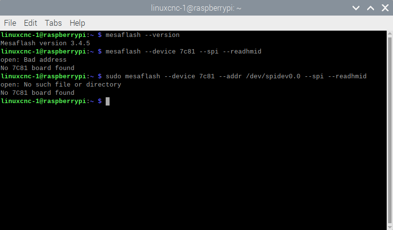

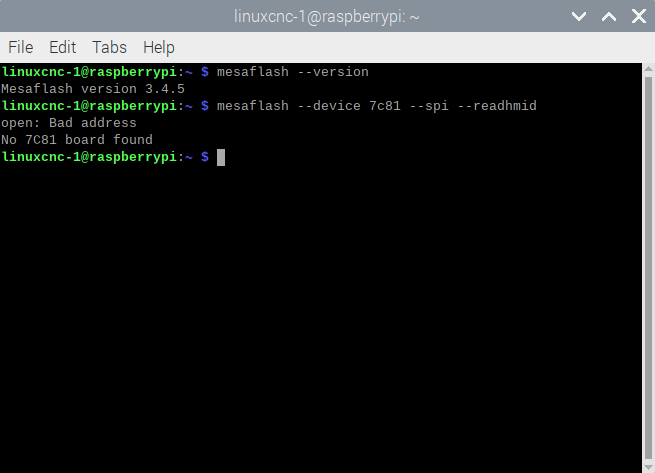

08 Oct 2022 19:41 #253772
by kdsands88
Replied by kdsands88 on topic Raspberry Pi 4 8Gb version 2 / Raspberry Pi OS 32-bit / Mesa 7c81 / Gecko G540
- Posts: 18075
- Thank you received: 5314
08 Oct 2022 22:15 - 08 Oct 2022 22:18 #253776
Replied by PCW on topic Raspberry Pi 4 8Gb version 2 / Raspberry Pi OS 32-bit / Mesa 7c81 / Gecko G540
You are missing the spi device name (thats what the "bad address" is all about)
sudo mesaflash --device 7c81 --addr /dev/spidev0.0 --spi --readhmid
Last edit: 08 Oct 2022 22:18 by PCW.
- kdsands88
- Posts: 28
09 Oct 2022 00:39 #253785
by kdsands88
- Posts: 18075
09 Oct 2022 01:20 #253789
open: no such file or directory
means there is no /dev/spidev0.0
which probably means SPI is disabled in the RPI configuration
The following user(s) said Thank You: kdsands88
