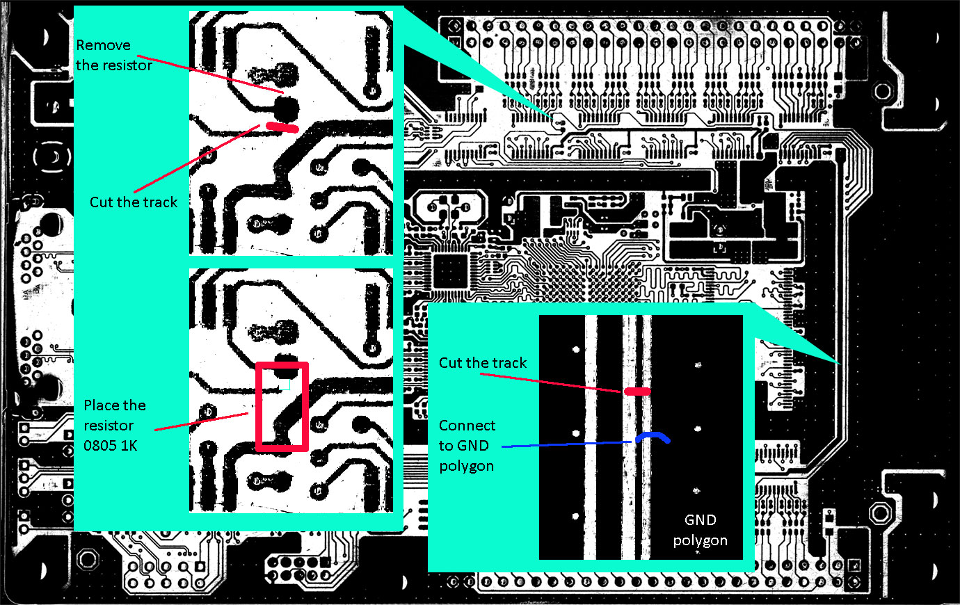

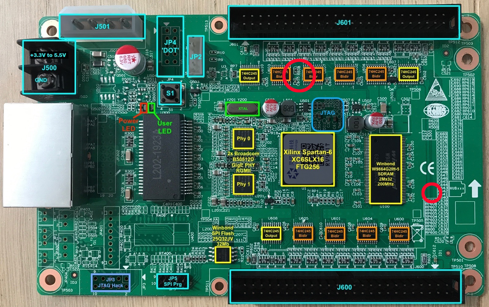

- IlyaKw
- Posts: 15
- Thank you received: 3
30 May 2023 20:51 #272518
by IlyaKw
Replied by IlyaKw on topic New project, litehm2: a hostmot2 port to linsn rv901t
If you wouldn't mind to post this info here then tomorrow I will do this with pics and an explanation.
In case of RV901T you should cut one trace in two places then solder it to GND and add a smd 0805 1k resistor to 3V3. In the end you will get U603, U607, U602, U606 as input and U605, U601, U604, U600 as output ports.
Do you by any chance have more information on where to cut it? A pic, or a link?
The following user(s) said Thank You: sensille
- IlyaKw
- Posts: 15
31 May 2023 18:43 #272597
by IlyaKw
RV901T Modification
There are two options.
The first one consists of:
1. removing of R608 resistor (upper part of the board)
2. cutting the track which goes to FPGA F13 pin,
3. solder the resistor (0805 1K) that will pull up to 5V upper segment of the track
4. cutting the track (bottom right corner)
5. connecting its bottom part to GND polygon
The second one consist of:
1. cutting the track (bottom right corner)
2. connecting its bottom part to GND polygon
3. in FPGA "connect" F13 pin to Vcc
All of these options work.
I hope I was able to explain the point
Regarding the supply voltage of the 245 buffers. Currently I have two boards that works with no modification of supply voltage. It is 5V (4.89 in fact). Of course it does not meet the requirements DC characteristics of Spartan6 but it works.I can't tell how long this will last.
It would be safer to power them from a lower voltage. One easy way to add a silicon diode to the +5V that supply the board.

Replied by tommylight on topic New project, litehm2: a hostmot2 port to linsn rv901t
Seems very clear on what to remove, cut, add, and solder.
Thank you.
