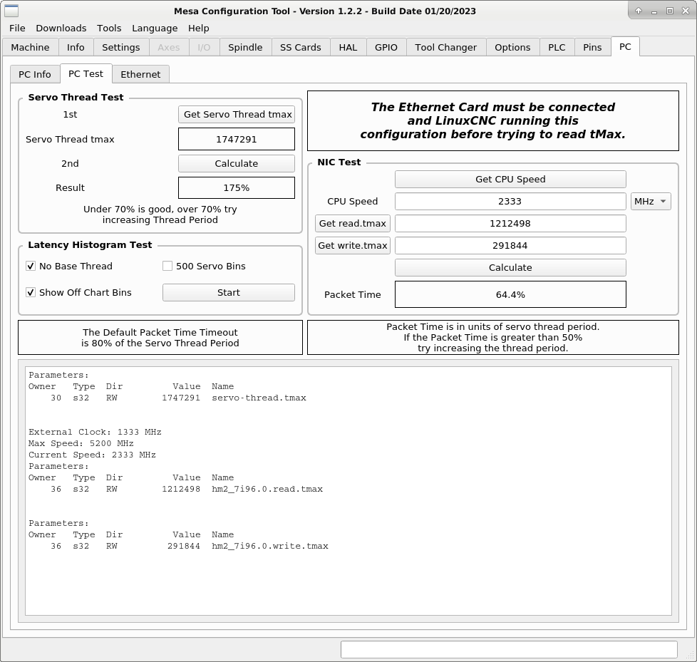

I have interesting problem. I have old computer. Everything is OK. Latency test is around 50 000. This is nice. But sometimes I get message about bad latency. So I made tests in MesaCT configurator:
The test went wrong. I do not want increase Servo Thread Period.
Is my computer weak for Mesa? Can something be done about it? Or should I just order a more powerful PC.
I tried using only the basic configuration from PNCconf and using LCNC 2.8.0. The values improved, but only slightly.

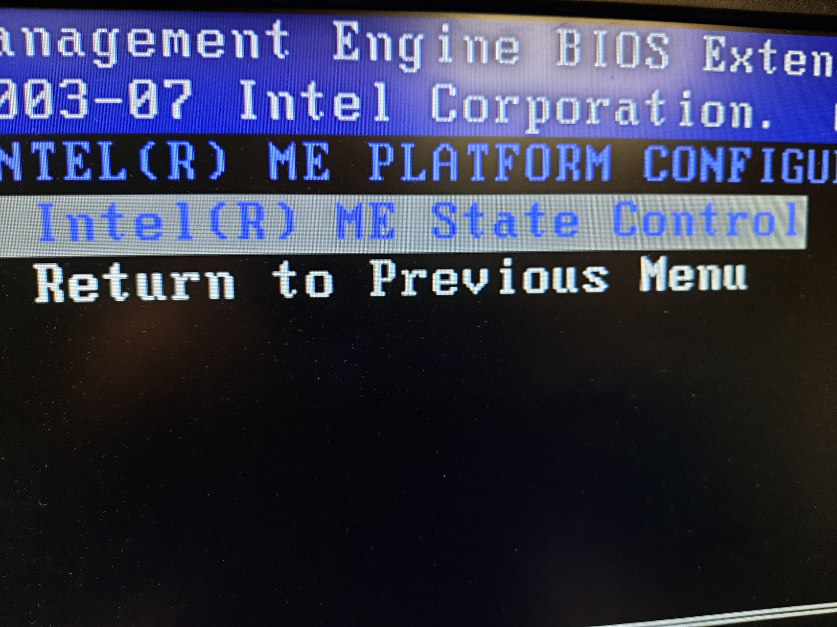

Its in ME setup (needs a password) I think AMT is enabled by default on the 755
- zz912
- Posts: 596
- Thank you received: 98
07 Mar 2023 16:42 - 07 Mar 2023 17:01 #266040
by zz912
Replied by zz912 on topic Optiplex 755
Is ME setup in BIOS?
Edit: ME is MEBx
Edit: ME is MEBx
Last edit: 07 Mar 2023 17:01 by zz912.
- Posts: 18100
- Thank you received: 5326
07 Mar 2023 17:04 #266042
Replied by PCW on topic Optiplex 755
Yes, you probably have to enable the MEBx message to access is through the BIOS setup
(and hope that the BIOS gives you access to AMT setup)

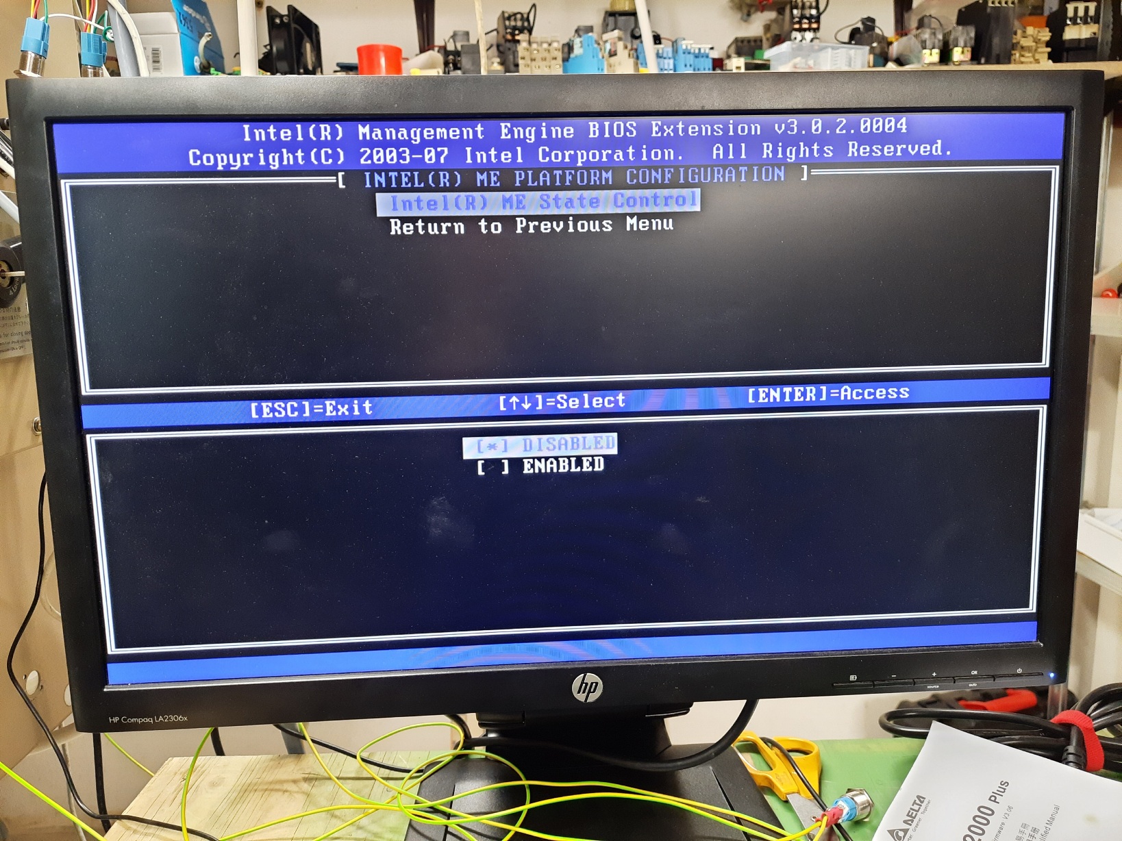

- zz912
- Posts: 596
07 Mar 2023 17:36 #266047
by zz912
I disabled it, but it did not help.

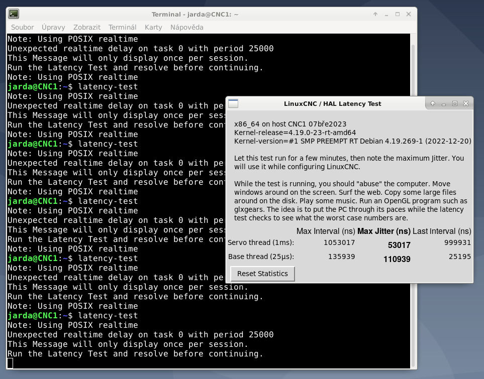

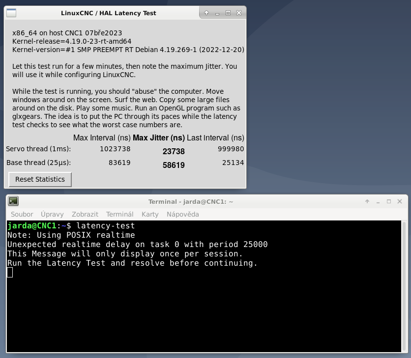

07 Mar 2023 18:30 #266052
by zz912
Hello,
1) Kernel is in Pictures
2) I have new knowledge. We can rule out a Mesa card error. A latency-test is enough to simulate the problem. Look at the following picture:
As soon as I start the latency test, the message immediately starts:
In this image, I managed to simulate that the error message only appeared after a while. Nevertheless, the latency-test showed satisfactory values. Why?
3) I tested branche 2.8.0 and 2.9. Both is same.
Unexpected realtime delay on task 0 with period 25000
This Message will only display once per session.
Run the Latency Test and resolve before continuing.In this image, I managed to simulate that the error message only appeared after a while. Nevertheless, the latency-test showed satisfactory values. Why?
- Posts: 18100
07 Mar 2023 18:56 #266053
A latency error may be expected with a 40 KHz
base thread but Its not too meaningful though because:
1. A base thread is not needed with Mesa hardware
2. The important thing is Ethernet latency which the latency test doesn't measure
You can get an idea of Ethernet latency with:
sudo chrt 99 ping -i .001 -q 10.10.10.10
