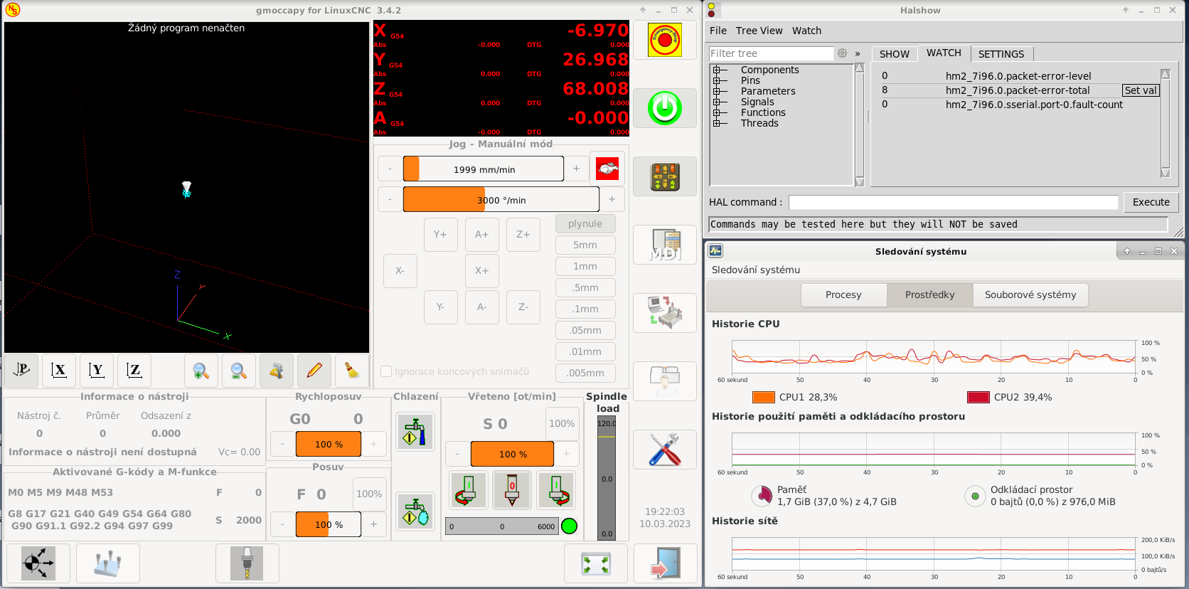

Optiplex 755
- zz912
- Posts: 596
- Thank you received: 98
10 Mar 2023 18:28 - 10 Mar 2023 18:29 #266314
by zz912
Replied by zz912 on topic Optiplex 755
Last edit: 10 Mar 2023 18:29 by zz912.
- Posts: 18103
- Thank you received: 5326
10 Mar 2023 18:42 #266315
Replied by PCW on topic Optiplex 755
That's not not great, do you still have IRQ coalescing and AMT disabled?
This should always be done.
You might do better on that hardware with another kernel

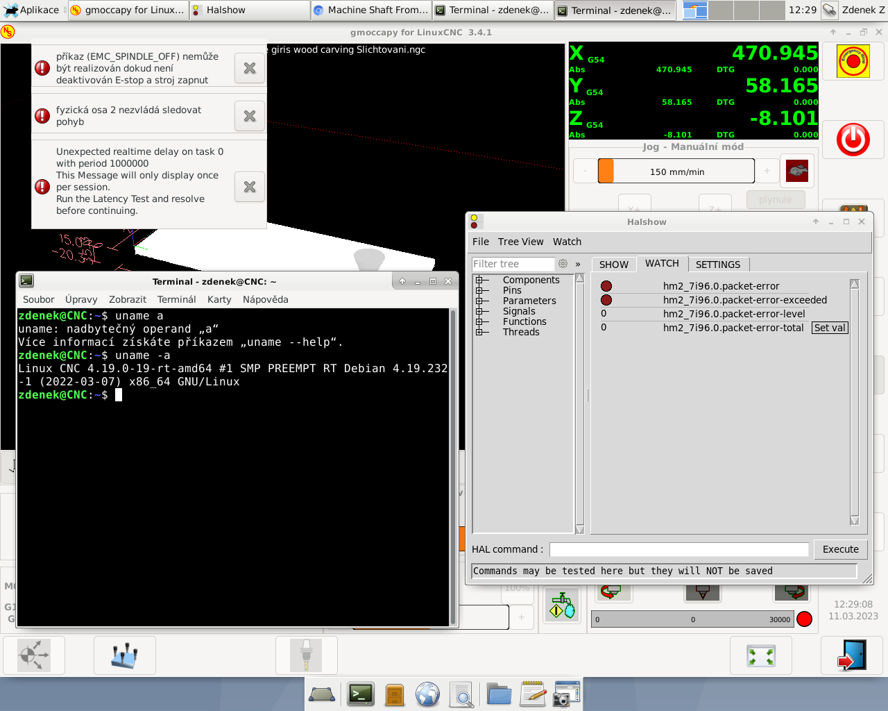

- zz912
- Posts: 596
10 Mar 2023 19:04 #266318
by zz912
I did not enabled IRQ or AMT.
Now I am trying change Kernel.
I will continue on Monday
sudo apt install linux-headers-4.19.0-19-rt-amd64 linux-image-4.19.0-19-rt-amd64 linux-image-4.19.0-19-rt-amd64-dbg
sudo grub-customizerI will continue on Monday
- zz912
- Posts: 596
11 Mar 2023 11:42 #266396
by zz912
- Posts: 18103
11 Mar 2023 17:35 #266418
Could also be a hardware failure of some kind

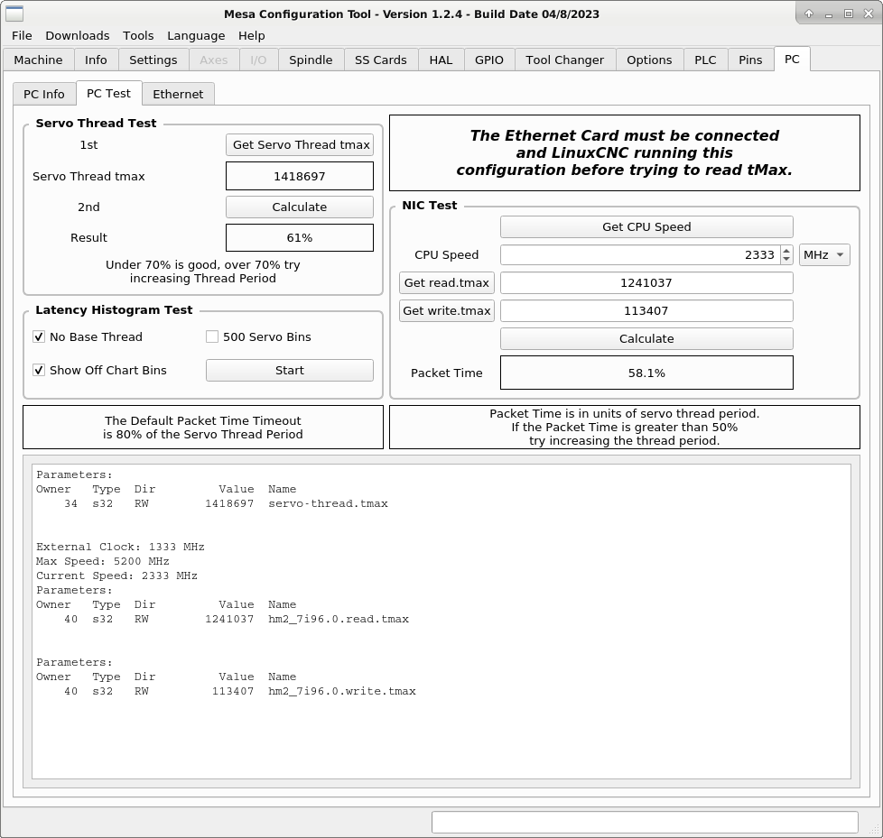

15 Mar 2023 11:21 - 28 May 2023 14:15 #266742
by JT
I can't figure out how you got 2333333 from 2333 MHz...
100(tmax/CPU_Speed*Servo_period)
So if tmax is 174729 and CPU speed is 2333 MHz and servo period is 1000000us what is the formula to arrive at 75%?
JT
Replied by JT on topic Optiplex 755
I think there is a bug in mesact
The servo thread tmax should show 75%
(100*1747291/2333333)
JT
Last edit: 28 May 2023 14:15 by JT.
- Posts: 18103
15 Mar 2023 15:05 #266753
2333333 is the number of CPU clocks per servo period
(2333333333*.001)
1747291 is the number of CPU clocks in the tmax value
1747291/2333333 = 0.748839107
(2333333333*.001)
The following user(s) said Thank You: zz912, JT

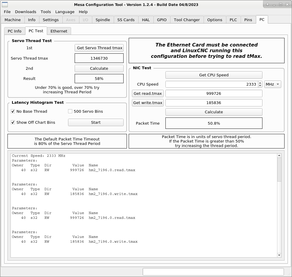

18 May 2023 14:53 #271613
by zz912
- Posts: 18103
18 May 2023 20:37 #271622
Note that the latest available RT kernel (6.3.1-rt23)
seems better for network latency than earlier kernels.
I have tested it for about a week on 3 systems and have had no
packet errors at 1 KHz and now have it running at 2 KHz on one of
my better (latency wise) systems.
