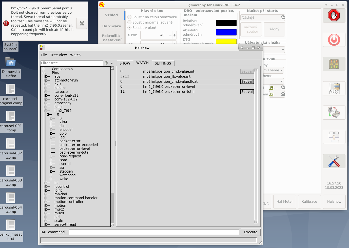

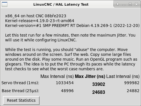

I would like to ask what these tests mean? Do I have a weak PC? Or is there a bug somewhere (LCNC, kernel, debian ....)?

try this commandas PCW said there is no need to look at the base thread as it is not used with a mesa card.
the histogram shows the jitter which is the time a thread is late or early. If there is too much jitter, the servo-thread will not get finished before the next one starts... which is a latency error...
latency-histogram --nobase --sbins 1000the histogram shows the jitter which is the time a thread is late or early. If there is too much jitter, the servo-thread will not get finished before the next one starts... which is a latency error...

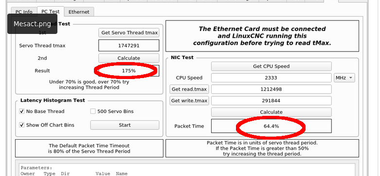

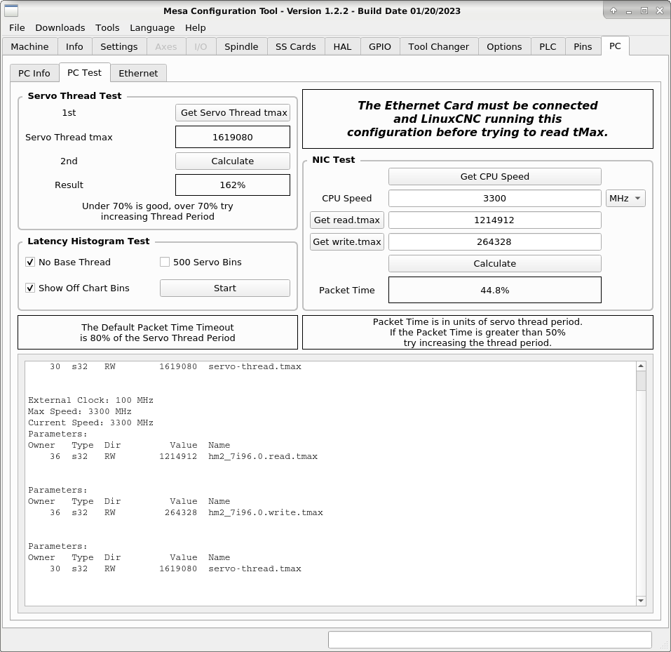

Replied by PCW on topic Optiplex 755
I think there is a bug in mesact
The servo thread tmax should show 75%
(100*1747291/2333333)
If you have disabled all power saving options in the CPU
and have Interrupt coalescing off you may have to run at a lower
servo thread rate on that PC (say 2 ms period instead of 1 ms)

I had 3 problems:
1) MesaCT - I'm going to assume it's wrong.
2) Latency message error - now I know, that it is BaseThread
3) SSerial error - Maybe turning off the AMT setup will help. I will keep an eye out to see if the error reappears.

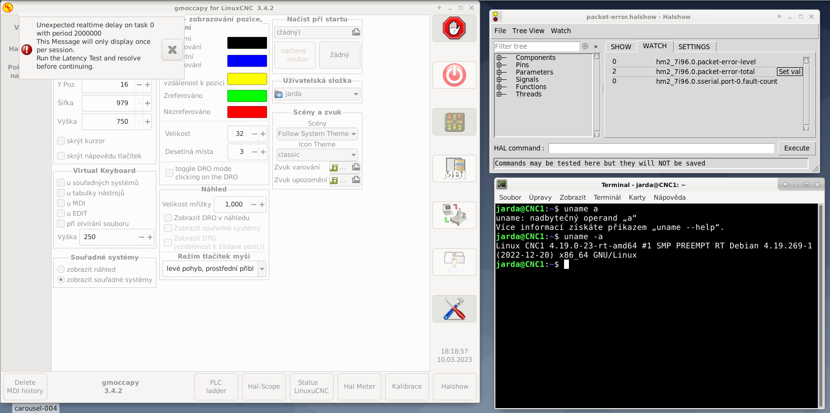

I would try a 2 ms servo thread period

2 ms did not help:
Mabey evengravy have solution:
forum.linuxcnc.org/38-general-linuxcnc-q...2-8-4-stretch#266292
It's strange that I had no problems yesterday.
