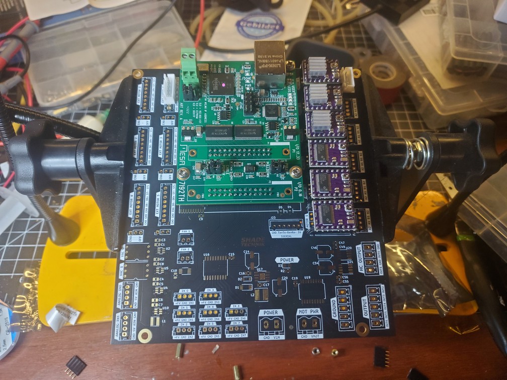

04 May 2023 18:29 #270659 by blazini36
Replied by blazini36 on topic Question about custom BOB for a 7i92
The pinout I uploaded was for the initial run of PCBs that I have on hand, I have to test that setup.
The inmux stuff is for a possible 2nd revision but it probably wouldn't be a good idea to run a 2nd revision without testing the first.
04 May 2023 18:52 #270663 by blazini36
This is the same pinout I posted before, it just changes the one spi address line to the frame pin as you suggested.
File Attachment:
File Name: 7i92_BoB_p...r1.0.txt
File Size:1 KB
04 May 2023 19:42 #270667 by PCW
Replied by PCW on topic Question about custom BOB for a 7i92
File Attachment:
File Name: 7i92_blazini1.zip
File Size:110 KB
I do hope your A-D SPI device can work without receiving SPI commands
04 May 2023 20:05 #270669 by blazini36
Thanks.
Using 4x ADC101S021, they don't have a data input.
Tried to pick something as basic as possible for the onboard analog inputs since they won't work anyway unless my friend delivers a component.
I can at least start configuring a hal file and all the rest for the stuff that should just work.
04 May 2023 20:31 #270670 by blazini36
Just out of curiosity, is it possible to order the 7i92TH without the IDC headers installed?
Desoldering the pins connected to planes is kind of tough since there's no thermal relief

09 May 2023 06:59 #270993 by blazini36
I just got a BoB assembled and went to flash the new firmware and realized it's for a Xilinx. This is a new Trion 7i92t so it's failing on mesaflash. Any chance I can get the Trion version?
I don't suppose the hm2 sources are still available? It looks like LinuxCNC archived the repo, I didn't see any 7i92 in there anyway. Looks like Eyefinity has a free license so I wouldn't mind taking a crack at it if I can figure it out. I've done it several times on a hm2 Altera port in MK but I think MK dumbed that whole thing down a bit, or maybe Quartus is just super easy to figure out.

19 May 2023 06:08 #271652 by blazini36
PCW, do you know of any documentation or hal examples for bspi?
All I found was some talk here and there about the 7i65. I'm trying to see if without having a hal component available yet if there is some way to verify that the 7i92 is grabbing data from the ADCs and maybe mess with the CS pins. Not sure if Andy is looking at this thread but it would be good to have some kind of guidance for my friend who is planning on writing the component.
Right now all I have is this in my hal file. I can't figure out what functions need to be added or if the functions are exposed by the component rather than the bspi driver. The BSPI pins do show up in the terminal when loading but that's about all I can see
