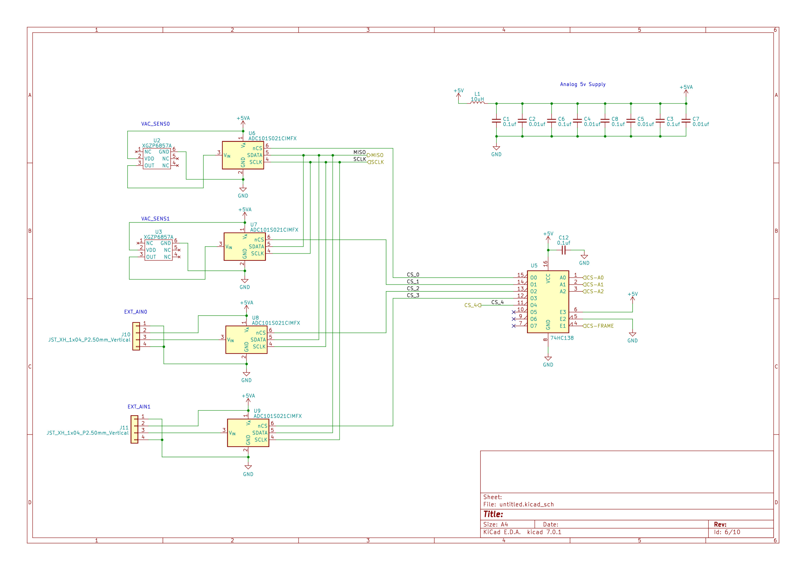

Nothing is muxed on the 7I96/7I96S
If this is done at high speeds could a variable delay be sufficient?
(a variable delay with 10 ns resolution can be done with the oneshot module)

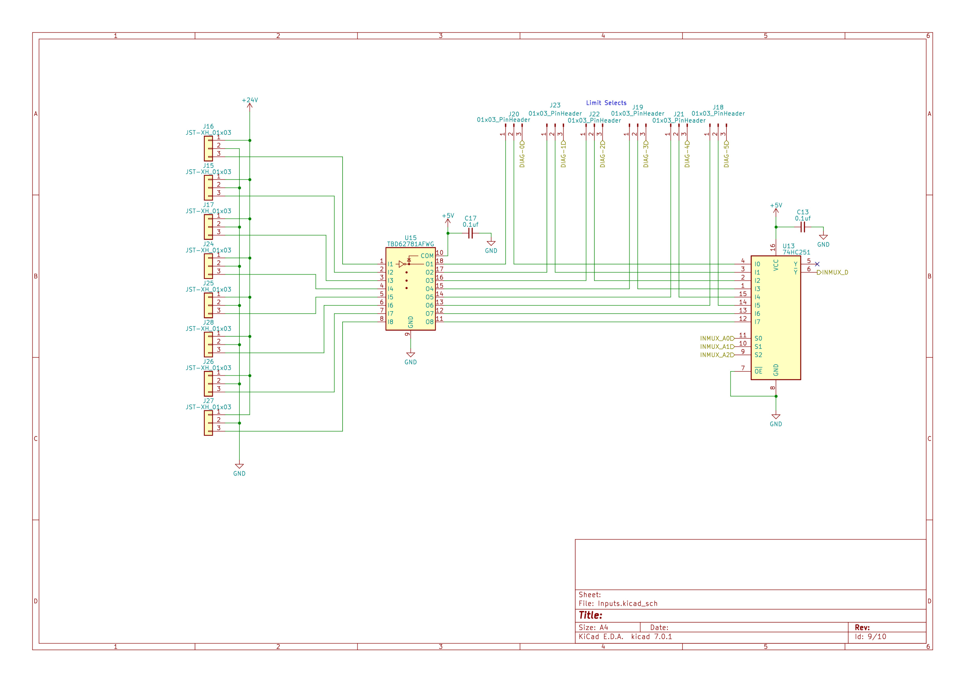

The 2nd revision looks about ready but I figured I should post the drawing of the SPI decoder and input multiplexer to make sure I didn't get anything wrong.
I wasn't able to do much with SPI on the first rev because of the missing component and that PCB mistake. One question I have is if the 7i92 IO is strong enough to drive the SCK for 5 devices on board with no buffer or anything? I dropped the external SPI port idea, it was getting a bit out of hand.
I have the 4 ADCs that only output so they don't use MOSI, and I added a small 8bit MCU as the stepper drives I'll be using need configuration over UART, that is connected to the 7i92's BSPI instance and is the only thing on MOSI. I think my friend has the gist of the bspi thing and configuring the MCU's EEPROM space will become hal parameters as part of this thing's component.
This is the pinout for hopefully what is the final firmware.
