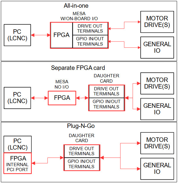

LONG VERSION
3- BACKGROUND
Linuxcnc was originally designed to connect the outside world to the computer via the PC’s parallel port. Over time, parallel ports have become less available on PC’s, and, perhaps more importantly, parallel ports are rather limited in both speed and the quantity of signals to/from external hardware they can handle. One solution to these problems is to use an interface card from Mesa Electronics instead of (or in addition to) the parallel port.
Mesa cards are not motion controllers, nor do they buffer commands from the PC as with Mach3 & ESS boards. At the risk of oversimplifying, Mesa cards are a 'system' of extremely capable and fast breakout boards for LCNC with onboard FPGA chips that take care of high-speed timing and signal management.
As a newcomer to LCNC, you probably do not need to know the exact details of how they work, but you do need to know what they can (and can’t) do, and how all the different connection options fit together with LCNC and your CNC machine’s hardware. The number of options available from Mesa can be daunting.
BASICS
To use Mesa ‘stuff’ with LCNC you will need, at minimum, an ‘FPGA’ card. FPGA cards can be thought of as the 'main' card as it is the FPGA chip which communicates with LCNC, passing all signals to/from the FPGA card's onboard IO or daughter board IO.
Depending on which FPGA card and external hardware you use, you may also need (or want) to connect one or more daughter cards to the FPGA card.
So the basic architecture looks like this:

ONBOARD IO
Some FPGA cards have onboard IO and/or drive outputs, and some don't. As an example, compare a 7i76EU with a 7i92TH. They are both FPGA main cards and both do approximately the same thing, but the 7i76EU has onboard IO connectors and the 7i92TH doesn’t
The onboard IO type is an ‘all-in-one’ arrangement with screw terminal connections for drives as well as analog & digital inputs and outputs. This type also has one (or two) expansion connectors for use with daughter cards.
The other type of FPGA card has no onboard drive/IO screw terminal connections, but it does have connectors for use with daughter cards. Examples of this type are the 7i80DB or 7i92TH.
Plug-N-Go kits are, essentially, a ‘no-onboard IO’ FPGA card coupled with an external drive and/or IO daughter card which has screw terminals.
As far as the novice LCNC user is concerned, there is no performance difference between an ‘all-in-one’ FPGA card and an equivalent no-IO FPGA card combined with suitable daughter card(s).
Which type of card to select is primarily dependent on which, if any, daughter cards are desired, as well as packaging/mounting restrictions. A very large ‘all-in-one’ card, such as a 7i95T, may be harder to fit in a tight enclosure than a 7i92TH with remote-mounted daughter cards.
On the other hand, if you have the space an all-in-one FPGA card can be tidy as there are no inter-card cables or multiple mounts to deal with.

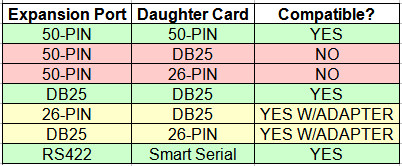

EXPANSION PORTS
FPGA cards can also be categorized by which expansion port type is used to connect daughter cards:
• 'All-in-one' FPGA cards have one or two 26-pin expansion connectors.
• No onboard IO FPGA cards may have
◦ Two (or more) 26-pin connectors, or
◦ Two (or more) DB25 connectors, or
◦ A combination of 26-pin and DB25, or
◦ Two (or more) 50-pin IDC connectors
The type of expansion port provided by an FPGA main card is very important to understand because while a DB25 daughter card can be adapted to a 26-pin FPGA port with a special cable, 50-pin daughter cards cannot be plugged in to DB25/26-pin connectors (and vice-versa).
Simplified, an FPGA’s expansion port(s) must be compatible with the daughter card(s) connection type.

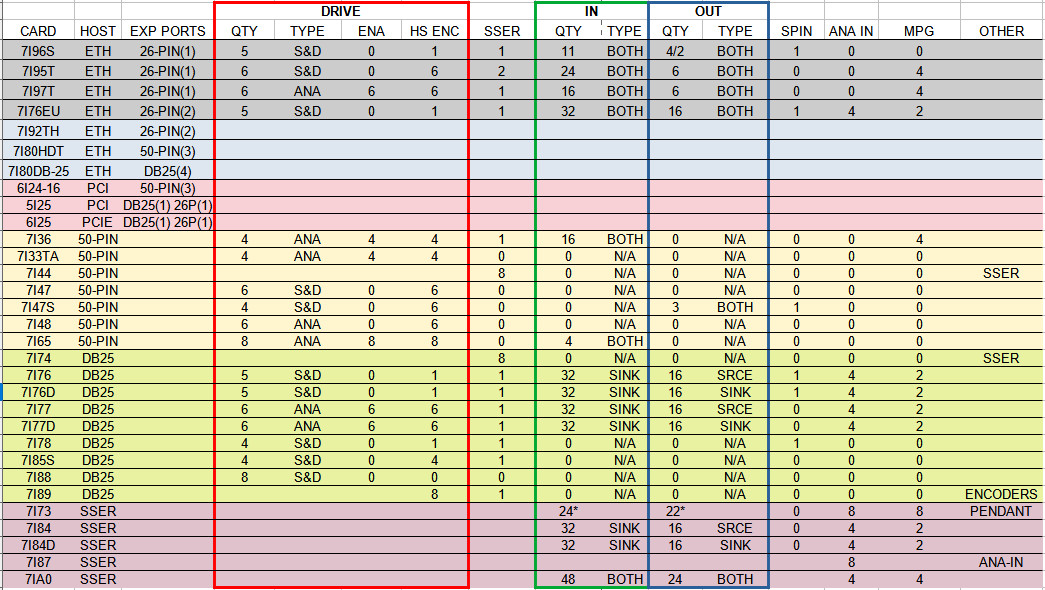

8 - PUTTING IT ALL TOGETHER
To review:
• Determine the host connection type, based on your computer
◦ Ethernet
◦ Plug-N-Go
◦ Direct plug-in (RPii)
• Determine your drive input signal type and quantity
◦ Step-dir or PWM
◦ Analog
• Determine your IO type & quantity requirements
◦ Digital in/out
◦ Analog in/out
◦ Sink/source (or both)
◦ Voltage level(s)
• Determine additional features, immediate or future
◦ FPGA expansion capability
◦ Encoder inputs
◦ Spindle control & feedback
• Determine physical mounting restrictions
◦ Do you have room for a 'big' board?
◦ Is your operator console remote from the main enclosure?
Having sorted out all of the above:
• Required - select an FPGA card
• Optional (depends on FPGA) - select compatible daughter card(s)
• Optional - select sserial daughter cards
• Recommended - double check that your intended cards will do what you want
◦ Count the number of drives supported, compare to your list
◦ Count the number & type of IO, compare to your list
◦ Count the expansion ports and see if you have enough ports to plug everything together
Below is a sample chart of common Mesa cards, reasonably accurate as of the thread posting date. Double check the values in the chart and use it to narrow down your selection(s).
EDIT 2024-07-30
"MPG" column refers to dedicated MPG inputs which are pre-configured for use with typical handwheel encoders. Even if a board shows "0" for MPG inputs in the table if there are enough free inputs a board & LCNC can usually be configured to accept low-speed A/B encoder inputs - it just may not be as easy as with those boards with dedicated MPG inputs.
Note that the dedicated MPG inputs can also be configured as standard inputs.
As with most things in LCNC, there are many ways to accomplish the same outcome.
