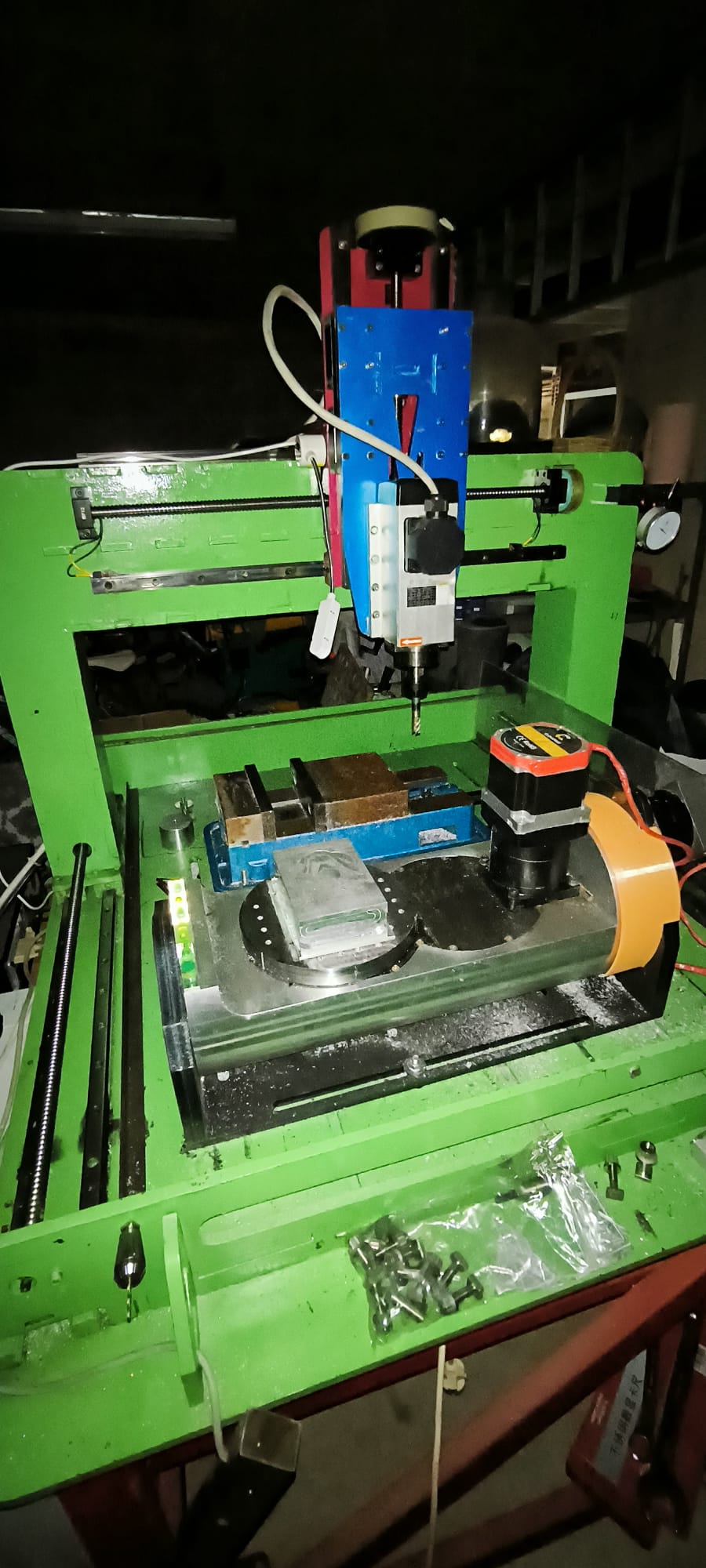

17 Aug 2024 09:02 #307995
by JackRay
Replied by JackRay on topic Which Mesa Card Should I Buy?
Hello everyone,
Thank you for this forum and the work accomplished. Knowing a little the possibilities of configuration of this software this update is for essential.
a few years ago I built a complete 5-axis continuous milling machine under linuxcnc.
It works very well with a // port and a STV2 “break out”, DMA860H drivers and a VFD. so I control :
- 5 continuous axes
- Spindle stop/run/speed ( G code )
However, not enough I/O for coolant and other functions.
The only drawback is that I'm “obviously” lacking precision with 5 continuous axes. I therefore need to install rotary encoders on my B/C axes. But there's no more possibility on my Break Out card. So I have to change my system completely.
I want to start with Raspberry Pi4 . Despite the tables above, I'm not sure about my choice of Mesa boards. What would you recommend for such a configuration?
Thank you in advance.

22 Aug 2024 15:30 #308406
by spumco
Replied by spumco on topic Which Mesa Card Should I Buy?
@JackRay,
Nice machine!
I'm sorry, but I've never used a Pi with Mesa or LCNC. I think your best bet is to do some searching in the "Computers" sub-forum, and post a new thread in there (or "Driver Boards") specifically seeking recommendations for Pi + Mesa combinations.
I suspect there isn't any difference in Mesa selection if you plan to use an ethernet cable (rather than the RPi-specific 7C80 or 7C81), but someone else should be able to provide more guidance.
