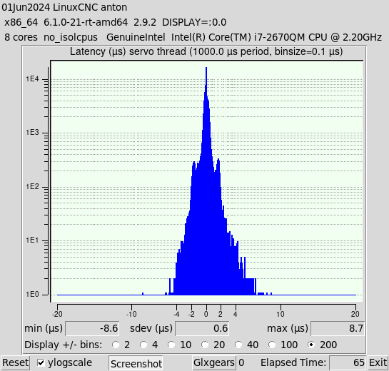

to 1) see histogram in the appendix

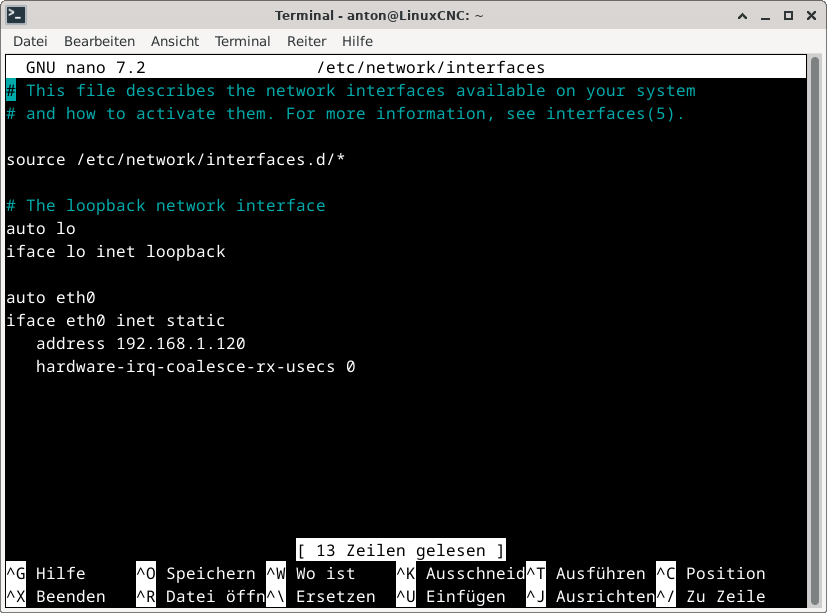

to 4) I have read hm2_eth. In the file /etc/network/interfaces there was only the loopback interface. I added eth0 there (see picture in the attachment). The entry is probably wrong because I don't have eth0. My interface is called enp5s0 !?

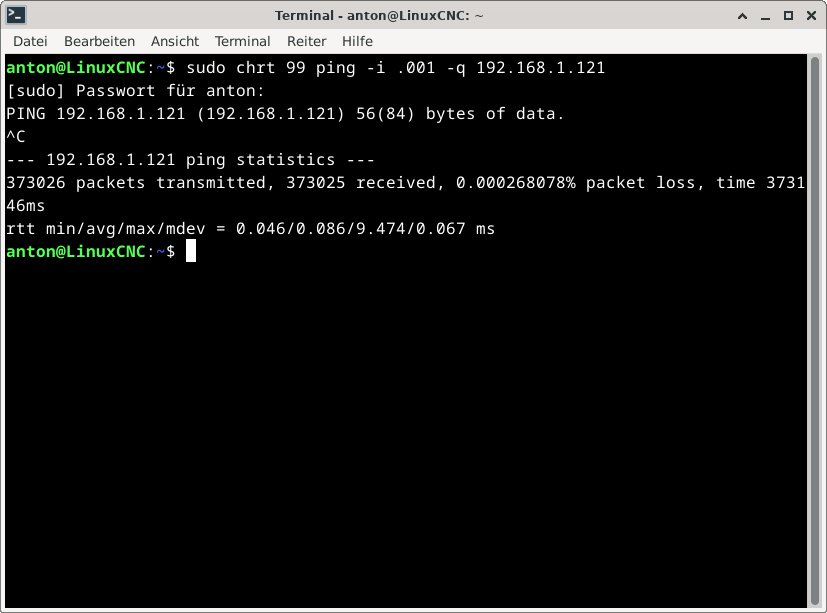

b) sudo chrt 99 ping -i .001 -q 10.10.10.10
(see picture in the appendix)
Best regards
I have gone through points 1 to 5.
to 5)
a) ping -i .2 -c 4 10.10.10.10
-> min: 0.093 avg: 0.135 max: 0.240
Best regards

The 9.4nS time is way to much, there is another topic with similar results, so can you try this:

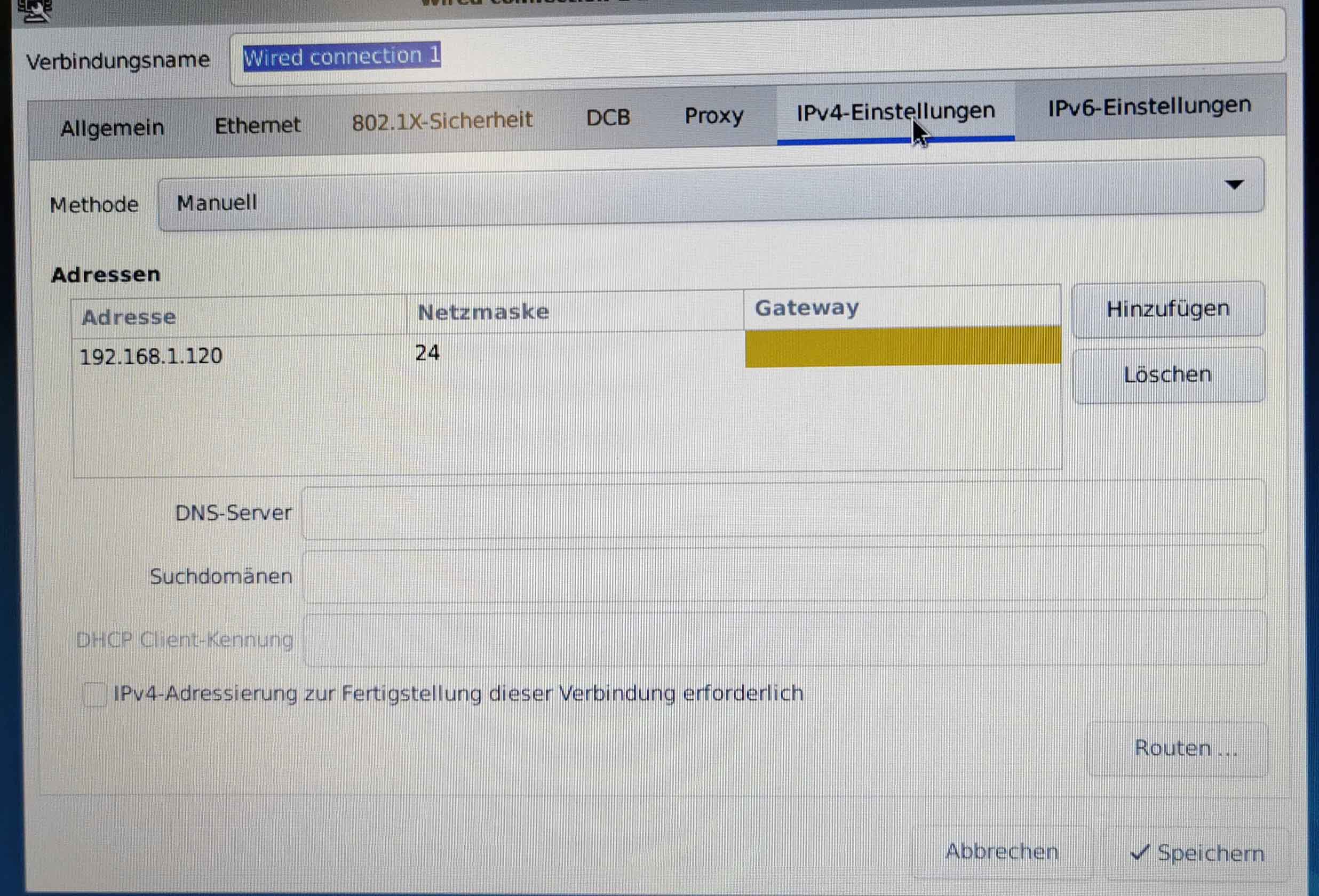

-click on "routen"
-check the "use this connection only for resources on this network"
-click OK
-click "save"
-close
-click on the network manager icon and click on "wired connection 1"
-pins as advised by PCW
-click on "routen"
-click OK
-click "save"
-close

Your fist screenshot above (with the correct address
) shows on the last line the min/avg/max/mdev values, the max value is above 9.4.
Please do this ping test again after all the above clicks and report back, it would be helpful if we can pinpoint what causes such high network latency.
