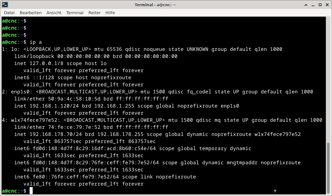

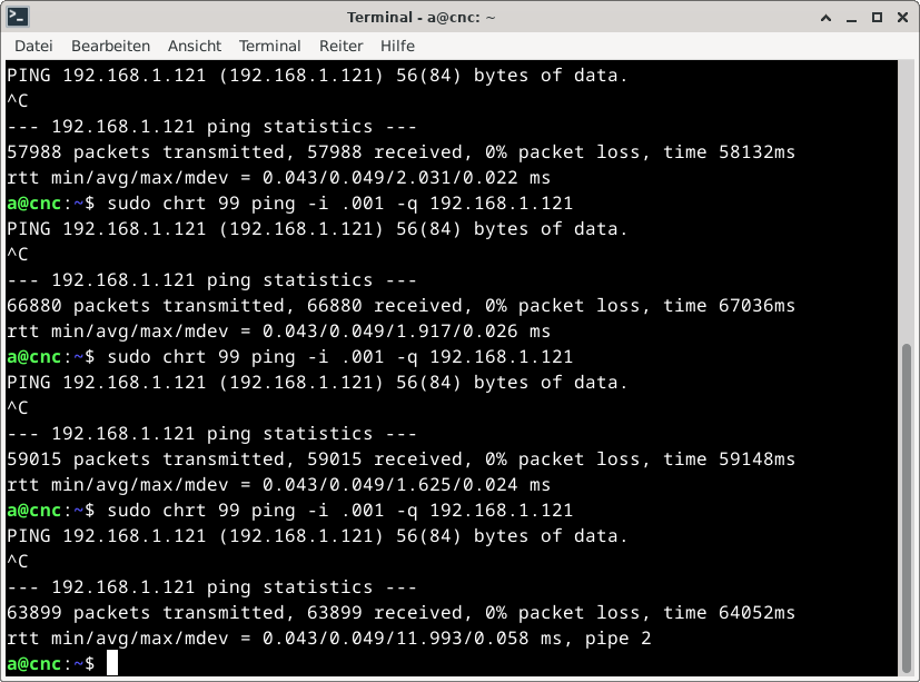

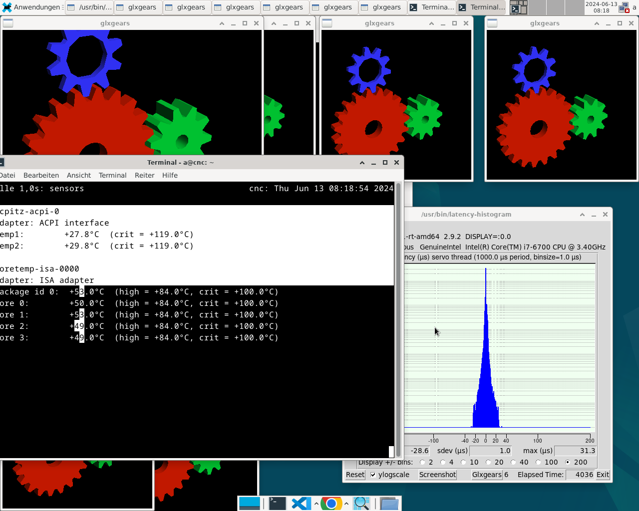

Hello,
I am now trying to get LinuxCNC to run stably on my fourth computer. It didn't work at all with the first two. The third and weakest one ran reasonably well but that was only a loaner.
The new one is now a Dell OptiPlex 3050 SFF with an i7. The histogram looks quite good +-30. Unfortunately, I'm having problems with the max ping times again (see attachment).
I have filmed the BIOS and network settings and you can see them here:
Are they OK or do I need to change something there?
PCW had written the following on page 1:
"If your PC has an Intel Ethernet chip make sure you disable IRQ coalescing
(man hm2_eth)"
However, my network card (enp1s0) is not listed in the networks file (see attachment). Where should I insert the entry described in man hm2_eth?
How can I determine whether the computer uses an Intel Ethernet chi at all?
Are there any other possibilities for the origin of the high ping times?
Could it also be due to the MESA card?

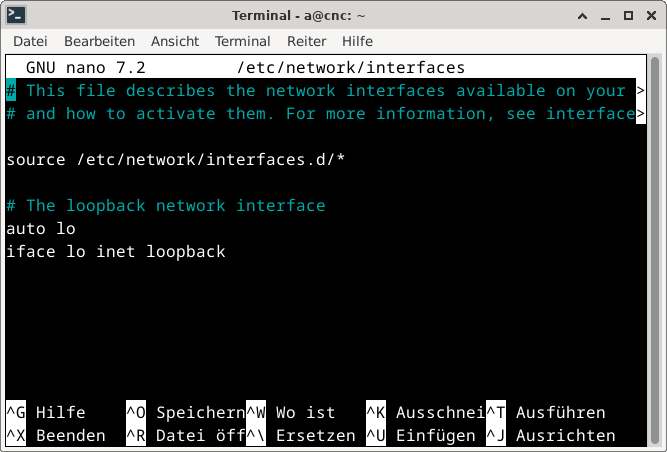

I would disable turbo-boost in the BIOS as anything that changes the CPU clock
can cause major latencies.
The interfaces file is an alternate way to setup a network connection.
to use it, you must add the required lines to the interfaces file, something like:
auto enp1s0
iface enp1s0 inet static
address 192.168.1.120/24
hardware-irq-coalesce-rx-usecs 0
The last line only makes sense if you have a Intel Ethernet chip
One way to check for this is:
dmesg | grep -i eth
(you may need sudo dmesg | grep -i eth on some systems
or
lspci | grep -i eth
Also check that you have ethtool installed with:
man ethtool
or the " hardware-irq-coalesce-rx-usecs 0" line will not do anything

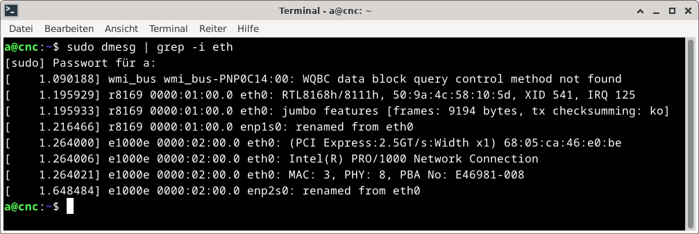

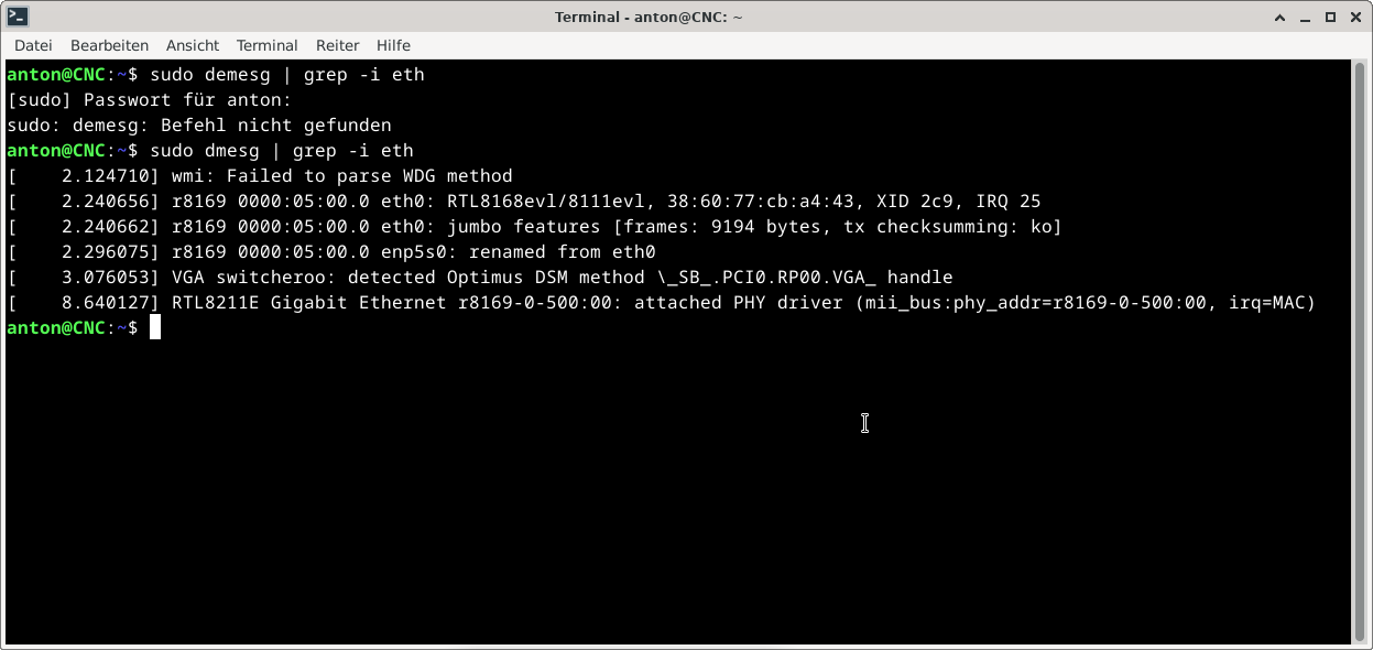

16 Jun 2024 20:18 - 17 Jun 2024 07:13 #303126
by Anton
Replied by Anton on topic error finishing read!
Attached is a screenshot of the output.
Realtek is the onboard NIC.
The Intel NIC works well and has a MAX ping of 0.36 after one hour.
This command
I have not yet tested this command for the new Intel NIC.
Apparently others have already had a problem with the driver!?
groups.google.com/g/linux.debian.kernel/c/HJQTXTdpBJo?pli=1
Addendum

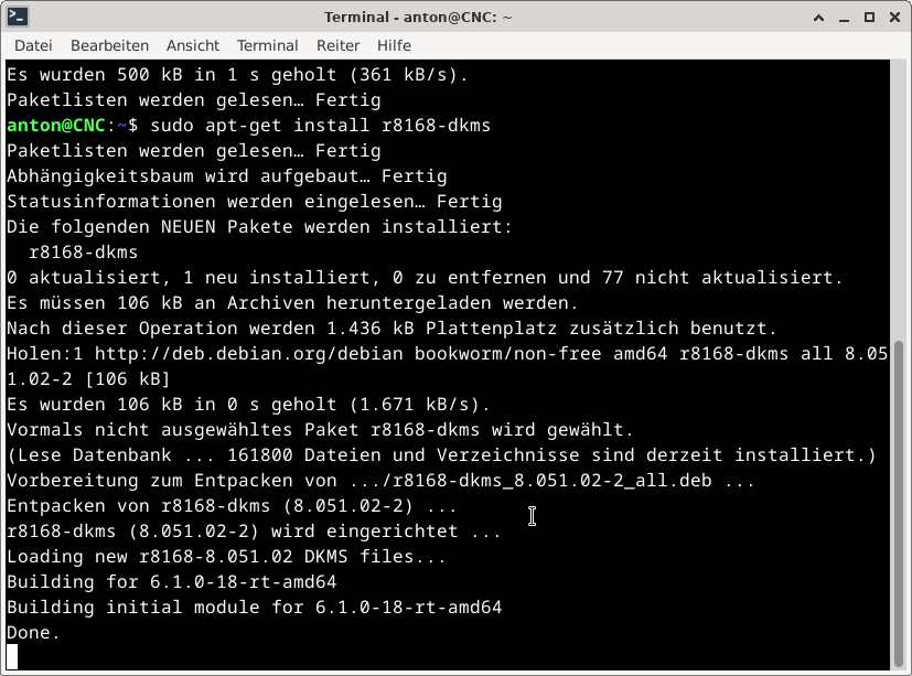

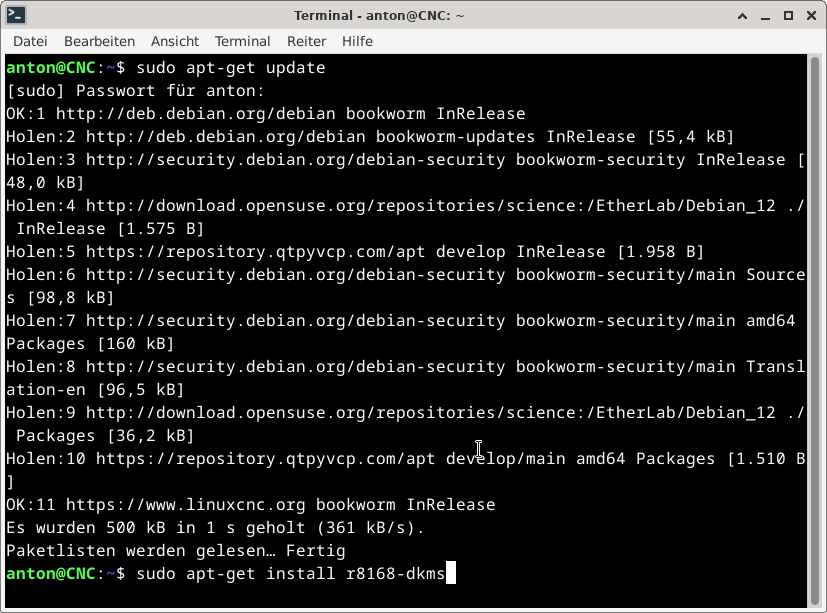

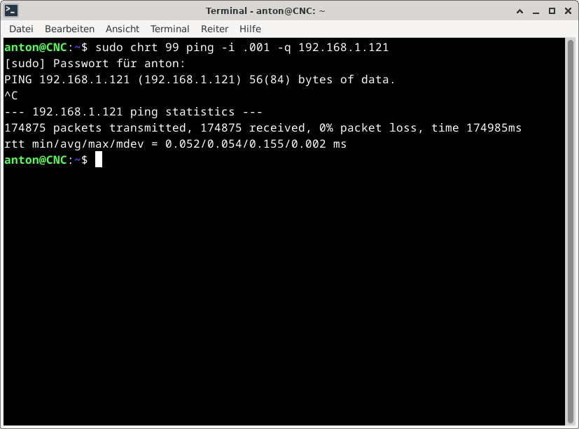

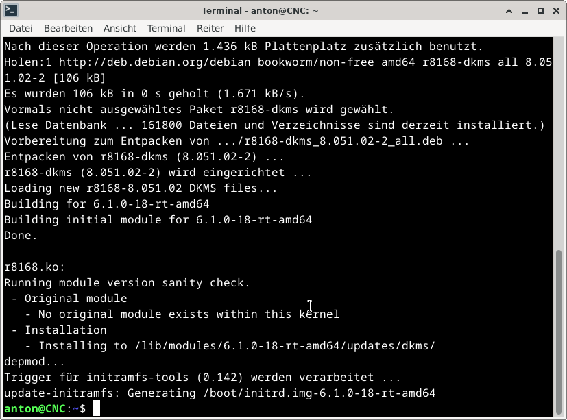

I have installed the driver mentioned here
(groups.google.com/g/linux.debian.kernel/c/HJQTXTdpBJo?pli=1)
on my laptop (see attachment) and was able to reduce the max ping time from 14ms to 0.155ms for long-term ping.
This one line
# sudo apt-get install r8168-dkms
would have saved me a lot of installation and configuration work.
Now LinuxCNC runs stable on my laptop.
This one line

I think in the end the fault lies with the Linux kernel as the R8168 is poorly supported by the R8169 kernel driver and the R8168 driver is not in the kernel. This is where DKMS comes in as it allows installation of kernel modules which are recompiled if you use another kernel (most of the time)
