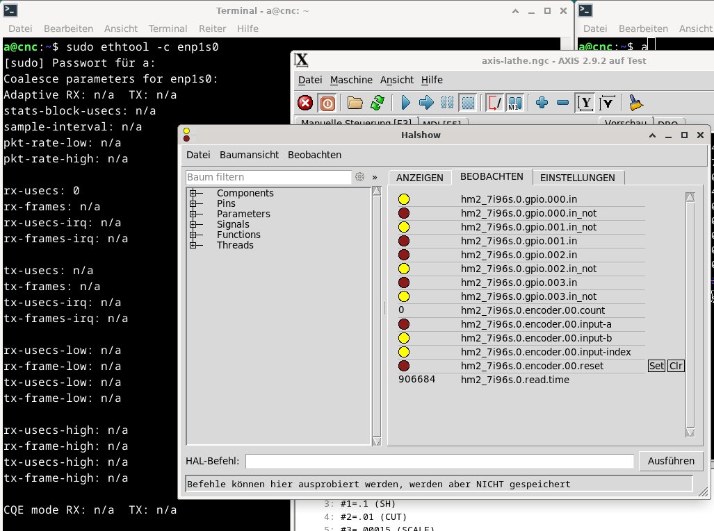

Hello,
if I enter the following
auto enp1s0
iface enp1s0 inet static
address 192.168.1.120/24
hardware-irq-coalesce-rx-usecs 0
in the file interfaces then the hm2.readTime deteriorates from 800000 to 900000. I have entered everything manually, it cannot be a character set (e.g. at -)
If I enter the following command.
sudo ethtool -C enp1s0 rx-usecs 0
Then ping and readTime (250000-400000) improve significantly.
Is there a possibility to use the command
automatically when starting LCNC?
If so, how?
perhaps with grub?
Greetings

The entry in the interfaces file should do it but unfortunately
you don't get an obvious warning message if there is a syntax
error in the interfaces file.
You might try:
ethtool -c enp1s0
To see if your interfaces file setting was actually run
You might try:
ethtool -c enp1s0

The file interfaces contains the following:
# This file describes the network interfaces available on your system
# and how to activate them. For more information, see interfaces(5).
source /etc/network/interfaces.d/*
# The loopback network interface
auto lo
iface lo inet loopback
auto enp1s0
The output of the command can be seen in the appendix.

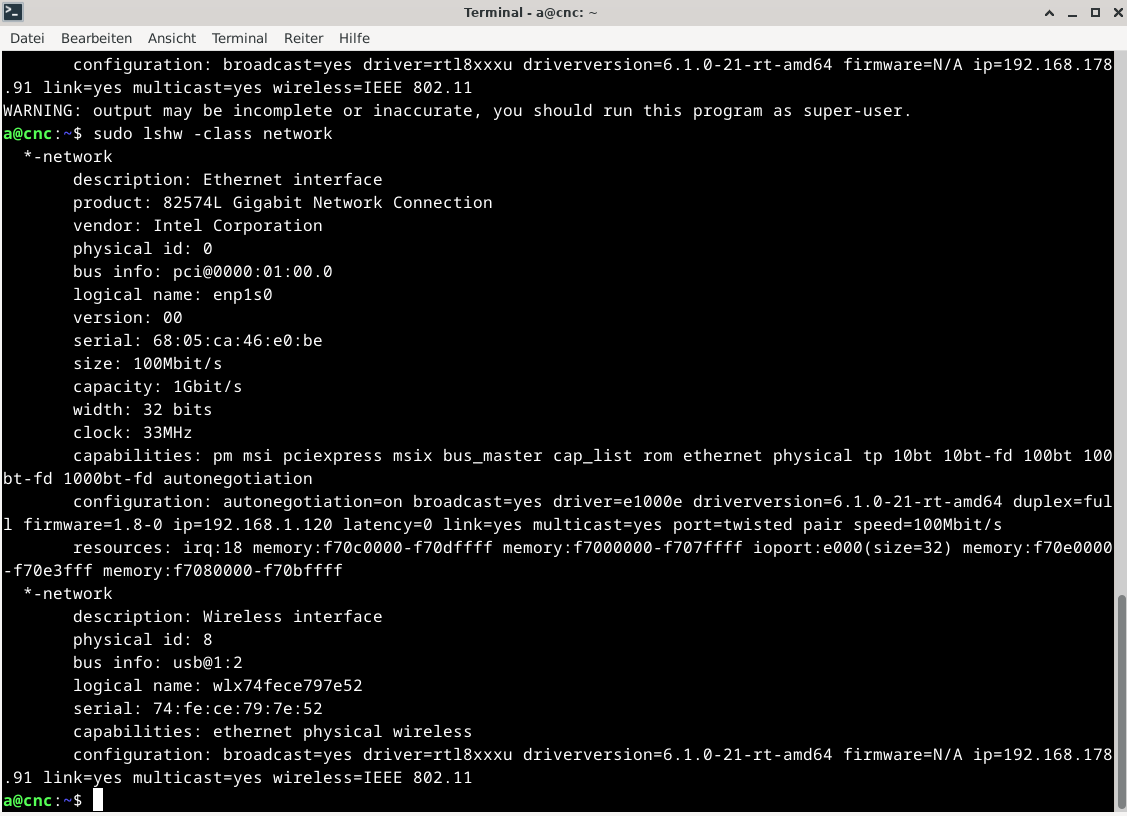

That's the output after rebooting without running ethtool -C?
What Ethernet hardware do you have?
lshw -class network
will show this.
You might check if there is any difference in the settings
from the interface file or manually
lshw -class network
will show this.

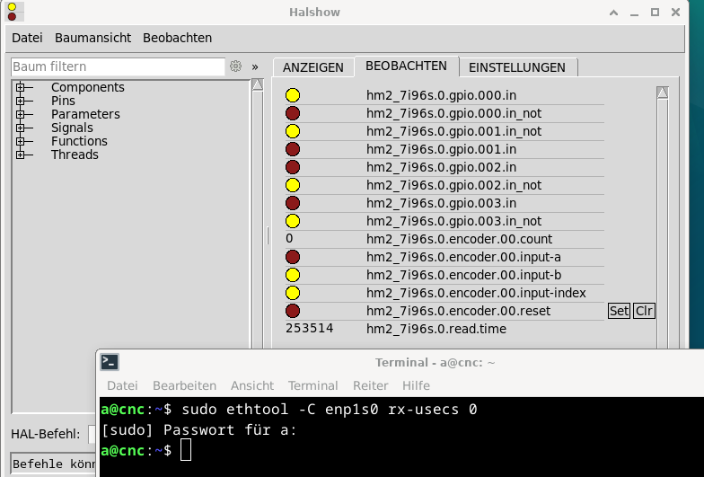

This is without the command:
If I do not comment out the lines in interfaces then the command does nothing.
If I comment out the lines, the command brings a big improvement.
lshw see attachment
The second picture in the appendix shows the good readTime. Here I have commented out the lines in the interfaces file and used the command
lshw see attachment

That's really weird, I have never seen that behaviour before
with Intel MACs.
You can run a program at linux startup by adding the command to rc.local
(simple) or using systemd (more complex)
with Intel MACs.

Hello Julian,
I had already commented out this line as a test, but that didn't help.
I now simply call the following line when starting via rc.local:
I leave it like that.
