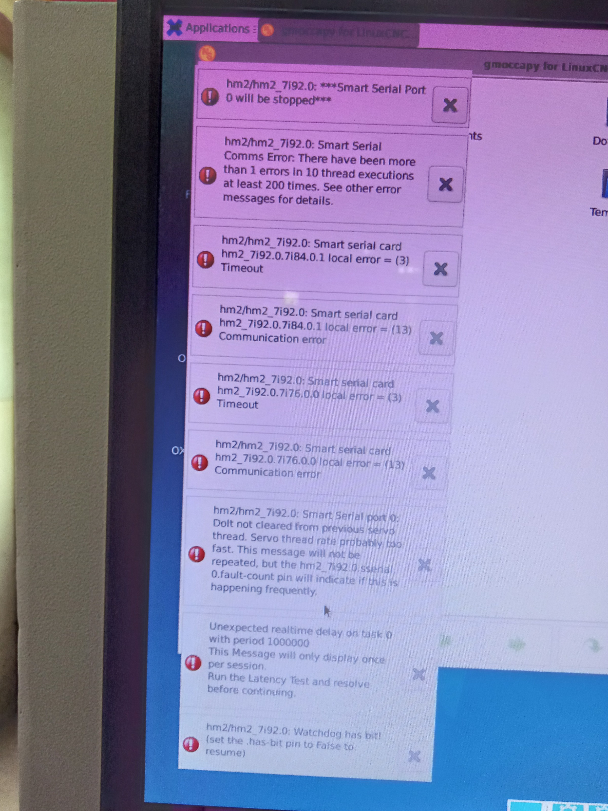

I am using Mesa 7i92+7i76+7i84.
Machine is under software set up stage, wiring completed.
I encountered the attached error in photo. The system runs ok, but it is 4 or 5th occasion the error occured.
What is happening wrong? Is it softw

The original error is a watchdog bite.
This means you have a latency issue
(or the watchdog timeout is set way too fast)
I would do a ping test:
ping -c 4 [card_ip_address]
sudo ping -c 30000 -i .001 -q [card_ip_address]
Where [card_ip_address] is the IP address of the 7I92 card
(probably 10.10.10.10 or 192.168.1.121)
The last command will take 30 seconds to complete

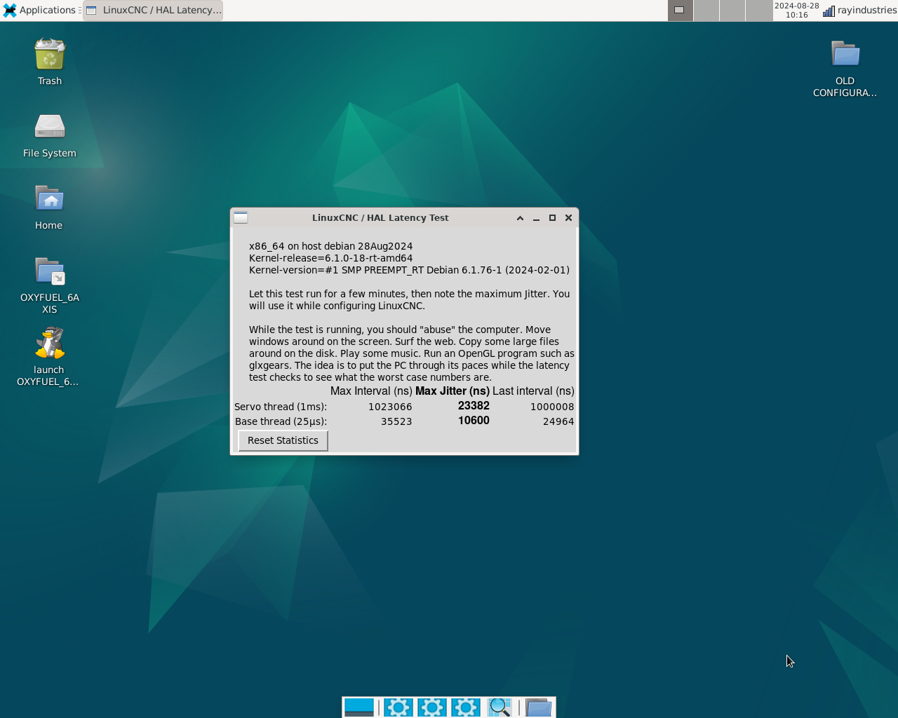

Latency test value screen shot attached, ran with 10 GLXgear and one 4k movie for 2 hour.
As I am noway an expert of these parameters, are they ok?
And one thing I noticed, the monitor goes blank sometimes for a moment, probably power issue. Now can such momentary power issue to CPU and MESA card create problem? Or could there be any issue with software download (and installation) as I had such issue before.

The latency and ping tests look fine.

Today I ran latency test for 2 hour almost, and shockingly Max jitter for both servo and base thread result found in order of 49,000,000 ns. Normally these values are in 20,000 ns~30,000 ns range.
What to do?

Sometimes failing hardware can cause weird bad latency spikes, such as a harddrive that is on it's last legs and is about to fail.
