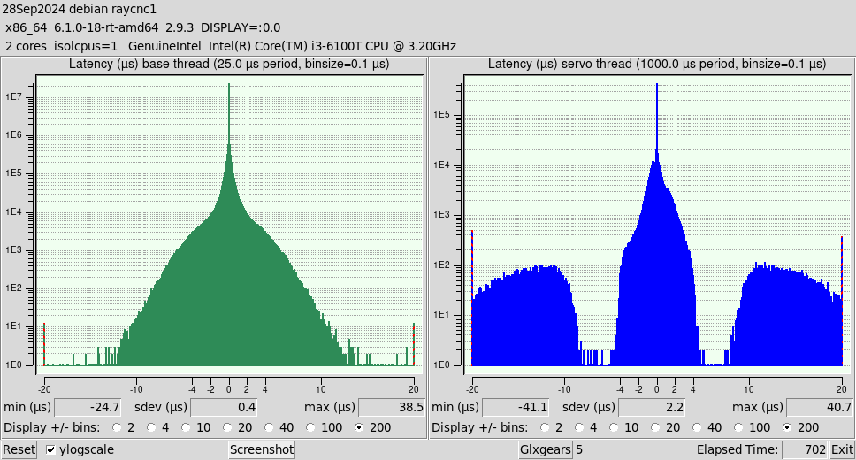

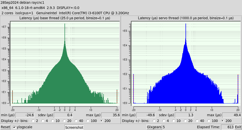

28 Sep 2024 03:21 - 28 Sep 2024 03:32 #310941
by rajsekhar
Replied by rajsekhar on topic Error while Running Linuxcnc
I added all power management option for r8168/pcie to grub, reboot.
After that the histogram run for 10 minutes.
Histogram attached. File name having 613.png (CPU=1 interrupt) and 704.png (CPU=0 interrupt).
There is clear difference.
Note: with CPU=1 interrupt, system running now for 30 min, hm2 read.tmax=1904389.
So IRQ affinity is must.

28 Sep 2024 09:52 #310955
Replied by tommylight on topic Error while Running Linuxcnc
Use this
latency-histogram --nobase --sbinsize 1000 --show
You have latency excursions outside the visible area on both screenshots, and IRC you do not need the base thread.

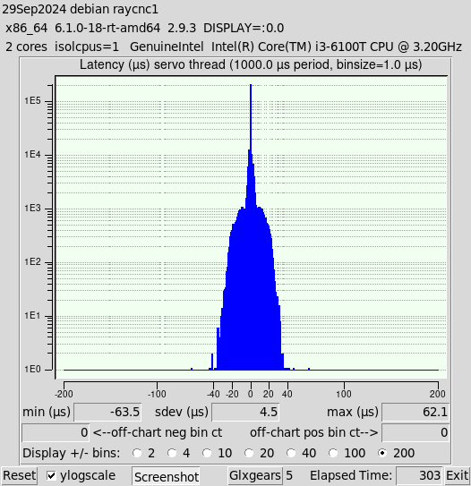

28 Sep 2024 14:53 #310981
by rajsekhar
Well I attached the histogram..I really donot understand it..is it acceptable for linuxcnc?
And one new issue arises. The computer getting restarted automatically while LCNC is running. I have noticed the monitor goes blank first and then system shuts down/ restarts. Any clue, why?
- Posts: 21887
- Thank you received: 7461
28 Sep 2024 15:16 #310984
Yes that is OK.

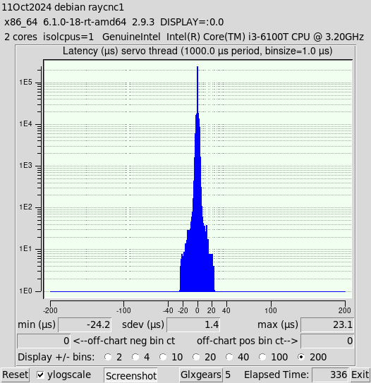

11 Oct 2024 08:30 #311799
by rajsekhar
Well I changed the power cables to repair the power issue, tested for 5 hour, running ok.
And I installed additional RAM in 2nd slot. It worked, at least I think so. A new histogram attached with two 8gb RAM.
But I could not do the IRQ affinity till date.
