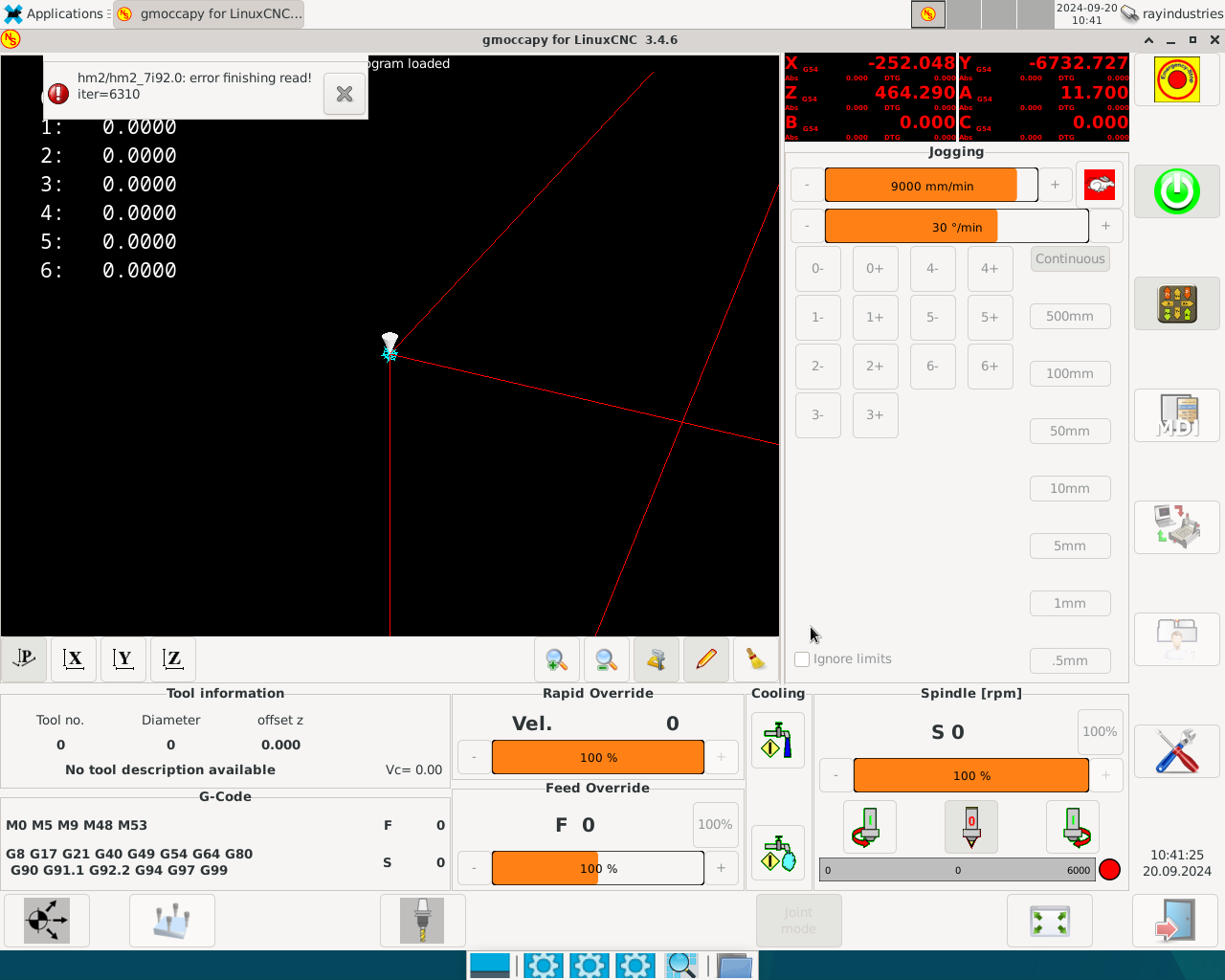

20 Sep 2024 05:21 #310489
by rajsekhar
Replied by rajsekhar on topic Error while Running Linuxcnc
Graphics card is added, not built-in. Without graphics card, max jitter comes in the range of 50,000ns~80,000ns.
And this morning I faced new error situation. Screen shot attached. It is reading error as message says. What exactly causes it? Machine inputs and outputs stops working with this error.

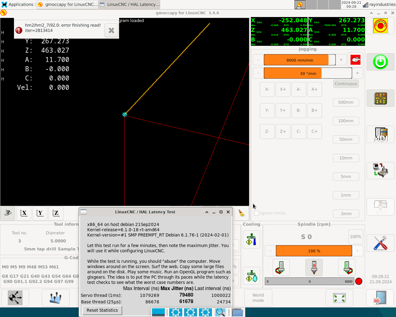

21 Sep 2024 04:11 #310527
by rajsekhar
Today I removed the graphics card and ran the machine.
Latency data in attached screen shot. Latency test and Linuxcnc run together.
I increased the servo period.
but "error finishing read" continues.
What to do?

- Posts: 18093
- Thank you received: 5325
21 Sep 2024 16:56 #310558
Replied by PCW on topic Error while Running Linuxcnc
Have you disabled all power saving in the BIOS? (C states >C1, any turbo mode etc)
What actual PC hardware are you using?
It may be that it is not suited to real time
(a 49 ms real time delay is fatal for any LinuxCNC installation running actual motion hardware)

21 Sep 2024 17:48 #310562
by rajsekhar
Bios power saving options already disabled. It is a dual core processor, isolcpus=1 set, latency max jitter comes 50,000ns to 85,000ns(as the graphics card already removed), ping test data already given in this topic earlier. What else to check?
One more question: I have a Raspberry pi4, 2GB ram in stock. Any better result expected with that?
