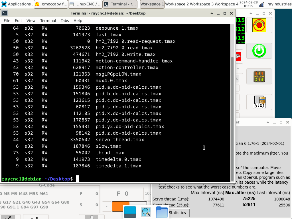

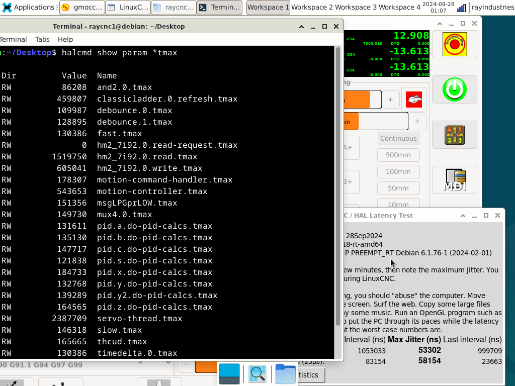

27 Sep 2024 15:16 #310895
by rajsekhar
Replied by rajsekhar on topic Error while Running Linuxcnc
No. error finishing read continues.
The result I posted in above last post is with IRQ in CPU1.
I have attached two screen shot with latency numbers and tmax values (linuxcnc and latency test run together). Please refer the file name for CPU number.
I noticed that while it was running (i.e before read error occured), the tmax values were similar, bur with IRQ to CPU0, network-latency spikes appear and causes read error.
So, IRQ affinity is a must.
