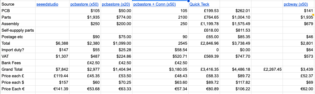

07 Sep 2024 09:40 #309551
I haven't looked at the BoM of this new version, and my order was prior to the chip famine.
Replied by andypugh on topic New update on STMBL
I had a batch of 50 of the previous (v4) design assembled in China (by PCBAstore.com) and was able to sell the kits (including machined heatsink, fasteners and a laser-cut case) for £88. The assembled PCB came in at £49.50. This was selling at cost.Difficult to say, depends on location, quantities and many other factors, but I would say below 200$.

I build 5 stmbls last Year. Something around 250,- Euro each. So not really cheap. I uesed original phoenix contact plugs for example.
Julian
Julian

Replied by juliankoenig87 on topic New update on STMBL
Yes. Unfortunetly you can not compare the prices the last years. Also the stms were really expensive... But I am happy so far. I have 24 IRAMs in total in my stock. So I will try to build the old design in the future.
Julian
