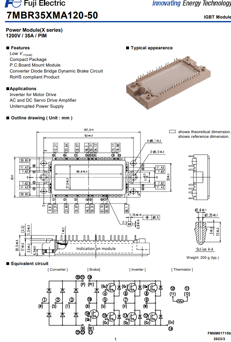

Answering the cost concerns, the prices andy shared unfortunately are not realistic now. Up to now I spend 190-200€ for each board.
I can drive 3.5-4.0W servo (the ABB arm are 4.5W) with the v5, the main problem I'm facing is the need for a proper rectifier with a decent power factor, we are working in developing one with pfc, brake resistor and maybe also bidirectional.
Going 600vdc open to 3phase rectifier and I think less capable of handling high currents for lower voltage motors. Then we should keep two different versions of the board.
Btw I think is not much difficult to make it 600v compliant, more clearance, the isolator (SI8621) should be fine, change the cap, recalculate the resistor voltage div, change the connectors...
Who knows if is possible to use these boards in a industry plant? Is possible to certify a machine using these boards? (CE for example here in Europe)

What igbt module for 600vdc?
For 600vdc there are plenty cheap rectifiers..
400vac is 564vdc rectified.

Here you can see some from ST: www.st.com/en/power-modules-and-ipm/stpo...lligent-modules.html. The v5 is the middle category in terms of servo motor power.
Look in the HP category.
To which rectifiers are you referring? Ready to use boards or simple diode module? I know there are several architectures for rectifiers.

for higher power 600V, something like
Onsemi NFVA25012NP2T might make sense

Thank you for sharing your insights, RDA. I've read about the certification process but have never actually gone through it myself. It doesn't make sense to certify a driver for just one machine, but in the future, if a design proves successful and gains popularity, certification could potentially be beneficial.
Regarding the candidate power modules, designing a driver for a discrete IGBT can be a challenging task. In the past, I've encountered issues with parasitic capacitance from a similar module attached above, which led to the destruction of a Siemens servo driver that I was working on. The integrated solution provided by these power modules really simplifies the design process in my opinion. However, it's worth noting that including rectification diodes in an integrated solution may be redundant for a modular array used in robot control, as the drivers in such an arrangement typically only contain the inverter stage and not the rectification stage.
The Onsemi NFVA25012NP2T is a good option to consider for designing a prototype.
