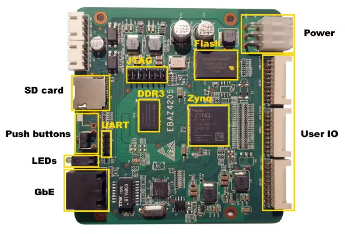

Hi All,
i can see there are many different FPGA boards has been adopted for LinuxCNC but for some reason no one is using this one (or similar) - EBAZ4205
This is Xilinx Zynq 7010 fpga pcb mass produced for crypto mining which makes them very cheap (under 20usd) and readily available (even at amazon).
Looks like it has all that is needed - 2 cores, decent fpga fabric, accessible jtag, uart, sdcard, 100mb Ethernet, lots of IO pins and even schematics are available:
github.com/xjtuecho/EBAZ4205/blob/master...205/EBAZ4205-SCH.pdf
any ideas why it has not been adopted for CNC?
for a commercial work i would still most probably prefer MESA due to its quality and support, but for cheap home automation it looks like much better fit than LED control cards or STM32 boards.

Any ideas ? No one has bothered.
Might be supported by the Litex infrastructure. The ethernet chip of that board is different to the one Mesa uses, so a driver would be at least one of the tasks.
Plenty of Spartan 6 Dev boards that are easier to use Hostmot2 (mesa fpga firmware sources) firmware with. I've had success with 7c81 setup, both SPI & SPP (parallel port) interfaces. Now experimenting with Ethernet.
Ok once you have the firmware going, the next step is designing & building the I\O, translation from 3.3v to 5v and then whatever your field voltage maybe.
At the end of the day it's just a little under what a Mesa board may cost, unless of course you're Down Under and shipping can almost double the cost of a 7i92.

all valid points. I have Mesa myself. I was just going through a number of threads here converting other boards like colorlight, nvem, even stm32 some of which require a lot of work and pcb mods and yet here is a board that you can get cheaper with more power, all peripherals, jtag ready, full xilinx support and no interest at all. btw this is just one of many, there are other boards from Ebang Ebits like ebaz4303, ebaz4332, ebaz4051 which are very similar.
i thought may be there is something wrong with it as i am not a fpga guru myself I am thinking about ordering one just to learn a bit more about fpga toolchain, looks like great learning platform.
I don't think you need Litex for Zynq as it has all those modules cpu cores, ethernet, ram, rom hard wired in the chip plus fairly large fpga part to build anything else like steppers or encoders.
PS. i am actually even further down under in New Zealand i use parcel forwarding companies from US so it is not too bad, just the shipping

but first, check if the free version of Xilinx toolchain can create bitfiles for it

so I can at least create a bitfile for flashing LEDs, but I don't know if it works:

the part is very tricky, at the moment i can't tell if it works and the ARM cores on it want extra love but i don't know how to configure them.
Ethernet won't work for now either, so if it does then only SPI and maybe later a bridge via the ARM cores.
