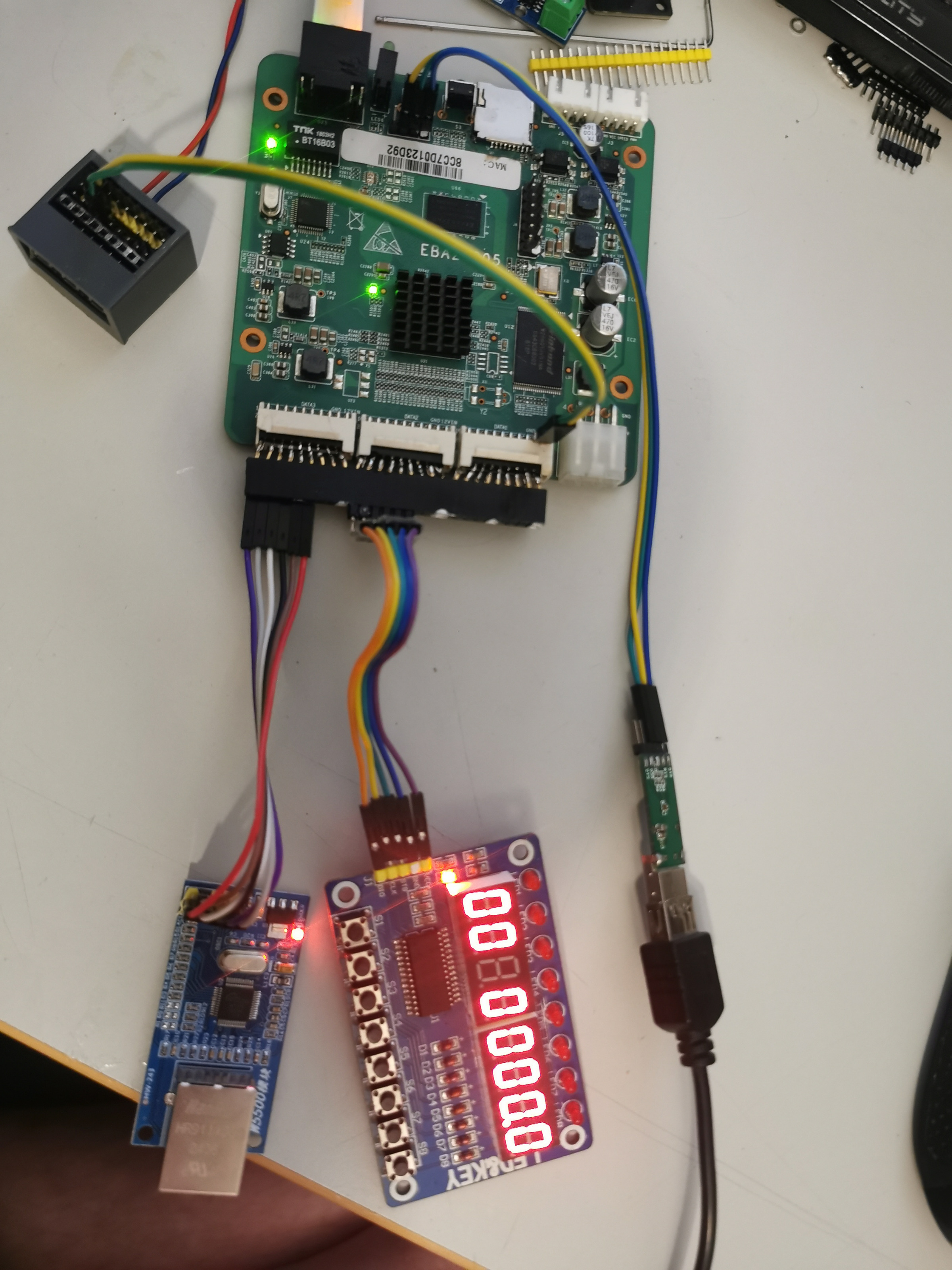

Interface between ARM-Core and FPGA-Part works, using AXI.
next step: udp2axi program for the ARM-Core

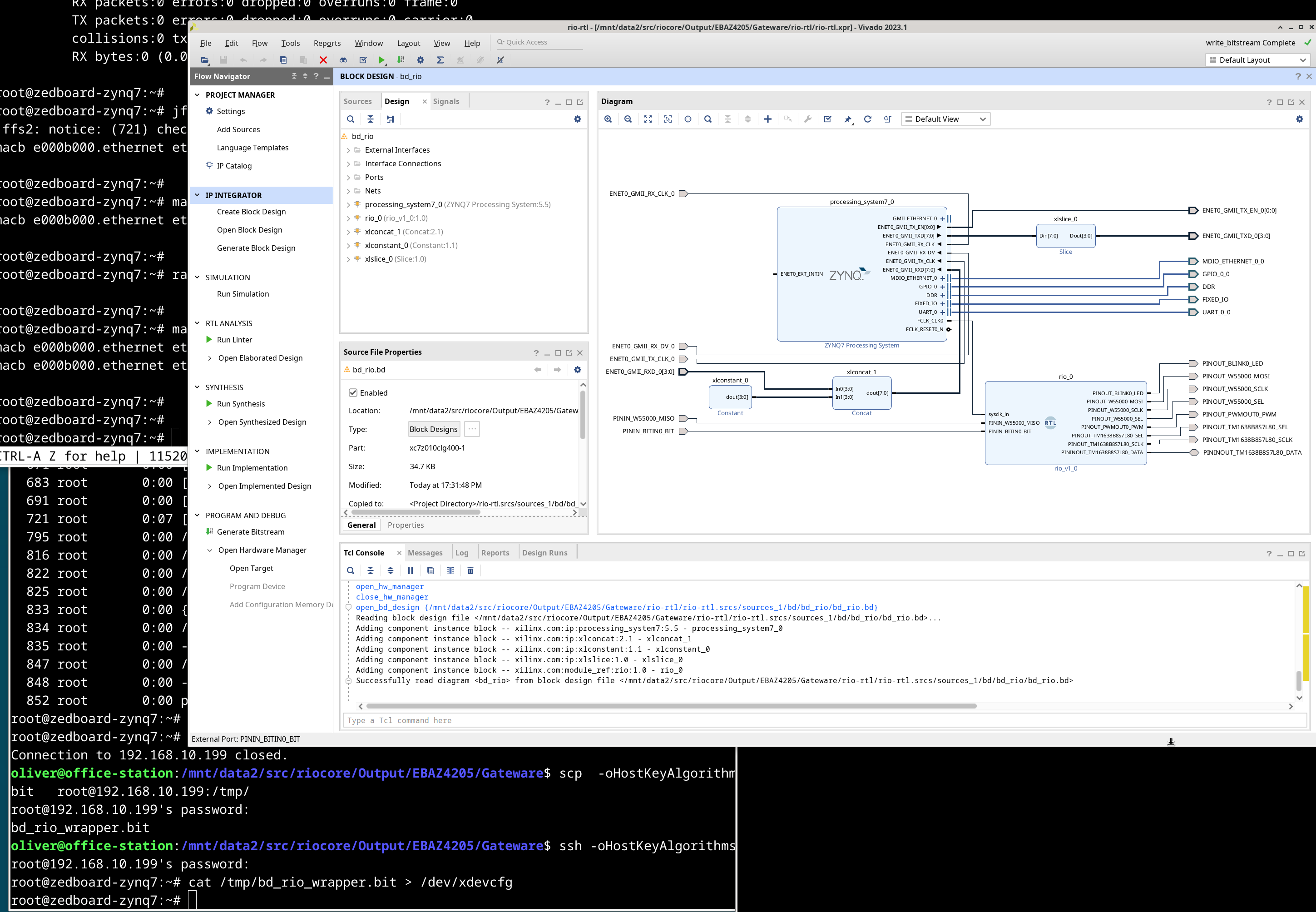

just a playful child
the platform (zynq/vivado) is actually quite cool and if i hadn't approached it like the other fpga's, it would have been much easier.
if a linux is already on it, you only need a usb-serial adapter and you can configure the network.
the bitfile can then be copied and started via scp/ssh.
The downside of these things is that vivado is very slow and the FPGAs are very expensive when new.
and you should have 100gb of space on your disk
