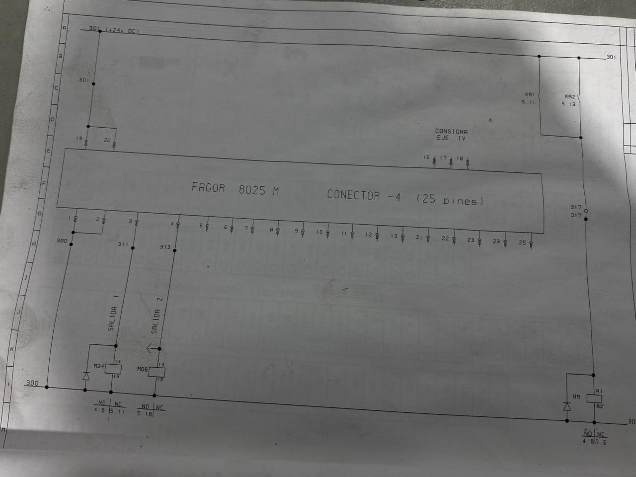

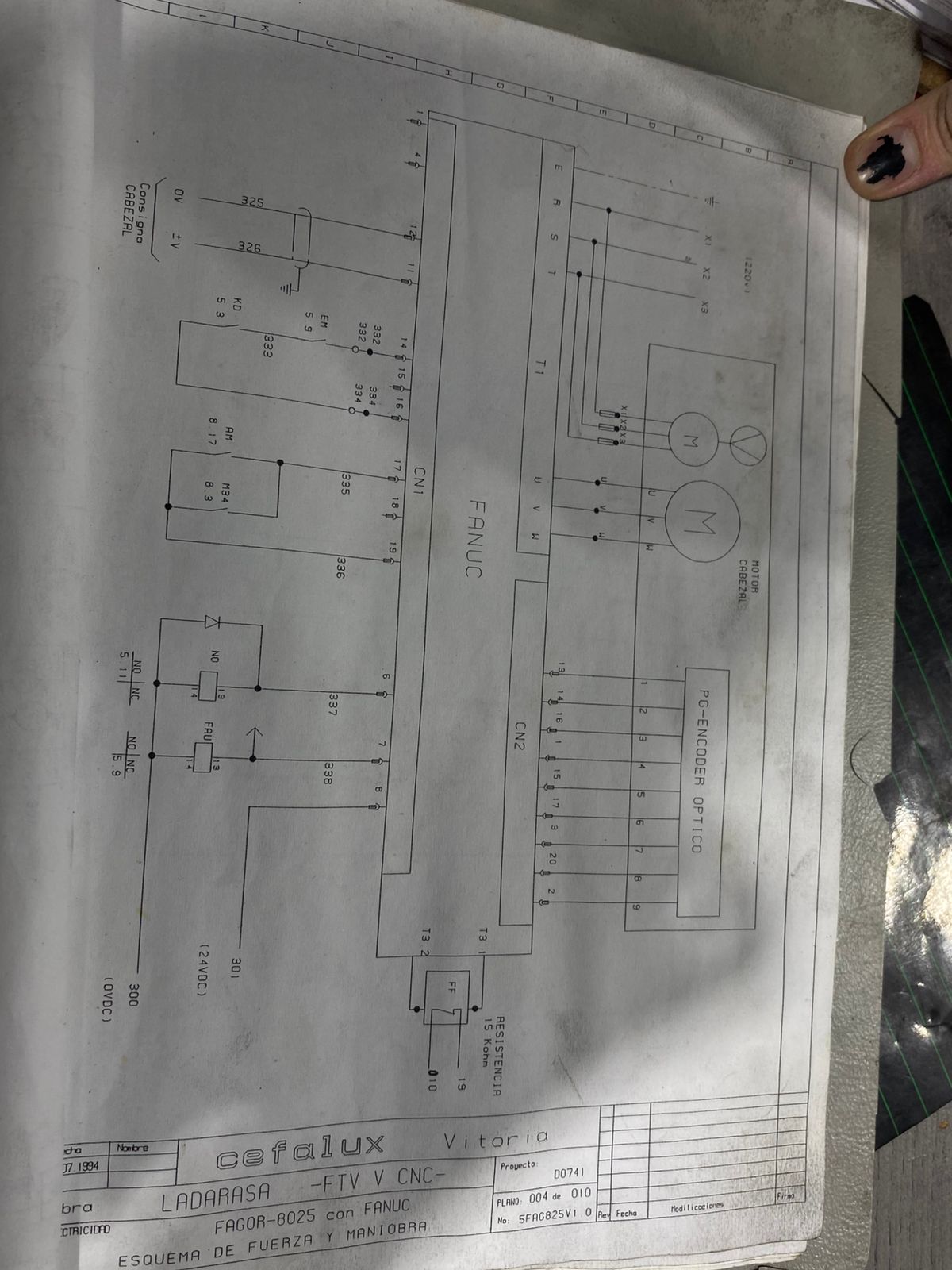

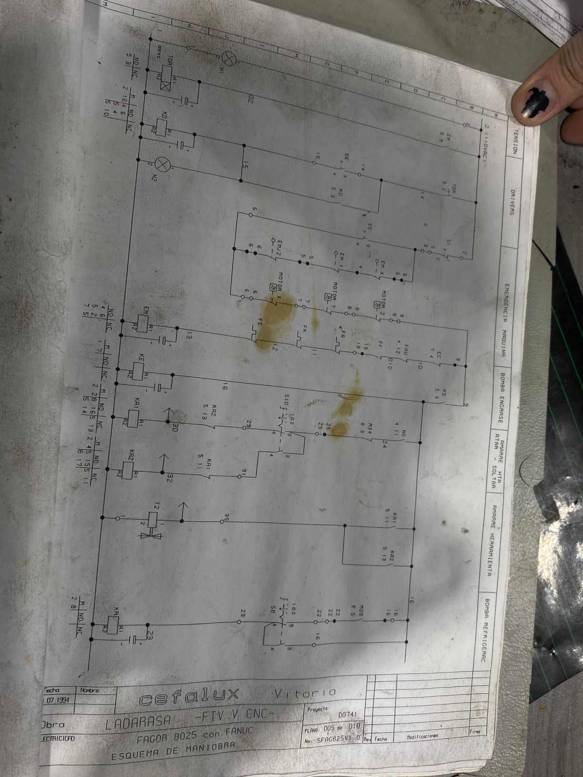

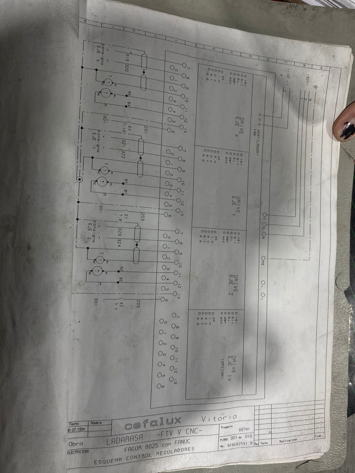

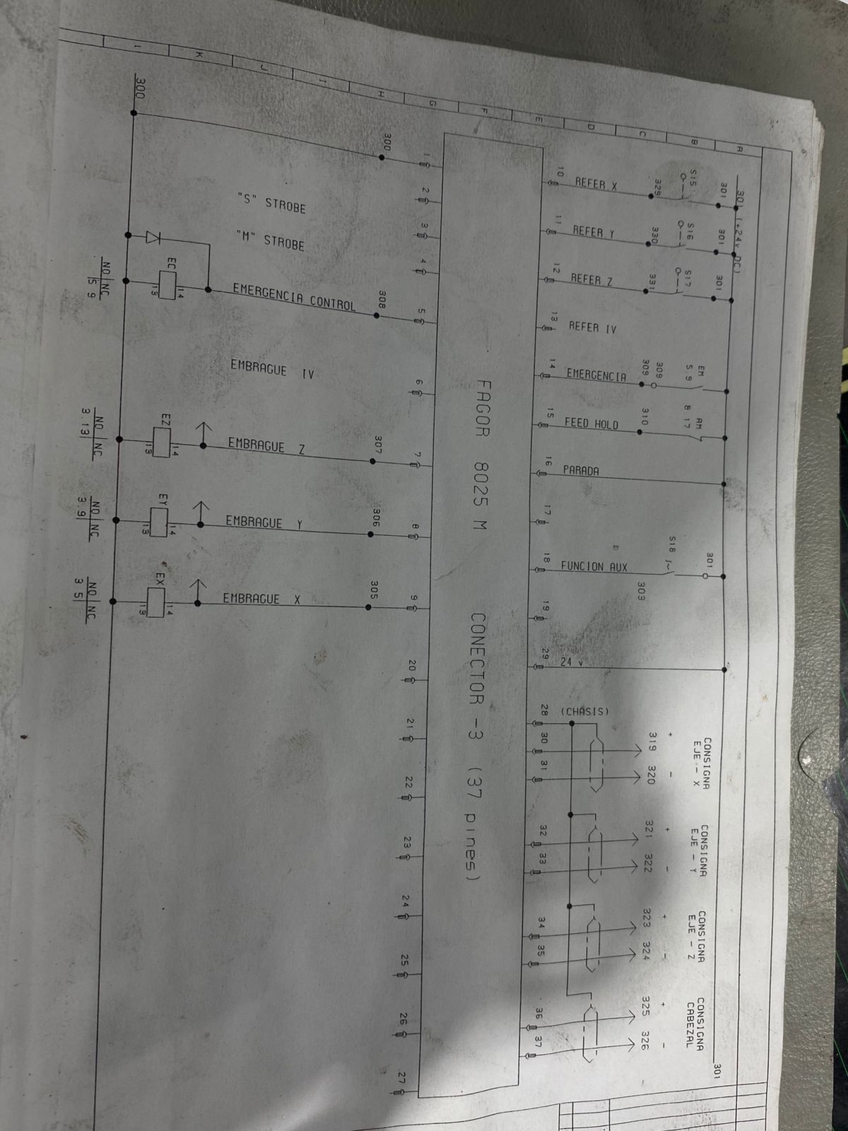

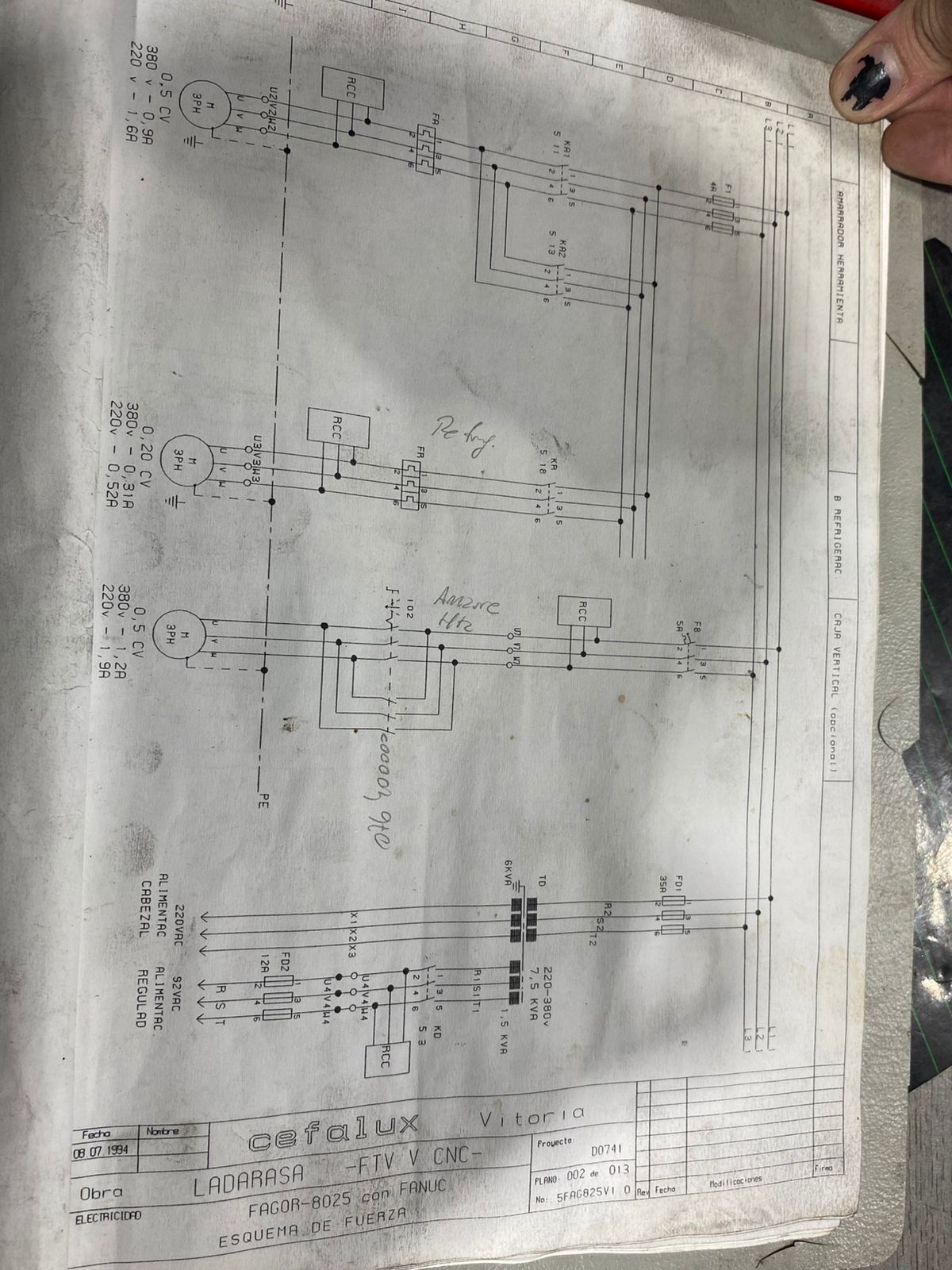

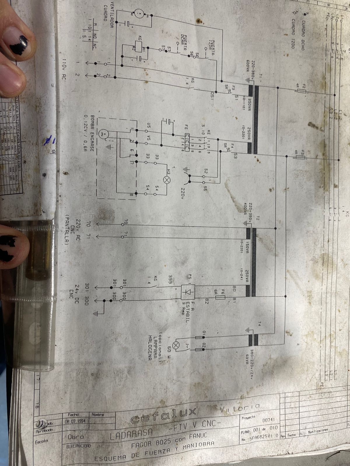

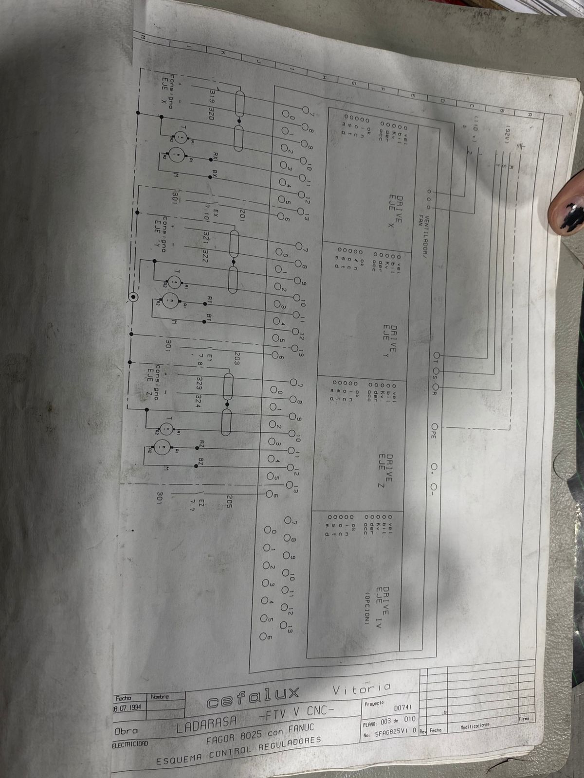

Hi everyone, I hope you’re doing well.
While going through the electrical diagrams of my machine, I noticed something I don’t fully understand. The schematics show a clutch on each axis. Could someone explain what exactly this means and what role the clutch plays? Is it connecting or disconnecting the motor from the ballscrew, or something else?
I’ll attach the diagrams for reference.
The spindle part I’ve already figured out, since I found out how the connections and control signals are set up. Right now, I’m working on counting all the inputs I will need to make sure the Mesa board I choose has enough capacity. Fortunately, the linear scales output 5V signals, so that part looks straightforward too.
Thanks a lot in advance — I’d really appreciate your input and experience on this.
- Posts: 22026
- Thank you received: 7501
25 Aug 2025 15:24 #333909
Replied by tommylight on topic Retrofitting a 3-axis VMC with DC servos - guidance needed
Maybe brakes? Do the motors have brakes on them?
The brakes on motors work as a clutch, meaning a friction plate pressed by a metal plate with a spring when braked and an electromagnet to pull the metal part away from the friction plate when released.
Electromagnets are usually shown the same in schematics as relays, they are after all the same wounded wire.
The following user(s) said Thank You: Japoo_Ness
- Japoo_Ness
- Posts: 36
29 Aug 2025 14:39 #334091
by Japoo_Ness
Replied by Japoo_Ness on topic Retrofitting a 3-axis VMC with DC servos - guidance needed
Yes, I think you’re right. I haven’t been able to check the machine again yet since it’s not mine – I’m just trying to help out a friend – but it probably does have a brake, considering the previous controller was only 2.5 axes.
Now, what I’d like to ask for some advice on: if I want to keep the option of adding more expansions in the future and also a control pendant, would the 7i74 be a good choice? I see that it’s mentioned as a supported configuration in the 6i25 manual, so it seems like it could give me more I/O and flexibility.
