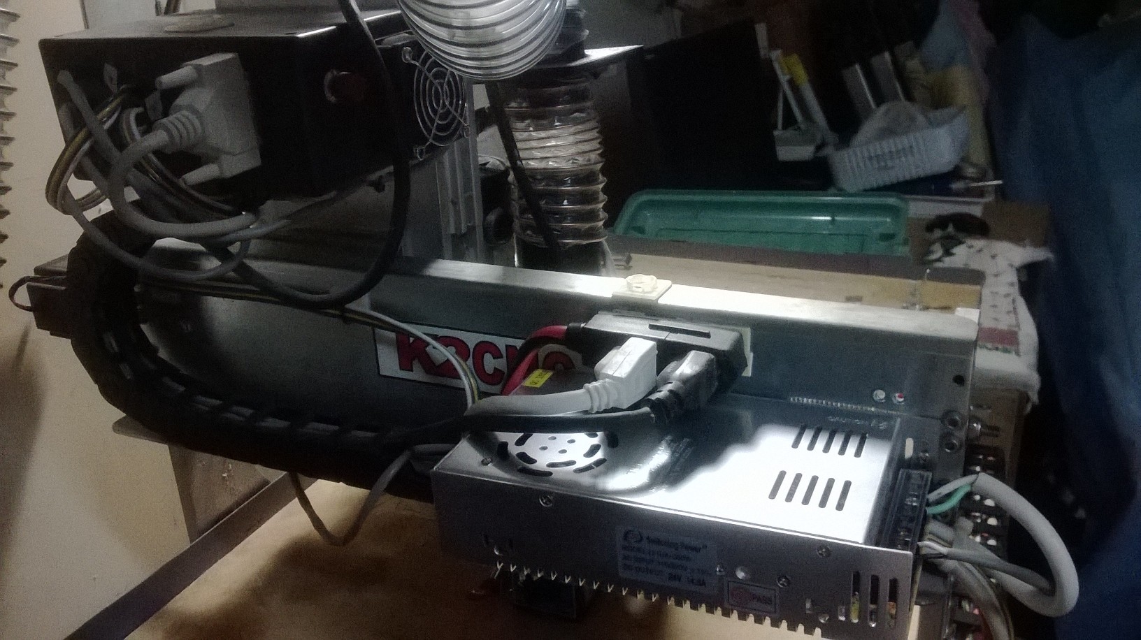

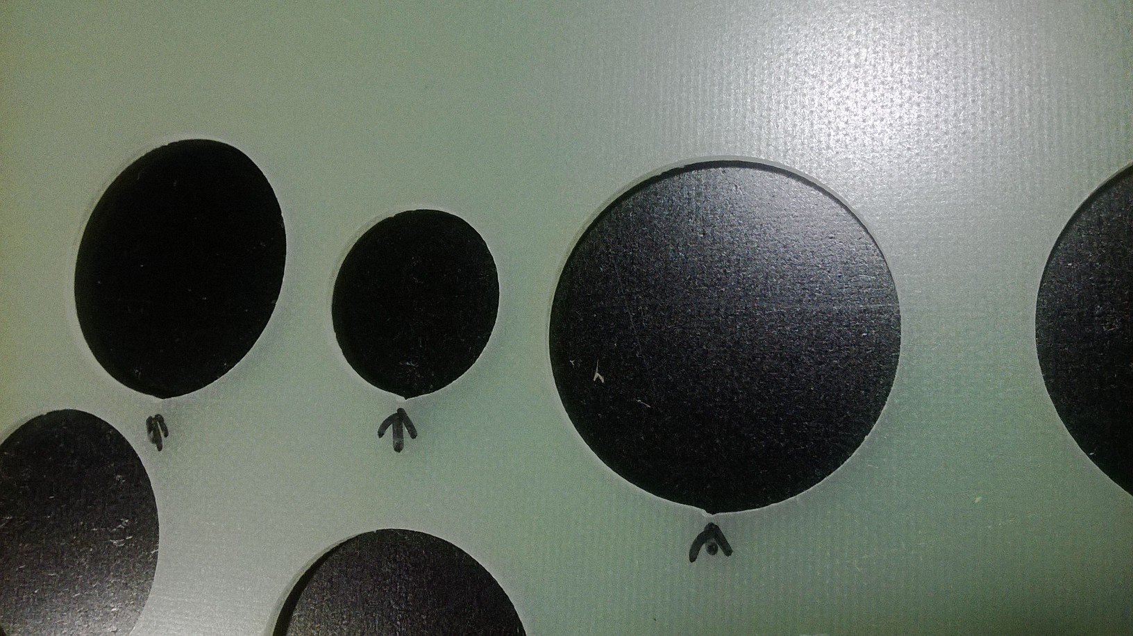

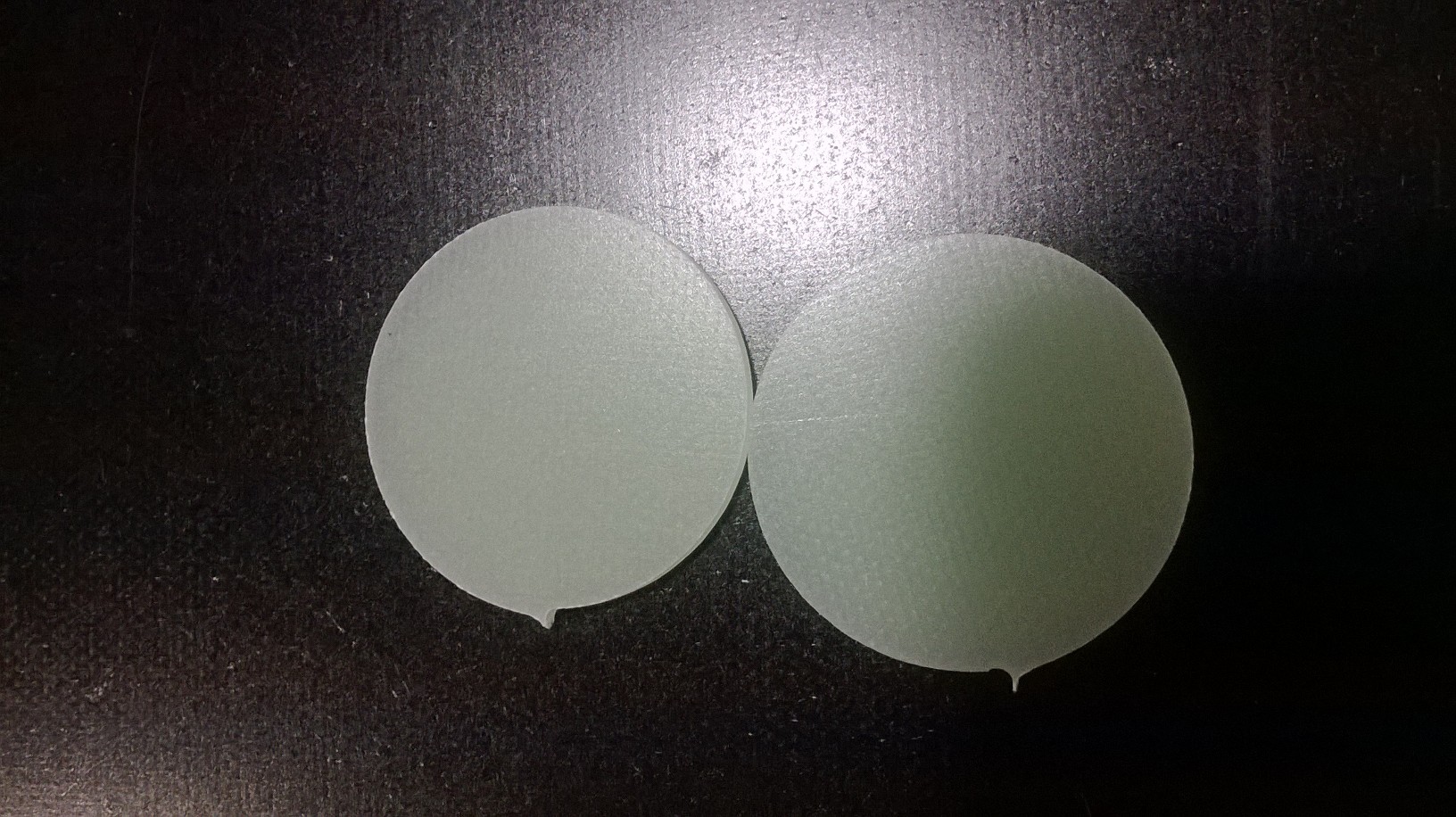

Still same problem after changing the PSU. See attached photos. I reduced the accel from 15 to 10 and test run.

I am not so sure this is step loss. Happens at the same spot every time.
Did you check for backlash or other mechanical problems?

No, it won't. That gives you 0.002 deviation in the distance, and I see more in your photos.

Andy Pugh wrote:
How does the hole size compare to what is being requested? I could imagine what you see being due to machine flex. (especially if the Z rocks during a plunge)
Tangential arc lead-in moves would be nicer.
Did you try this?
Change the code to begin at a point outside of the shape to be cut and plunge at a tangent down to just above the workpiece.
What your original code was doing was the opposite, it started at X0 Y0 and then plunged towards the outside extent of the shape, meaning any overrun through flex would be outside that extent not within it.
My changes in breaking up the moves, brought the cutter above the plunge point and then lowered the Z axis, removing this outward tangent.

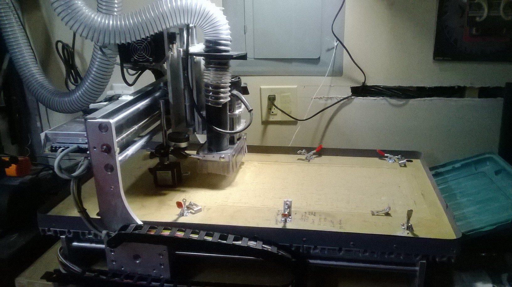

This is my machine:
K2cnc capable of cutting 13" x 25" with 296 oz of stepper motors and a porter cable router .See attached photos.

OK so it is a small router type machine.
