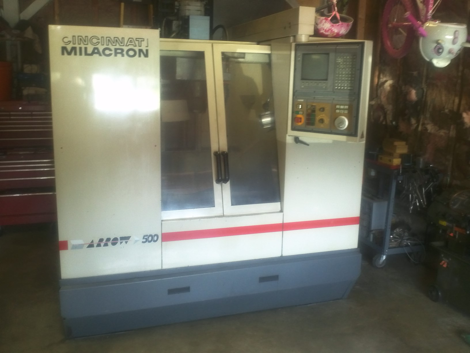

Okay guys,
I have been slowly working towards this project acquiring everything I need to make it happen. Despite the advice to the contrary I decided to basically gut the entire electronics cabinet and start over with new known working components. Until now I have been chronicling this build over on the CNCzone Cincinatti forum. Honestly I have enjoyed it over there for some time but ever since I moved to the VMC and that Cincinatti forum it seemed like it has slowed down considerably. That and all of the extraordinarily annoying advertisements and forum problems has made it quite frustrating to post over there. I am seriously considering posting all of my progress and questions here predominately because you guys know the system I am using better than most of those guys over there altho I know many of you post there too occasionally.
Anyways, I have gone with the Teco motors and drivers from Machmotion and so far I am very happy with that choice. The stuff I received is very high quality and their support has been good as well. I went with their TSTC-30 drives and 1kw motors for the axis drives and the Z has their integrated brake assembly since my machine has no counterweight. For the spindle after much deliberation I went with a hitachi WJ 200 model which seems to be a VERY nice unit made in japan. It has quite a lot of interesting features and even has encoder feedback. I also purchased a very tiny fractional HP VFD also a Hitachi to run the three phase coolant pump. Its a cute little thing that will sit on the bottom wall of the enclosure and be switched on and off with a 24v signal from the mesa card.
I am going to start posting my progress here so here is an update on the goings on. Thus far I have already removed everything from the electronics cabinet with the exception of the main disconnect, the various relays which some of them I will be re-using, and the 24v power supply as well as I left the original cables that were for the fourth axis prewire setup. I will be re-using the existing spindle motor and the toolchanger motor as well as the rest of the toolchanger system which is basically entirely pneumatic solenoids that are switched with 110vac. All of the original limits and home switches will also be reused as will the coolant pump. None of the original control parts will be reused including the entire pendant assembly.
So far I have installed the three new Teco drives into the cabinet, I have fabricated a nice pendant plate to mount the new LCD monitor into. I am re-using the old E-stop button as well as the original Cincinatti MPG wheel. I have already installed these into the pendant panel and have started to wire all of this stuff up. I am using an intel atom motherboard that is maxed out in Ram and I am using a small Solid state hard drive. My initial thoughts were to install the computer inside the electronics enclosure but that has since changed and I recently removed it from the steel box I had it in and installed it in the pendant housing which was quite large since it housed a CRT monitor before. So far I have hooked up the 120vac power to the pendant and got the computer and monitor to power up and my friend Connor has installed LinuxCNC to the computer for me. I am using the very capable 5i25/7i77 mesanet combo. I initially purchased it not knowing that they sell it with two cable options a six footer and a ten footer. I received the six footer and then found out they sold a ten foot cable for it. I just purchased that new ten foot cable as well as their din rail mounting kit for the 7i77 card. This will allow me to keep the computer up front away from the noise of the drives while still allowing me to locate the 7i77 interface daughter card where it makes the easiest wiring sense. So far after reading a bit thru the mesanet literature on the boards I am very pleased with my selections. It sounds like these boards should run the entire machine with relative ease.
The progress thus far has been chronicled pretty thoroughly on the CNCZONE thread here: www.cnczone.com/forums/cincinnati_cnc/15...w_500_adventure.html
I will answer any questions regarding what has been done so far in that thread but it is all there altho it is probably a lot to read. I will simply move forward here and post the progress as it comes. To be honest I am probably a bit long winded and sometimes talk about things that do not pertain directly to the build so you'll have to bear with me but I am sincerely hoping that with the help of all of you knowledgeable folks that I can get this machine running reliably. This machine is the culmination of a dream for me, I have wanted a full blown toolchanger equipped VMC in my shop for a LONG time now and so far this is turning out to be everything I had hoped for. Honestly it was quite frustrating initially as I struggled to make the original control work reliably but that was just not meant to be so now I am onto the retrofit adventure here an please understand that this machine WILL be used to make me money if I have anything to say about it. I have lots of ideas I want to explore with it and I have been approached recently by several folks who want parts made so with any luck this will turn out to be a happy prosperous story and the start of my CNC shop capabilities.
My goal is to wind up with a machine that works exactly like the original machine did or better. My other goal is to make this retrofit as simple and plug and play as humanly possible. I have made several decisions that lean towards this plug and play mentality. For instance I went with the Teco motors and drives and purchased them complete with premade milspec connectors on the cables that allow me to just plug in the power and encoder cables to all three motors. The Mesa cards are all screw down terminals of course and the rest of the setup I have made purchases that will allow the LEAST amount of soldering and wire splicing etc. The motors are all bolt on and the motor couplers are just clamp on type dual disk units so adapting motors to screws is a bolt on affair. This leaves me only to do the actual wiring of everything and integrate the existing limits/homes/ and toolchanger control into the system.
Initially my plan is to just get the basic machine working. IE all three axis drives, the limits and homes and estop circuit, and the spindle motor without feedback. Once that is operational I can then start using the machine to make parts if I need to while I work on the toolchanger and spindle alignment feedback etc.

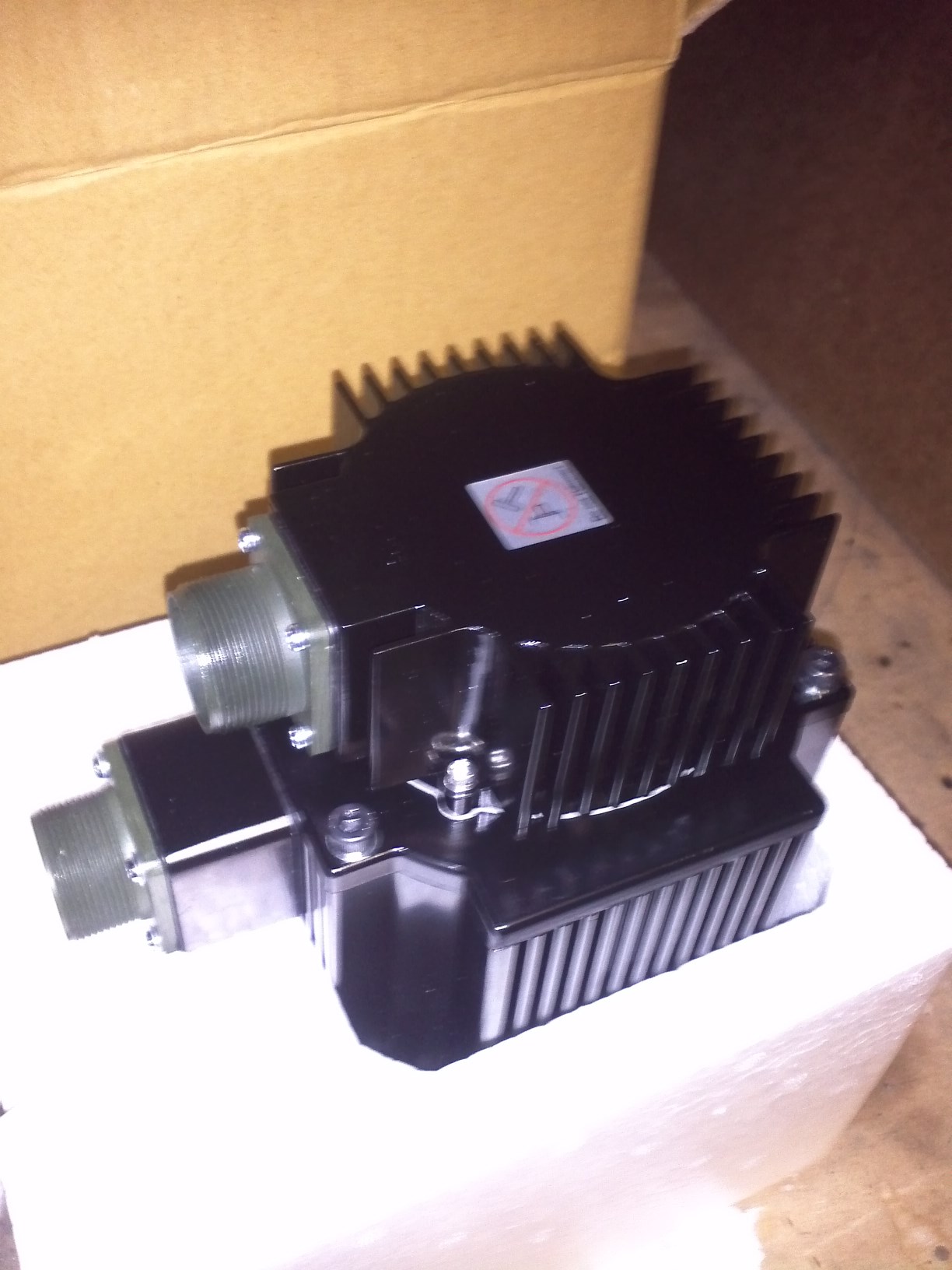

Okay that worked, lets try some more....
That last picture is when I first got it home and powered up. Unfortunately it was very problematic electrically.

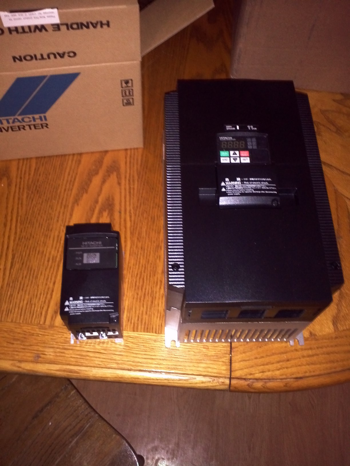

Here I am showing the teco motors and hitachi drives I bought for the machine.
Here I have the three drives installed into the electronics cabinet and you can see it is pretty empty now.

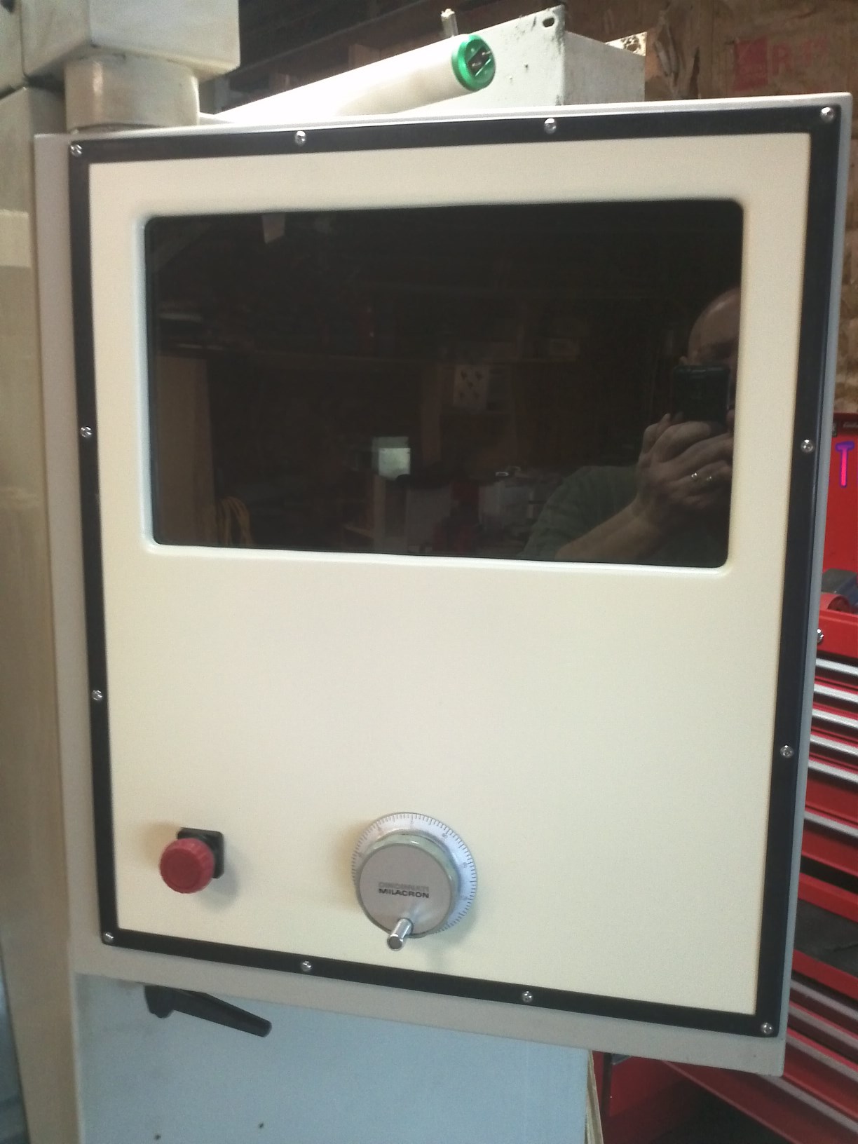

Here is my pendant panel pretty naked so far LOL

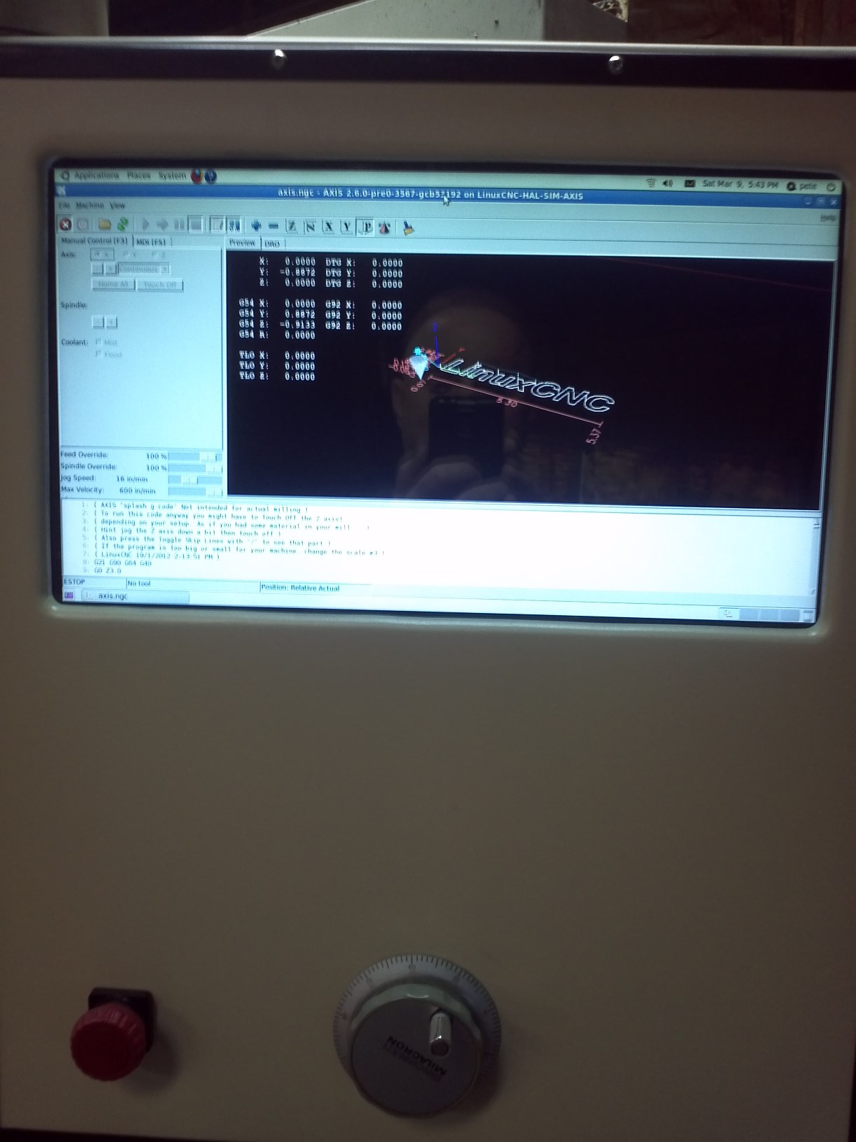

Some more pictures....

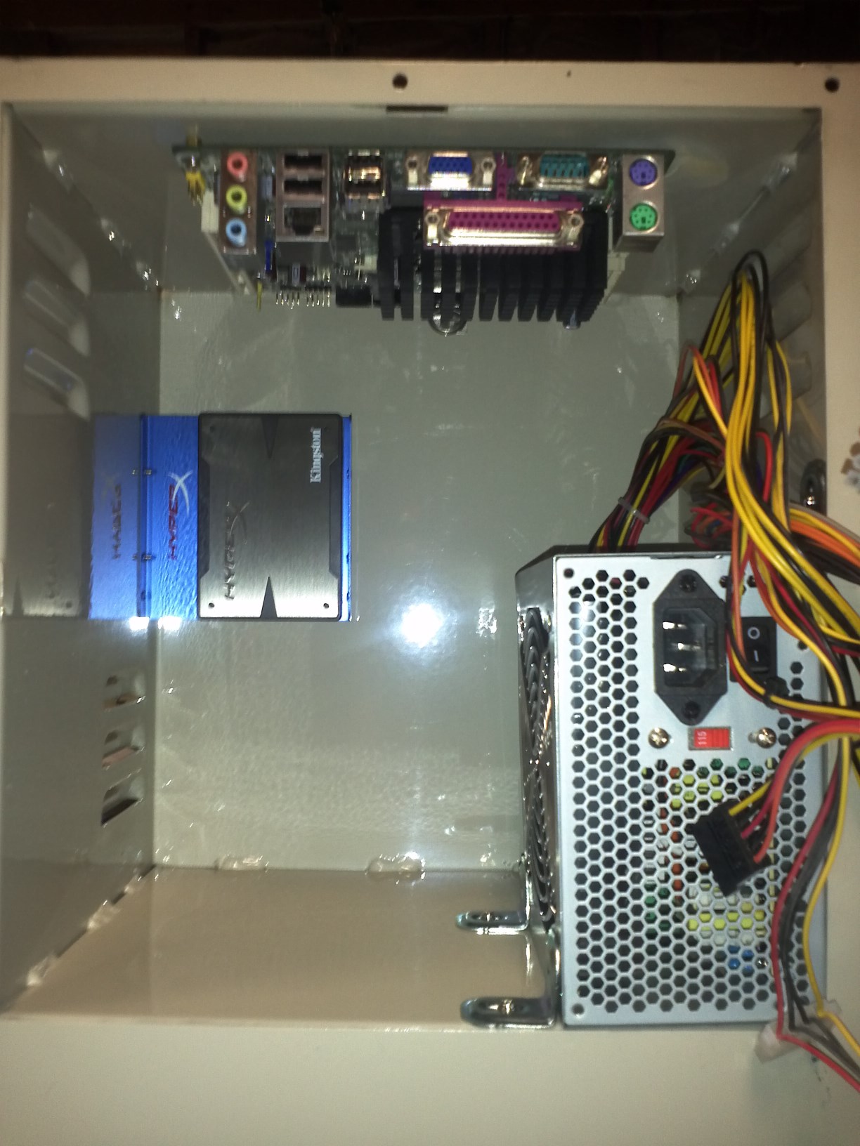

Here is the first mockup of the computer installed into the pendant enclosure.

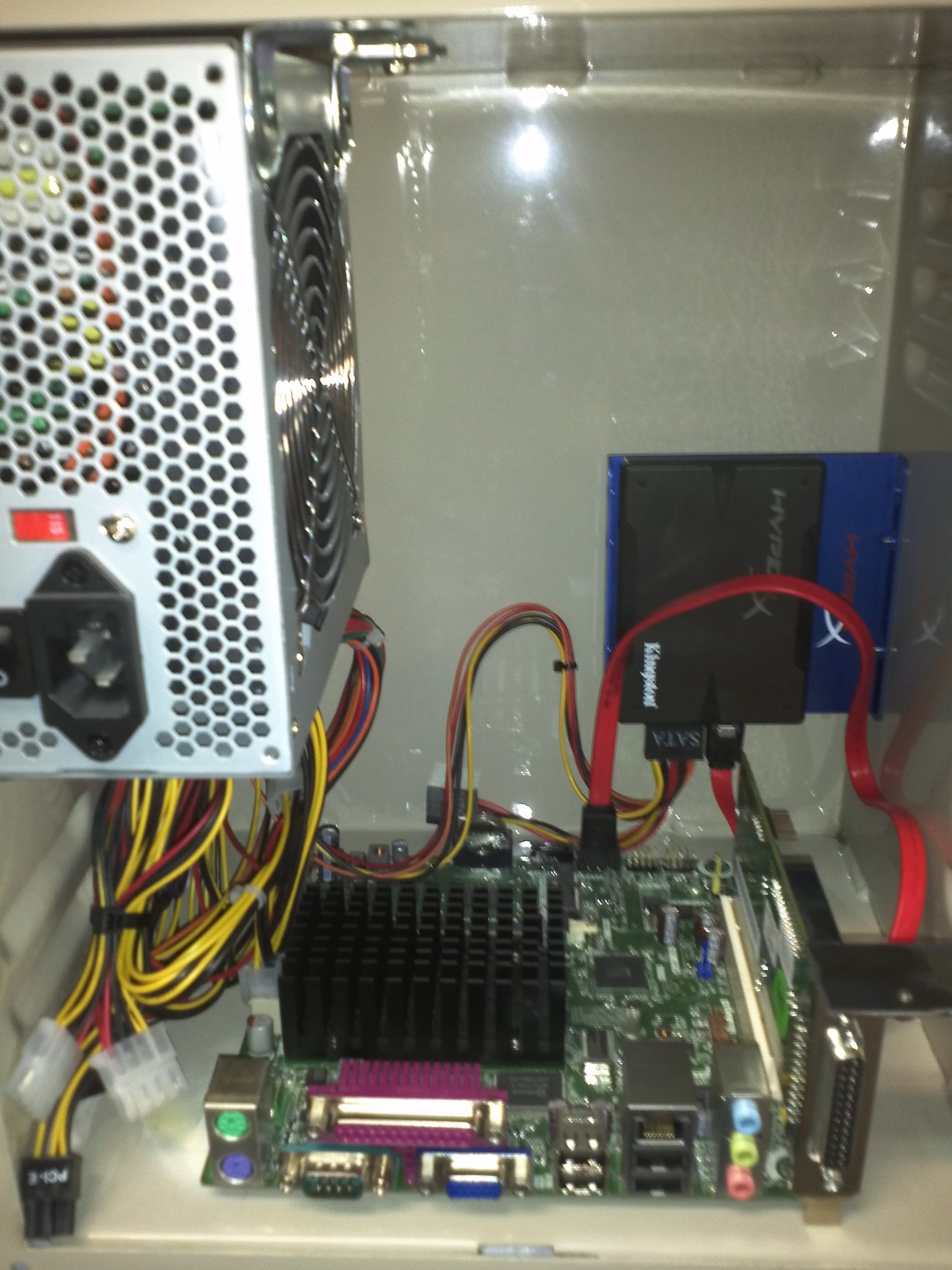

Here it is finalized and wired up....

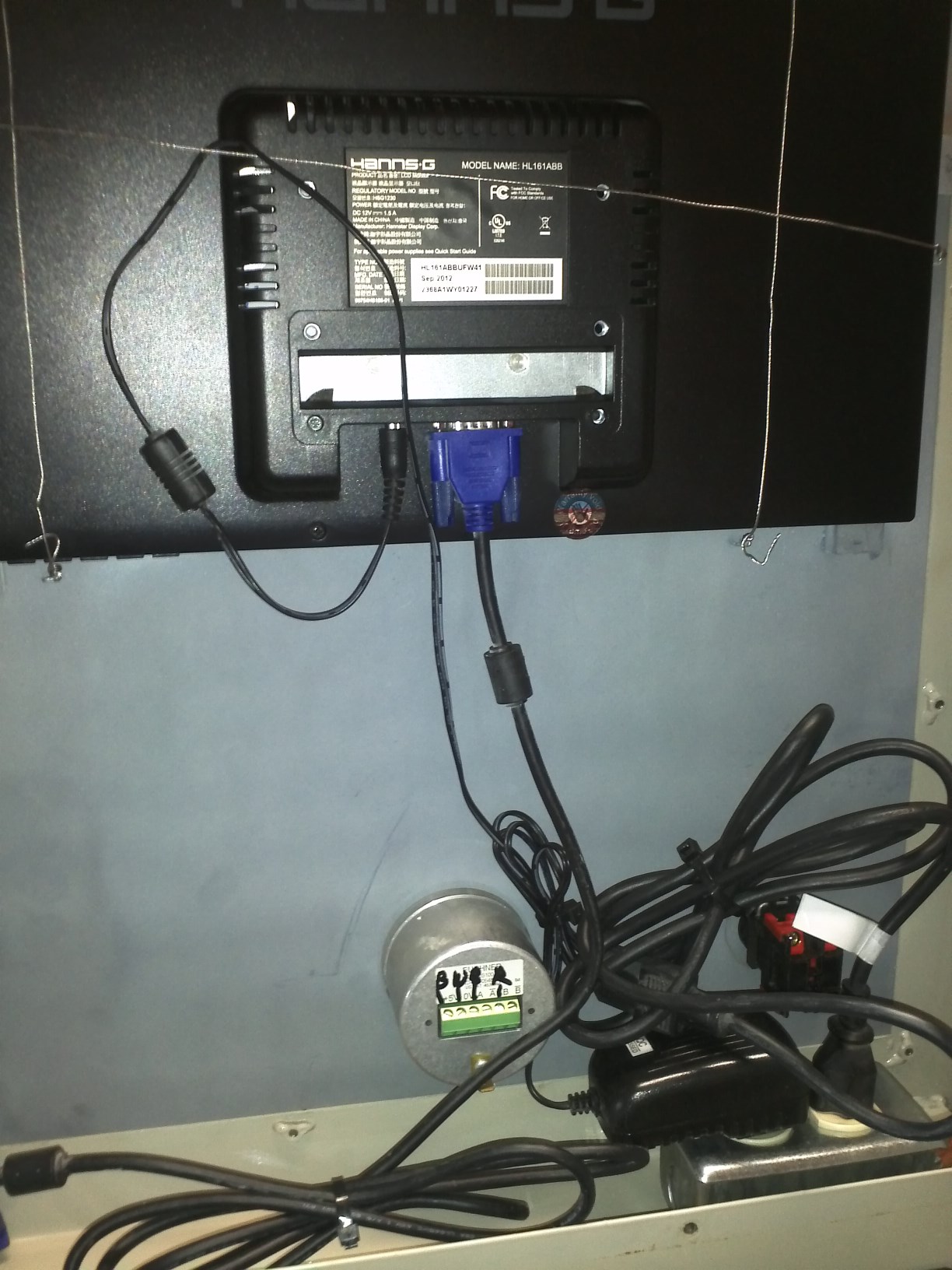

Here is the new monitor installed behind some lexan sealed inside the pendant panel
Here is the pendant with the computer finally booted up with linuxCNC...
Thats all I've got so far with the pictures more to come as I progress here....thanks guys. peace
