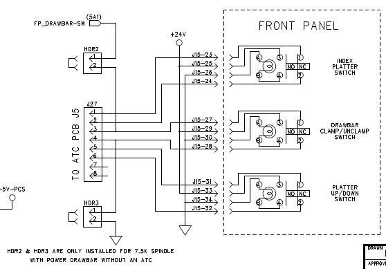

I made some major progress. I looked at the axes and was going to move things manually to get off the limits, but I was looking at the block diagram and I got to thinking. It really bothered me that the work light and the door didn't work, these seem so simple. I have a second Nextmove card that seems to stay in SW reset, but I swapped the PNP modules with the card I was using. Everything seems to work now except for two issues.
1. When facing the machine, if I jog the table, when I click on the right arrow, the table goes left, left arrow, table goes right, in arrow, table goes out, out arrow table goes in. The Z goes up with the up arrow and down with the down, so not sure if this behavior is normal.
2. Second thing is that the tool changer buttons on the front panel don't seem to work. they light up when pushed, but nothing happens. I can manipulate the tool changer to all positions with the SW, including homing the spindle, clamp, unclamp etc, just the buttons don't work, seems like it could be an interface card issue.

29 Jun 2017 15:15 #95176
by x-Intelitek Engineer
Replied by x-Intelitek Engineer on topic Light Machine Corp. Benchman XTr (retrofit)
I would check the J27 Connector on the main board and the J5 connector on the ATC card. Make sure they are fully seated.
I am attaching the wiring of the ATC front panel switches. Let me know if that solves it.
- cncamateur
- Posts: 9
30 Jun 2017 17:45 #95229
by cncamateur
Replied by cncamateur on topic Light Machine Corp. Benchman XTr (retrofit)
I re-seated J15 and now the platter moves up and down, and the drawbar clamp works. Now I need to check whether the signal is toggling for the index platter button. I haven't seen the platter index at all yet, It turns when the ATC homes, but I haven't seen it index. I need to dig into the sw a little more to see how it should act, and whether it can be indexed in SW.
- cncamateur
- Posts: 9
01 Jul 2017 16:02 #95267
by cncamateur
I found out that J15 wasn't the problem, the ATC buttons only work when the Operate ATC dialog box is open. The two problems I have now are that the index platter button doesn't work, and the platter is about .22" too low to correctly engage the tool holder. I don't see any mechanical adjustment on the ATC, do I fix this by changing the home position of the spindle?
