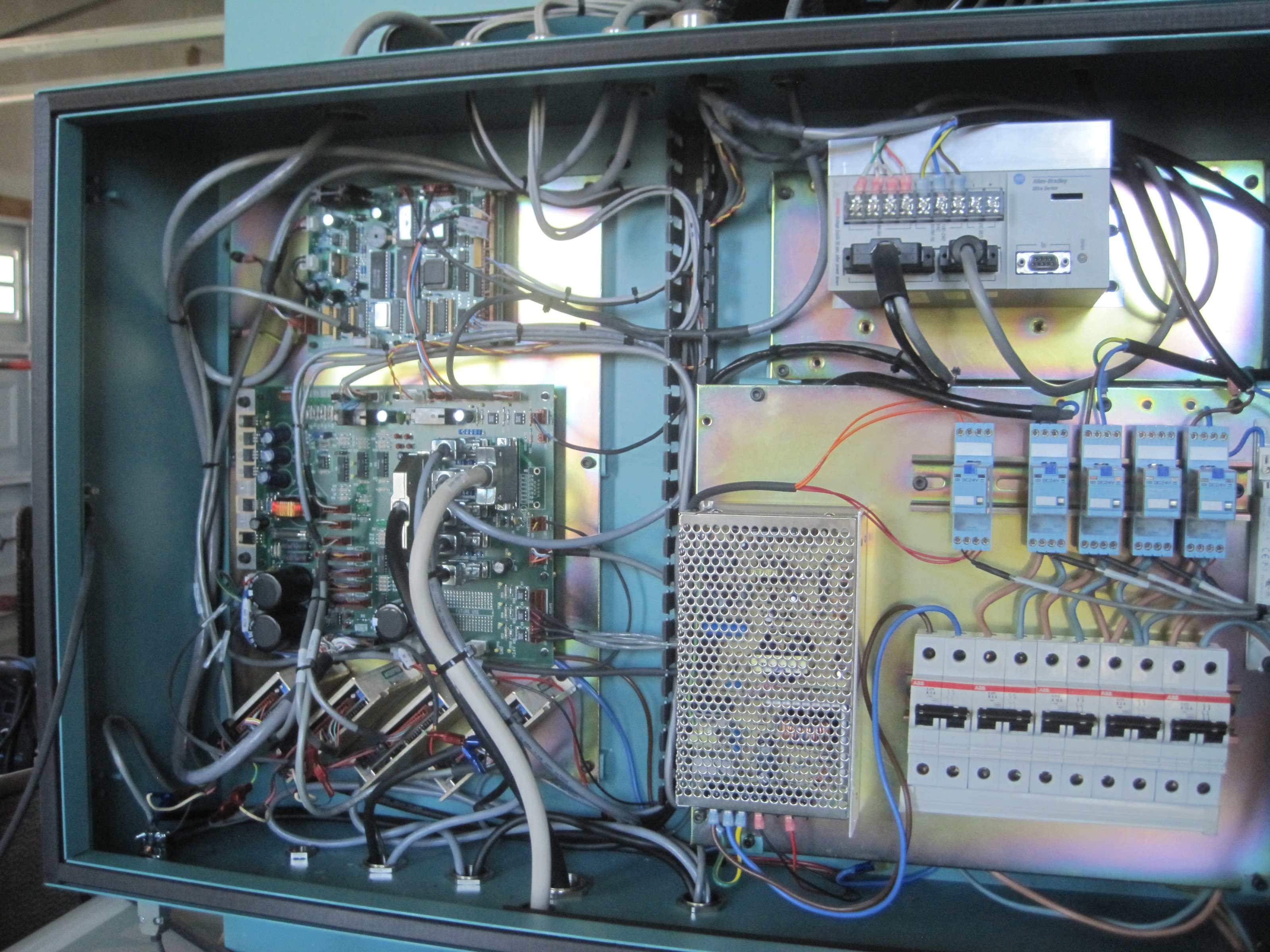

I've been going through the machine whilst waiting for an electrical panel to be put in my garage for power and have a couple of questions:
My z-axis brake seems to be disconnected. As far as I can tell, a 24v and Gnd pair of wires (red/yellow) snake up from the PSU to the z-axis. As that pair of wires pass the control board the red wire is interrupted by a connector socket that is currently floating in space. I suspect that it should connect to pins 3-4 of J5 (schematic location 1D3). Can you confirm that?
Next question, still regarding that brake. The z-axis will move by hand. Is that normal for a machine without power? I would have thought from the schematic that the brake is powered to disengage, and that it should be locked otherwise. Does that suggest a problem with the brake that the previous owner forgot about? Or is it possible that the 45k spindle machine doesn't use a brake and the disconnected connector is simply an unused part of a common harness?
I can confirm that! The power supply generates +24V for the Z-Axis brake that is switched by J5-3&4.
You are correct, the brake is powered to disengage. If you can move the Z-Axis by hand, the brake is not functioning. Remove the brake from the back of the Z-Axis motor and make sure the nut is firmly attached to the motor shaft. The brake locks the nut and the not locks the shaft. Every Benchman machine regardless of spindle configuration has a Z-Axis brake. Otherwise if the machine is not servoing position (think E-Stop pressed, etc) then the Z-Axis will drift down due to its weight.

So that nut was indeed loose. A few minutes with an allen key solved that problem, the z-axis is now locked. I suppose I should ensure that the brake disengages when 24V is applied before I go too much further there.

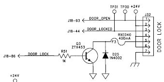

Hello All,
I have a 2002 benchman XT that I cant get running. As it stands now I get the sw running and a door lock error. The Intellitek SW seems to see the ATC and nextmove cards (I have two nextmove cards (PCI001-504) one errors (4 red leds, sw errors) the other seems to work, ATC errors when serial cable disconnected, but not when connected). I suspect I will see other troubles but I cant get past the door lock. The control card in the back of the unit is part number 22-8200-0054, I cant read the model or serial of the whole unit. my questions are:
1. is there an easy way to bypass the door lock, maybe using tp 30 and 31?
2. My machine has the 4th axis but its bypassed in bench-setup and also has the plug on the connector. There are two cablea coming out of the benchman that both fit the nexmove card, is the one connected to J18 on the board in the back of the unit the correct one for operation without a 4th axis? (this seems to be the 100 pin one)
3. Is there anything else I should look at to get it going, or a way to test the Nextmove card? Nothing seems to work unless I can home it, and it wont move without door lock. Spindle doesn't run. I have the manuals and the readme with the PCI card update, I have attached a photo of the rear wiring box.
- x-Intelitek Engineer
- Posts: 113
- Thank you received: 22
28 Jun 2017 16:34 #95112
by x-Intelitek Engineer
Replied by x-Intelitek Engineer on topic Light Machine Corp. Benchman XTr (retrofit)
Is your door lock error an indication in the s/w that the door is/is not locked or is your door always physically locked?
Due to safety concerns, I cannot advise you how to bypass the door lock or it's signals but it is a simple circuit.
I can't post the entire board schematic without Intelitek's permission, but I have attached the relevant Door Lock section.
J18 is the main Nextmove connection.
J18-86 is the signal from Nextmove to lock the door
J18-44 is the signal to Nextmove that the door is locked
J18-93 is the signal to Nextmove that the door is open
The software won't allow movement or spindle while errors are present.
You need to get that red box in the lower right off.
Let me know if I can help in any other way.
