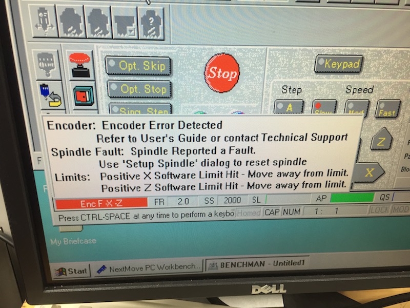

22 Aug 2017 00:49 #97845
by project-pegasus
Replied by project-pegasus on topic Light Machine Corp. Benchman XTr (retrofit)
I purchased a Benchman XT and a VMC 4000 a few months ago, but neither came with the PCs. I was able to find two NOS Nextmove PC cards recently but they are not LMC spec cards. I've installed them in PCs using Windows 2000 and Windows 98 but 9 times out of 10 when I open the Benchman XT software I received this message: "Could not initialize motion control board." When the software does see the card I can't get the s/w to control the machine. If I try to jog any of the axes I can hear a relay click but then get a message about "Amps not enabled." It also shows errors concerning axes' limits being reached. The front operator panel buttons do not work either; they light when depressed but nothing happens. I was able to activate the drawbar via the software last night, but I assume that was because the ATC and drawbar operate via the serial port on the PC rather than through the Nextmove card. I'm left wondering if I will be able to get these Nextmove cards to work since they did not come directly from LMC and perhaps do not have the correct firmware. The Baldor Mint software has no difficulty seeing the cards and connecting to them so I'm fairly confident that I have the right DIP switch and I/O resource settings. Any help would be GREATLY appreciated.

22 Aug 2017 16:10 #97881
by x-Intelitek Engineer
Replied by x-Intelitek Engineer on topic Light Machine Corp. Benchman XTr (retrofit)
As I recall, Windows NT 4.0 was the ONLY operating system that was suitable for Benchman systems.
There are some switch settings on the Nextmove cards, but I believe they are discussed in Benchman documentation.
There are two options for the Nextmove cards, PNP or NPN inputs.
The front panel operator buttons only work when the ATC dialog box is open.
The 4000 is before my time, but is in the evolutionary history of the benchman.
If both machines are giving you the exact same problems, I would begin with the Nextmove cards.
Intelitek should be able to tell you the exact Nextmove part number and switch settings as a last resort.
Let me know if you have more specific questions

29 Aug 2017 22:02 #98167
by project-pegasus
Don,
You were right about Windows NT being the only OS that works with the Benchman software. The Nextmove card initializes no problem now, but I'm getting the following error messages:
When I try to jog the table I get this error message: "Amps could not be enabled. Please try again." I also have not been able to reset the spindle. The Nextmove card I'm using is NPN and I saw in an earlier post by CNCamateur that he was able to address similar issues by doing something with the PNP modules on his Nextmove card. Any ideas what that might have been? I thought I read somewhere about the Copley amps being jumper configurable for PNP or NPN digital outputs. Has anybody hear of this?
Thanks,
Troy

30 Aug 2017 18:26 #98227
Troy,
You will need to attack these errors one at a time.
Limits first, encoders next, then spindle.
Do you have the Benchman Manual?
If not, get it from:
www.intelitekdownloads.com/Manuals/CNC/O...ide_34-7713-0001.pdf
What is your spindle configuration (speed/toolchanger)?
What is the exact Nextmove card part number you have?
Don
