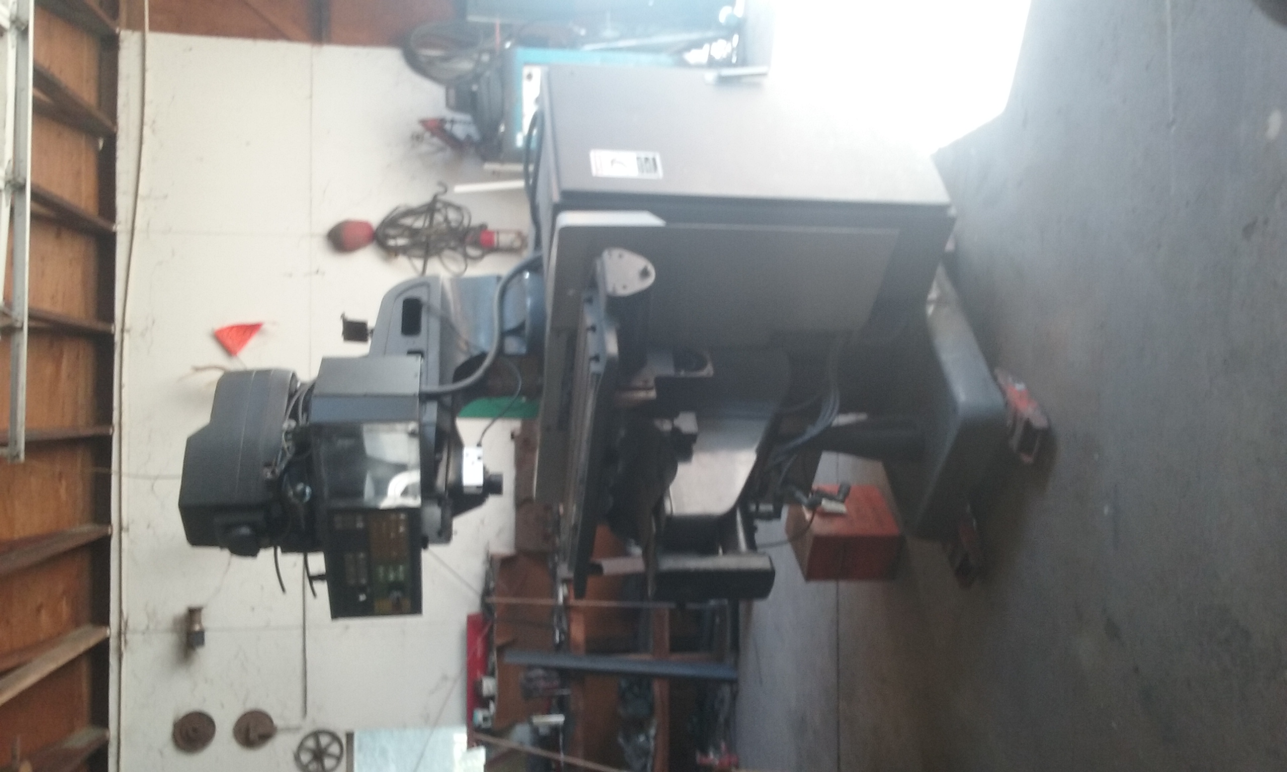

I just acquired a BOSS R2E4 that is in good shape other than controller is bad and has electronic drives have been removed
From what I have read on this thread to retrofit machine to LinuxCNC (which I have never used, at least yet)

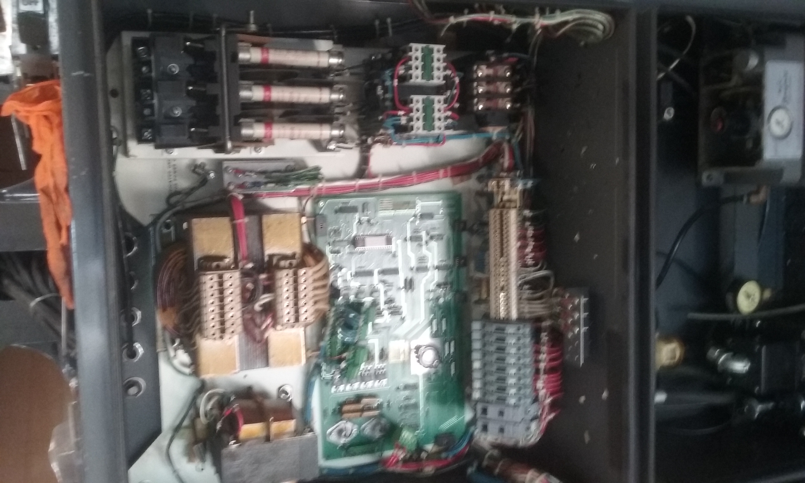

Power supply ? the transformers are intact, just not sure how to convert, I don't have any schematics.

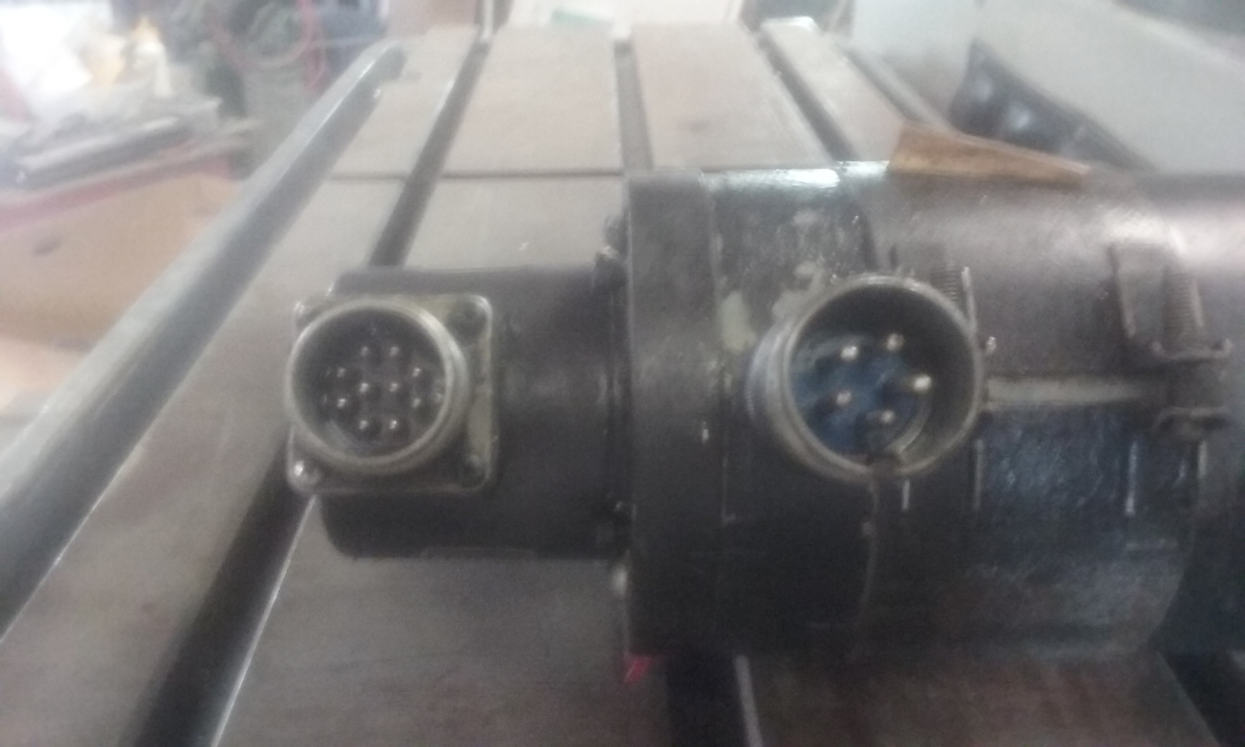

It has enough pins to be almost anything. It could be encoder + tacho, it could be a resolver. Any plates, serial numbers, other clues?

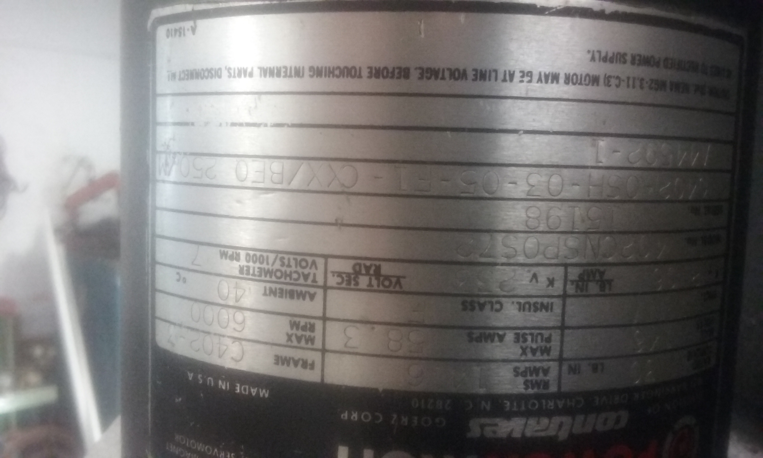

No plate on it. The motor does have a plate on the side of it but that probably does not help. The machine was minus one motor, the guy I got the machine from took one off of another matching machine and gave it to me, he said it was the same thing, it looks to be a match and it does have a tag on it.
BEI Mod# E25G-250-ABZC-8930-SM18-S PART# 924-01029-092A. Maybe I need to take off the end cap and take a look inside??

The label mentions a tachometer, so it seems likely that the 10pin unit contains a tachometer. But that would only use 2 pins, leaving 8 for encoder power and three differential phases.
But it could also be a tachometer and resolver.

Power supply?
I see some people utilize the transformers from original cabinet, is there a guide to wiring this up to power advanced motion controls 25A20 servo drive?
or is it best to purchase separate power supply and remove all the original transformers?
my dc servo motors are rated at max 146 volts.
