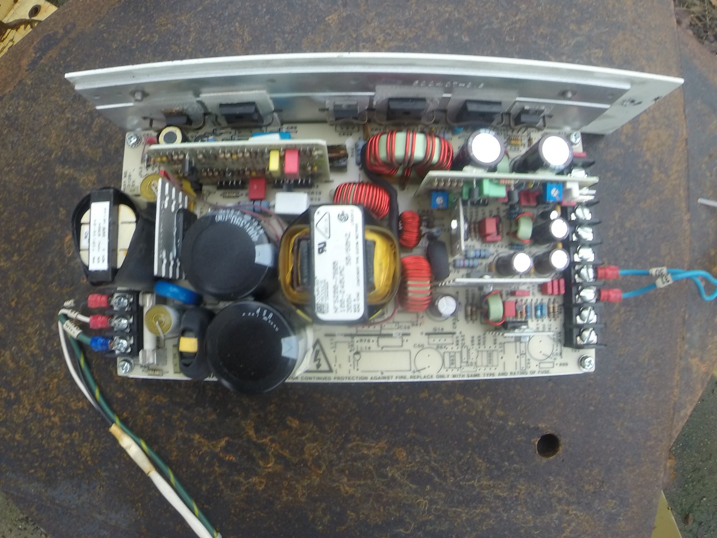

I retained the drive transformer / logic power supply.
Both cabinets are gutted mostly.
I want to move back cabinet to the position of side cabinet (if I have enough room for components)so I can push mill back to wall.
www.grmolds.com/?p=57 is no longer available to me, can you access? I did print it off, so I do have his instructions.
I am getting ~130DCV from capacitor strip.
logic power supply is listed as 5 volt as well as + - 12 volt, do I power 7177 field power with 12v? I can get 24volts out of logic power supply by using both + and - 12 volt leads by using -12 as ground and +12 as hot, is that how I need to power 7i77?

27 Nov 2016 17:42 #83370
by Birddogs
Replied by Birddogs on topic Bridgeport Boss 9 R2E4 convertion
- Posts: 21995
- Thank you received: 7488
27 Nov 2016 18:12 #83373
Replied by tommylight on topic Bridgeport Boss 9 R2E4 convertion

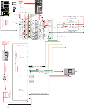

The picture is way to small, so i can not see clearly what goes where.

27 Nov 2016 18:22 #83375
by Birddogs
- Birddogs
- Posts: 20
27 Nov 2016 18:25 #83376
by Birddogs
- Posts: 21995
27 Nov 2016 19:02 #83380
Nope, that is still the same resolution, just cropped.
289x368 pixels is just not enough.
