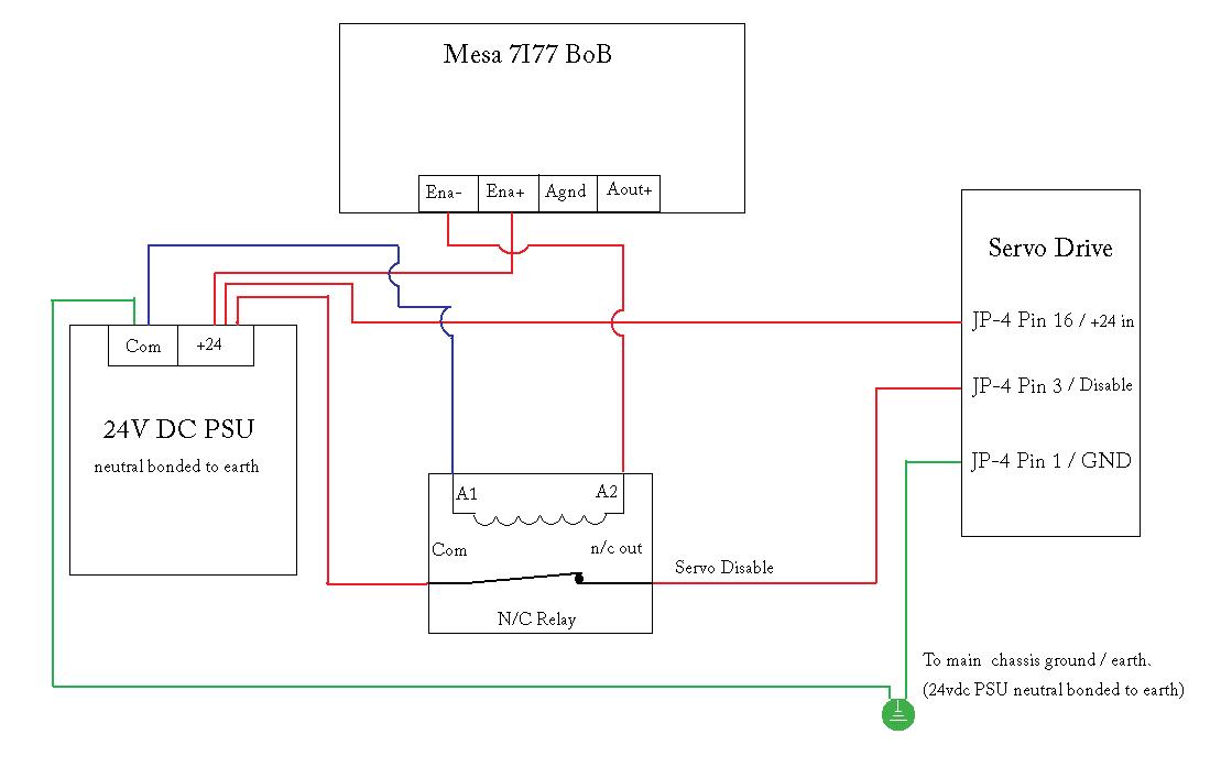

I spent the weekend working on the mechanical side, mainly on the Z-axis... I configured the servos and will need to tune them soon.
Anyways, I have not worked on getting the enable signal to work correctly as I got side tracked working on other parts of the machine.
I have attached a wiring diagram of how I think I could get the enabled reversed for disable. I would like to see if the way I have it wired in the diagram would work correctly... I thought it would be best to ask you guys before I do it so that I do not damage the 7I77 board or drive by doing something wrong.
@PCW I understand the way you suggested to wire up the relay but would I not need to wire the coil to the ENA- so that the drive will enable when Linuxcnc sends out a enable command? I might not be understanding something correctly.
Thanks!
Thanks!
- alan_3301
- Posts: 136
- Thank you received: 22
28 May 2015 02:53 #59125
by alan_3301
Replied by alan_3301 on topic DMM DYN 4 servos + Mesa 5i25 & 7i77 XYZ+A Cnc 5x10
That looks good to me, but I would wait for a more confident answer.
What do you mean when you say the neutral is bonded to earth.
If it's a 120V input power supply, it should have L1 and L2 inputs connected to 120V and Neutral. The case should be connected to ground.
You aren't supposed to have neutral and ground connected together anywhere but at the main service entrance.
- alan_3301
- Posts: 136
28 May 2015 02:59 #59126
by alan_3301
Also, I wouldn't think jp4 pin 1 should be connected to earth ground.
It is used as a reference for the monitors on pins 8, 20, and 21.
you may want to ask dmm about that.
I would leave disconnected unless you are going to wire the monitors up, in that case I would connect it directly to the field power supply negative terminal.

- ROB-CNC
- Posts: 19
28 May 2015 03:17 - 17 Mar 2016 18:07 #59127
by ROB-CNC
Replied by ROB-CNC on topic DMM DYN 4 servos + Mesa 5i25 & 7i77 XYZ+A Cnc 5x10
Hi Alan,
What I meant is that the 24v dc common is bonded to ground, this is to help reduce noise in the system. I've been told it is good practice to bond all low voltage dc psu commons to earth ground. There are no high voltage lines tied to the machine ground as that is not a good idea.
Thanks.
Thanks.
Last edit: 17 Mar 2016 18:07 by ROB-CNC.
- ROB-CNC
- Posts: 19
28 May 2015 03:32 - 17 Mar 2016 18:05 #59128
by ROB-CNC
In regards to pin 1 ground, I had the same assumption. Pins 1,9,12 are all tied to the JP4 connector shell internally in the drive so I assumed It would be fine to use pin 1 to connect the cable shield since they have it tied to the connector shell anyways.
Last edit: 17 Mar 2016 18:05 by ROB-CNC.

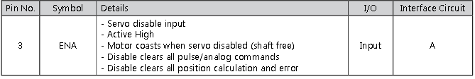

- alan_3301
- Posts: 136
28 May 2015 23:03 #59157
by alan_3301
I saw your post on cnczone, made me think about it more
Dmm calls the enable input active high. When described as disable input on the other diagram, it shows ground to activate.
So.. instead of 24v being switched by the relay to jp4 pin3, It makes sense to me to send ground down that wire to the relay contacts.
Normally closed relay, ground passing through - Disabled.
relay active, open circuit, drive pulls the line high - Enabled.
maybe try that?
maybe try that?
