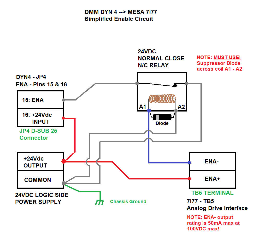

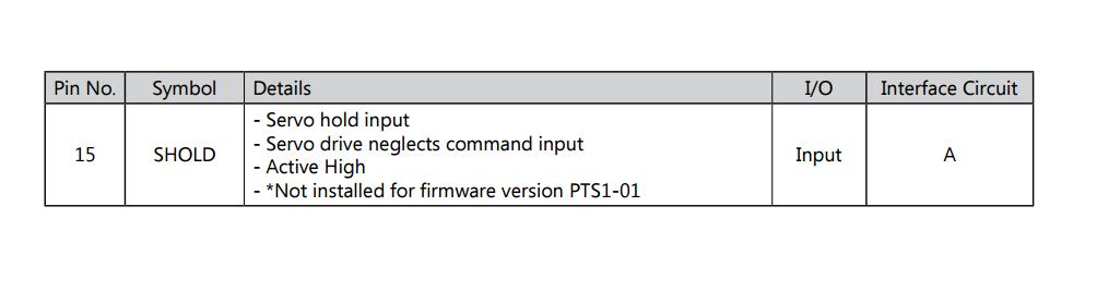

I probably have reread the manual a hundred times and I think I may have found a hint of why the drives are not disabling and responding to the analog command outputs from the controller when it should be disabled.
JP4 Pin 15 SHOLD disables the position command inputs. Pin 15 is required for my drive for enable/disable.

Seems like we figured this one out... Tested pin 15 as a enable pin and that surely did the trick.
DMM tech support confirmed this in a email (Thank you Aidin at DMM for clearing things up).
I'm posting the email reply on here as It may help any future Dyn4 users get going and set up quicker.
" Hi Robert,
It took us a while but we figured out it is a small change in the firmware for the drives for the Disable. There was a new firmware for the DYN4 drives released earlier last month that had the disable pin incorrectly set to Pin. 15 instead of Pin. 3. Pin. 3 is the pin outlined in the manual and initial requirement, but it was temporarily changed to Pin. 15 to test for develop I/O and was left there by mistake. So currently on the drives, Pin. 15 is the disable and Pin. 3 is not connected NC. This firmware was incorrectly migrated to our production QC software so it wasn't picked up at production.
So basically to disable the drive (using internal power) you will need to connect:
(1) Pin. 17 to Pin. 4 (provide +14V power)
(2) Pin. 15 to Pin. 1 (to activate disable to disable servo loop and motor shaft open)
Or using an external +24VDC power supply: connect positive terminal to Pin16 and connect Pin15 to the relay or negative terminal of your power supply.
Please note that this process will disable the servo loop and once the servo is in disable state the drive will ignore all input movement commands and the motor shaft will be FREE. If your requirements is to not allow any servo movement to be made, you should simply not input any command and the motor shaft will be LOCKED in normal servo operation!

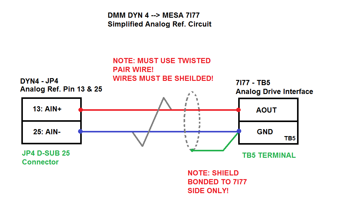

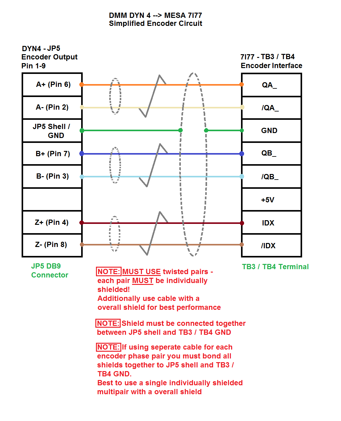

To answer your question, Yes, I did manage to get the Dyn4 to work reasonably well with the 7I77. I am running them in torque mode, +-10v analog. I am not completely happy with the way they tune but I managed to get them tuned enough to where I can run programs. The drives have very limited and unconventional tuning parameters. On my system the only way to get a decent tune was in torque mode which requires a lot of filtering and dampening but the filter and tuning parameters in the drive did not seem to work for me at all running in torque mode so I could only tune in LinuxCNC. Also, using the torq const. filter in the drive would create runaways for whatever reason. Maybe in step and dir they run better but I would need to swap my board out with a 7I76 to test. I'm just going to stick with the 7I77 and try to work on the tune some more when I get a chance.
I drew some simplified sketches of how I wired the I/O from Dyn4 to 7I77. Now my control cabinet is a lot more complicated than the sketches and I have a electrical cad file with all the wiring, it can be a bit overwhelming. It would take a few hours to go through and study all the circuits. But hopefully the simplified sketches help you understand how I have it running.
The enable circuit (which is technically a disable in the Dyn4) required me to use a N/C relay to get this circuit working with the 7I77 since the Dyn4 enable(disable) logic is backwards. I run 24Vdc from the main logic PSU (Omron S82K-10024) to Dyn4 JP4 Pin 16, run pin 15 through a N/C relay to the PSU common. 7I77 triggers the coil which will enable drives when LinuxCNC is up and running. In my complete cabinet circuit I also run a PILZ safety relay tied to my main estop which keeps the drives from powering on till I am booted into LinuxCNC it also keeps me from powering on the drives when no 24vdc "disable" signal present or if there's any sort of fault. I don't have to worry about runaways happening before linuxCNC takes over and the control system is ready. I don't show the safety loop in thw simplified sketch but it shouldn't be too hard to implement in your system. Professional CNC cabinets should always have a good safety relay anyways to handle estops, failures and such.
I can, if needed, draw some simplified sketches of how my high voltage side is wired and how the main contractors power on sequence is setup.
Let me know if this is of any help.
