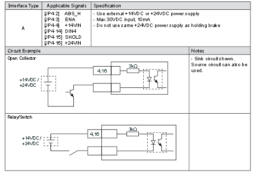

Hey guys,
I have been quite busy with the day job and have only had a few hours to work on the machine. Progress is slow but good. I have more time to work on it for the remainder of the month as work has slowed down .
The servos are responding to the analog signal from the 7i77 and they seem to run quite nicely. The electrical panel is about 90% finished and coming along nicely. Finished the e-stop circuit, it is controlled with a Pilz Pnoz X9P safety relay as well as Linuxcnc.
A problem that I am having and can't seem to figure out what it is I am doing wrong is that all drives seem to be constantly enabled and I can run the servos even when there is no enable signal present (enable wire removed from 7i77).
I have wired the enable just as the Dyn4 manual suggests and also the way it is described in the 7i77 manual.
The drive Enable is Active high so I wired it as the 7i77 manual suggest, ENAN+to main 24vdc, ENAN- to drive ENABLE input.
I know that the 7i77 enable out is working as it should because when linuxcnc is not running the measured voltage to ENAN- is 13.3V and when enable signal is sent from Pncconfig or Linuxcnc it measures 24V.
Any suggestions?
Any suggestions?

23 May 2015 07:59 #58944
by alan_3301
Replied by alan_3301 on topic DMM DYN 4 servos + Mesa 5i25 & 7i77 XYZ+A Cnc 5x10
For some reason they thought it was a good idea to default to enabled.
I was very frustrated with the dyn3 that I was trying to configure and ended up taking it off, I'm shopping for a delta to replace it right now.
Anyways...
In the dyn4 manual it looks like you need to wire field power 24v to jp4 pin 16 (+24VIN)
then field ground would be supplied to JP4 pin 3 to enable. (or would that be a disable input????)
it shows this as a sinking input circuit.
it says a sourcing input circuit may be used, but of course no example. It may be obvious for electrical engineers, but I want something showing me exactly how NOT to fry the input.
I would try wiring field ground to ENAN+, with field power wired to jp4 pin 16.
If you need it, they have ok email support lately. I usually get a response within a day.
Anyways...

23 May 2015 08:12 #58945
by alan_3301
I guess I wasn't completely clear. scratch my last suggestion.
What makes sense to me is:
Field ground to 7i77 ENAN-
7i77 ENAN+ to DYN4 JP4 pin 3 (enable input)
Field power to DYN4 JP4 pin 16 (EXT +24V IN)

23 May 2015 08:41 - 17 Mar 2016 18:20 #58946
by ROB-CNC
Replied by ROB-CNC on topic DMM DYN 4 servos + Mesa 5i25 & 7i77 XYZ+A Cnc 5x10
Hi Alan,
I definitely understand your frustration with getting the dyn3 to run, It has been somewhat a struggle for me too in order to get the dyn4 servos to spin. With the Yaskawa's I had previously they were easy to configure... the dyn4 manuals are lacking info and are really hard to understand... really unclear at times.
I will go ahead and wire the drive up the way you suggest and report back... Thanks.
