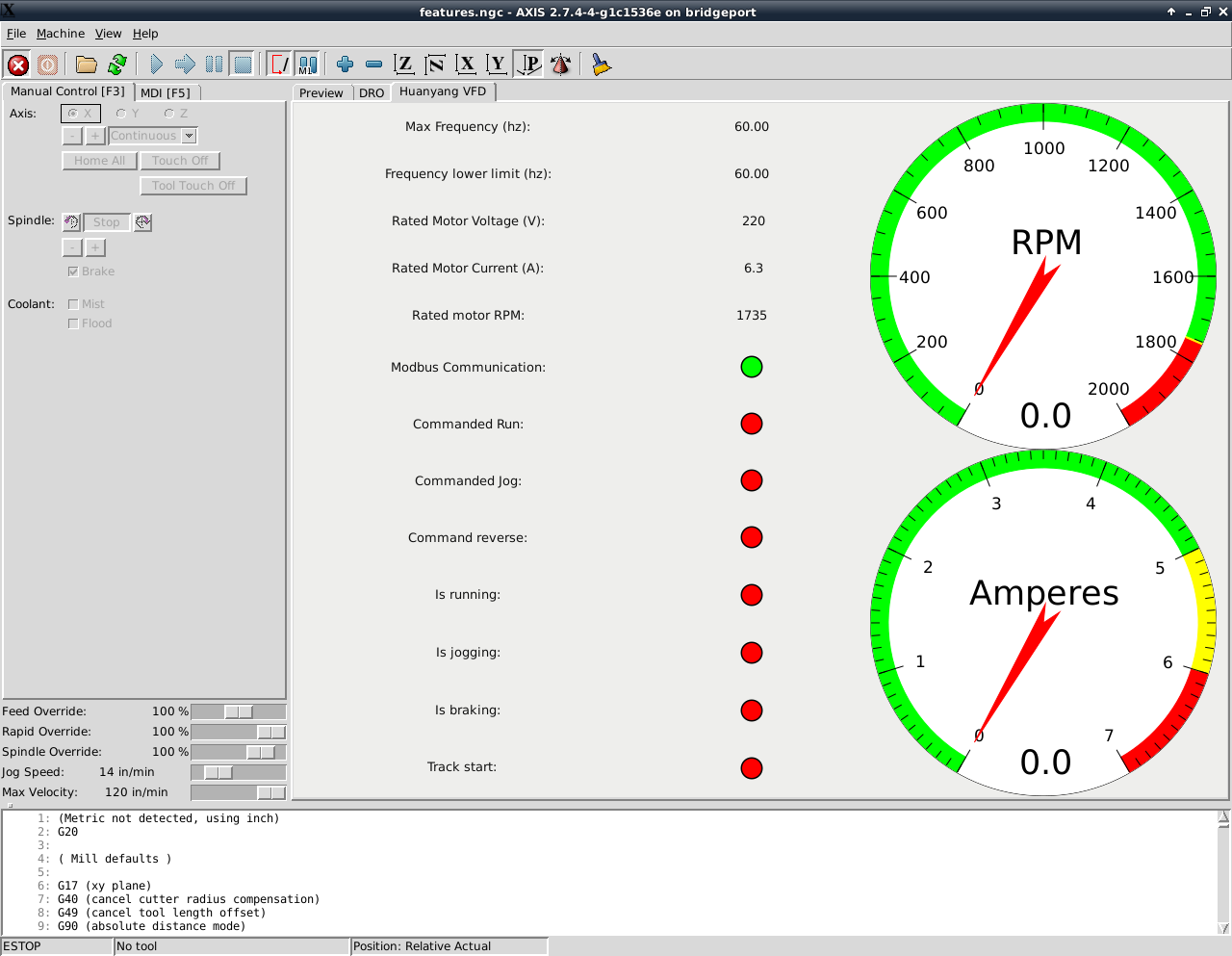

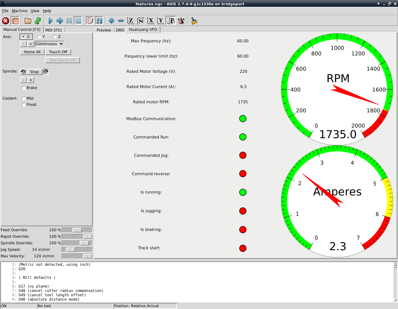

10 Feb 2016 02:22 - 10 Feb 2016 02:27 #69901
by cncnoob1979
Replied by cncnoob1979 on topic Planning - Bridgeport Interact 1 linuxCNC Retrofit
Since I had everything set for the MODBUS hy_VFD I decided to give it another go.
I have it working basically as an off/on reverse switch. I may change it down the road. The recent changes pushed to the git for hy_vfd [sept 2015ish] changed pin names and made this somewhat more difficult.
Had to comment out each item that made me crash and comeback to edit the pins.
Good thing I'm hardheaded as my wife would say. After completing it, I was thinking that it was rather easy.
You don't know, what you don't know.
Anyone looking for details on the setup just ask me I'll do my best to explain what I had to go through.

14 Feb 2016 17:25 - 14 Feb 2016 17:59 #70123
by cncnoob1979
I embedded the VFD into a tab, edited a few things that user "vre" had created. I like it the way it is setup now, im thinking about making the dials into horizontal bars instead.
Now I have a question. Not being a programmer and still very new, I would like to know if it is possible for:

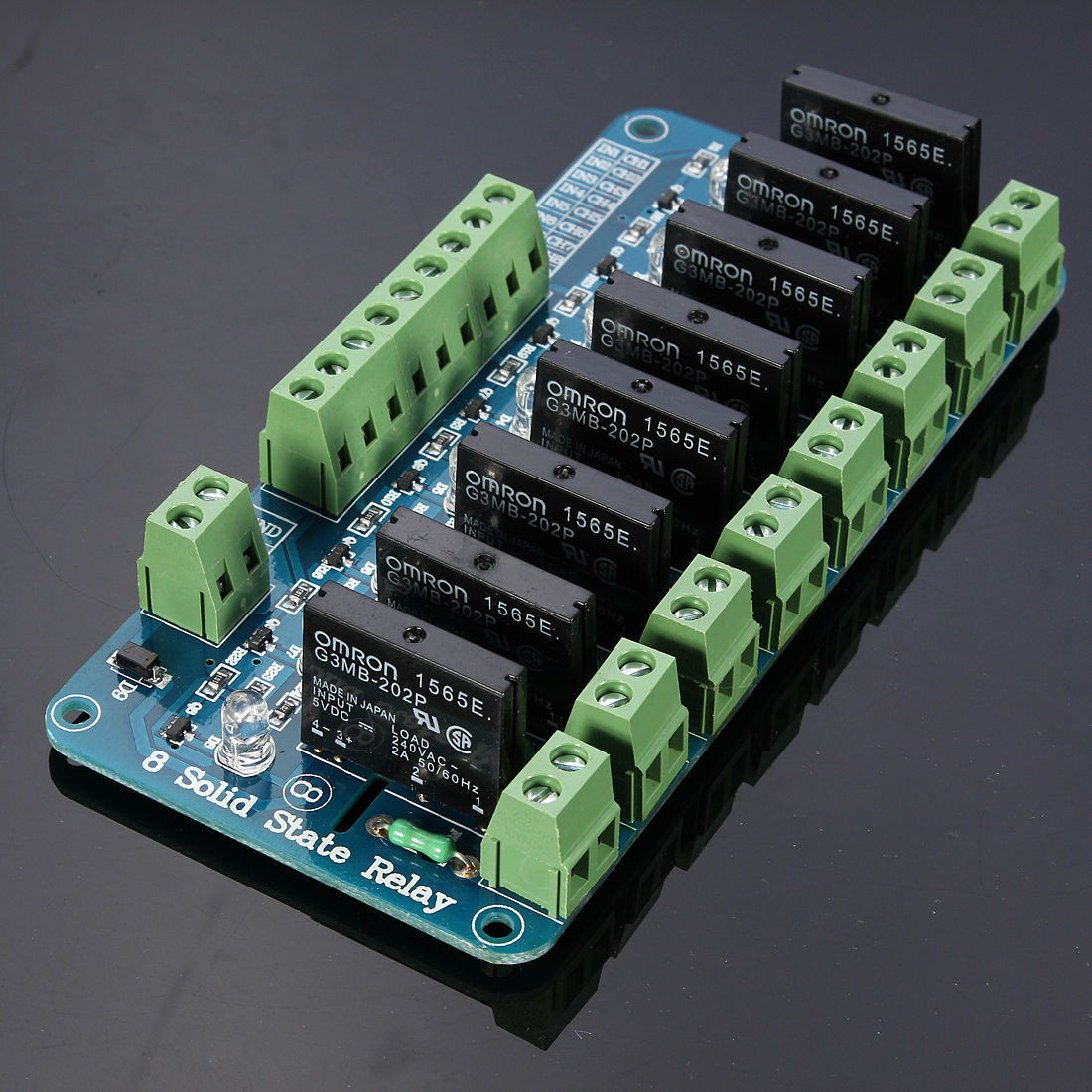

Here is a video of me starting a mockup of a control panel. I want to use a touch sensor to drive my controls. It would be more work and more wiring but could be a very nice setup.
What do you guys think? Would this be worth pursuing?
I can see that with a touch surface oily fingers wouldn't be much of a concern. I would use this for everything except an eStop.
What are some drawbacks that I might not have thought of? But you have to admit it's pretty cool feature if it comes out the way I hope.
I'm using a Arduino uno and I would need some more parts ect to implement - but it's very doable
Here are the solid state relays I was speaking of.
I finally got around to closing the rear enclosure. I'm using strong magnets to hold the upper with as shown in the pictures. I'll get it more refined before long. Still getting a bit done at a time.
But, it is progress!
