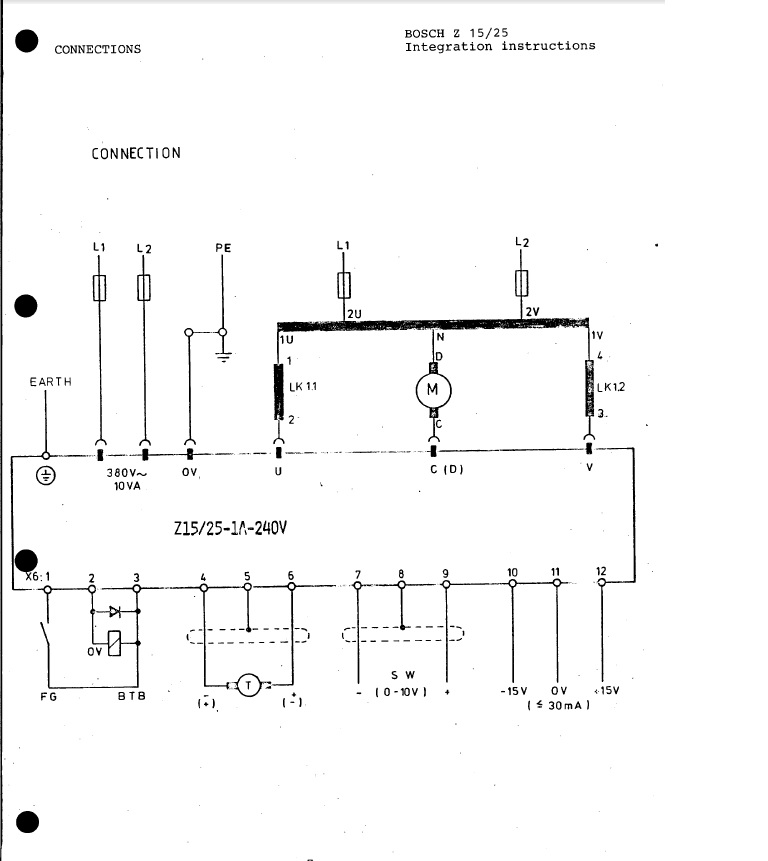

First issue I have ran across is the Servo Amps.
File Attachment:
I have been unable to find any information on these (Z15-1-240v) and when I do find them listed they have been
removed from previous retrofits. Is there a reason I can not use these? I was under the impression I could use

01 Dec 2015 20:46 #66176 by andypugh
I have seen that JohnT has completed this retrofit and used the controller to convert the signals from the resolvers to something usable for the mesa hardware.
I do not have any of the original controller remaining. So my question is if I use the E5 Encoders I should be able to use my servo amps as they are?
Are you sure that the motors have resolvers? From the motor plate it is clear that they have tachometers.
Tachometers are used to close the velocity loop in the drives. It's actually a really simple feedback system. You apply a command voltage, the tachometer voltage is added to the command voltage, but back-to-front so that it cancels out when they are equal. Then the resulting voltage is amplified in voltage and current and sent to the motors. This is why they call them servo amps.
Resolvers and encoders are two different positional feedback systems. As someone on the IRC said a few weeks ago "Resolvers are better in every way except price". If you have resolvers, then keep them.
To control velocity servos with DC brushed drives then I would suggest something other than the normal 5i25 / 7i77 combo. I am currently building a machine using the 6i24 and the Mesa 7i49 There is a similar card with full size PCI if that is what your motherboard has. When JT converted his system there wasn't a Mesa Resolver board.
This gives you position to 12 bits of accuracy, equivalent to 4096 count encoders, but without the single-count dithering of an encoder, which makes it work rather better with a PID controller {opinion}
In fact, I took the encoder off of one of my motors to fit a resolver.

02 Dec 2015 18:49 - 02 Dec 2015 18:50 #66219 by andypugh
Ok, so to clear my head. There are two types - resolvers and encoders. Is a tach condidered either one?
No, a tachometer is just a velocity feedback device.
With modern technology both resolvers and encoders can also give very good velocity feedback, in the digital domain, but that wasn't the case at the time these machines were built. (or, more accurately, it wasn't cost effective to do so)
Also, can I use the Bosch amps with the existing tach in the servos, as it sits? Basically just replacing the controller (TCN 151) and using the Mesa hardware you suggested.
If it worked before, it should all work now.
In theory you just need to provide a new source of +/-10 V control signals. Of course your source of control signals also needs to know where the machine is, so that it can send the _right_ control signals, and that is where the position feedback from Resolvers or Encoders is needed.

02 Dec 2015 23:15 - 02 Dec 2015 23:37 #66239 by cncnoob1979
Replied by cncnoob1979 on topic Planning - Bridgeport Interact 1 linuxCNC Retrofit
The schematic picture shown above shows one of the servo drives. Note that these servos use an analog +/- 10V velocity command for input and use a tachometer on the motor for velocity feedback. This should make the control relatively easy to setup as I only need to close the outer position loop with EMC.
For the initial setup I just used halrun with a test hal file. This way I could test to see that the motors moved according to the command signal and check the position encoder feedback. This was the first setback in the project as I found that the Heidenhain encoders produced analog sine and cosine 125 cycle/revolution output signals. So to handle the encoder output problem I took the encoder interface board from the old Heidenhain controller and mounted it on the back of the cabinet door close to the PC. The Heidenhain board then outputs 625 A quad B digital cycles per revolution giving a resolution of 2500 counts per revolution. The ball screws have a 5mm pitch and are driven by a 2:1 timing belt reduction from the motors. So 2500 counts of the encoder represents 2.5 mm of motion or .001mm per count.
Excerpt from JohnT's Build Webpage
JohnT's LinuxCNC Build Thread
Ok, So my understanding is JohnT had encoders on his servo's, when in fact he had a tach. We have/had the same controllers and from what I have read he used the same servo amps that I have So, I should be able to use Mesa hardware (6i24 and the Mesa 7i49) to interface with this setup as it is with the tach's and at least get it working as is.
So here is some of my confusion with the prior conversations.
So If I interface with the servo amp using +-10v command signals and close the loop with the tach then i should be able to use all existing hardware_Provided I can find some information on my servo amps for wiring purposes.
A user posted this to CNCZone: Shows the pins for the command voltage, assuming its +-10V. This is the schematic for a Interact 1 Mark2
File Attachment:

02 Dec 2015 23:36 #66241 by andypugh
Actually, he had a tachometer and a sinusoidal encoder.
I haven't mentioned sinusoidal encoders so far, something of an omission.
These are something a hybrid between an encoder and a resolver. They have an output a lot like a resolver, two sine waves 90 degrees out of phase. But they are created by optical devices, and whereas a resolver will have 1 or 2 cycles per motor revolution, the sinusoidal encoders have a few hundred. With both a sinusoidal encoder and a resolver the interface electronics takes the arctan of the ratio of the two signals to get a position.
So, you need to first decide if the motor feedback is quadrature encoder, sinusoidal encoder, or resolver. The good news is that you can use any of them with LinuxCNC. (and a few more options too)
You can test the amps with a a low-voltage battery, but the machine will still move at 15% of max speed with a 1.5V battery.

03 Dec 2015 14:17 - 03 Dec 2015 15:37 #66279 by cncnoob1979
I found literature for the Servo Amp z15-1A-240 V / z25-1A-240 V. Was buried in another thread, cant remember where I found it.
Now I need to find out about the Servo's. An encoder was an option for this install, and more then likely - was used.
If this is the case and I have a sinusoidal encoder, will I need to change my hardware? John used the controller board for his. I will not have that option.

03 Dec 2015 16:02 #66284 by andypugh
It looks like the amps take single-phase input. That's a surprise, but rather convenient. It means you just need a transformer.
The two main options for sinusoidal encoders are Heidenhain EXE boxes:
www.ebay.com/itm/181900885922
Or the development board from ICHaus.
www.ichaus.de/product/iC-MG
Despite what I have said earlier, I would be tempted to grab those EXE boxes just in case that that price, then maybe put them back on eBay if they are not suitable.
