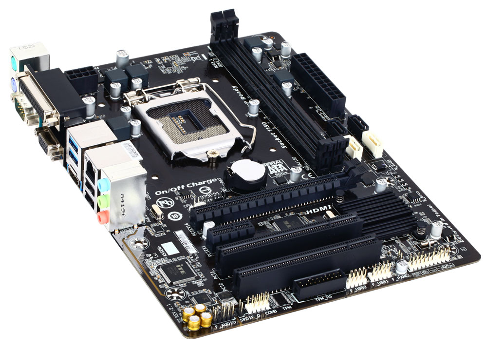

This past weekend I had 3 complete freezes of linuxcnc. I have decided to replace the motherboard and related components. This will allow me to upgrade to Linux Mint LMDE. The processor and hardware will be much more powerful. After reading about it in this
thread
I decided to go with this hardware.
I am still having issues in Gmoccapy frontend, listed in this thread , any ideas on a solution? I am having strage behavior with de-activating my software E-stop in Gmoccapy.
GIGABYTE GA-H81M-S2PH LGA 1150 Intel H81 74$
G.SKILL Ripjaws X Series 8GB $38.00
Kingston SSDNow V300 Series 2.5" 60GB $43.00
Intel G3260 3MB Haswell Dual-Core 3.3 GHz $60.00
Came to $215.00 shipped. Same microATX formfactor.

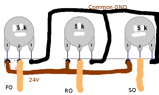

Hey!
One of my pots just started smoking and shorted out. (the power surge shut down the 24v system) I have them wired with all sharing a common 24v source and all sharing the same common GND.
I have posted a quick and crude wiring diagram of how its wired. Is the an acceptable way to wire these, or am I missing something?
The GND is the same ground I'm using in the entire machine. This connection point is shared with the 12v power-supply, and the 24v source is the same that is powering my panel buttons and connects to my field power. The overrides(pot pin 2) are going to the 0,1,2 pins of the 7i77. Should I run another ground wire (star config) back to the grounding plane? Or did I have bad pot to begin with?

Your wiring diagram appears to be correct as is your description for how they are wired. No need to do star wiring for the ground. Either a bad pot or it not really wired like you think.

Is there any load on the output? (I assume it goes to a Mesa analog input, in which case it ought to be "no")

Thanks for the response guys.
No there is no load on them. Just going to the 7i77 analogs. PCW said the load from the 7i77 would be around 22k.
I'm fairly certain I had a bad pot. Guess we will see.

Do you know the specs for the pots?? With a 5K value you are only dissipating 4.8 mA but multiply that by 24V for wattage and you get 115 milli-watts If your power supply varied by just 1 volt to 25V you would be at 120 mW which is very close to the common 1/8 Watt rated pots. You may want to consider switching to 1/4 or even 1/2 watt pots or changing the value to 10K for some extra operational safety margin.

Yes the pots are 5k @ 1/2 watt.
I do believe I found my particular issue. The pots have a "nib" extended from the mounting base to prevent it from rotating when properly secured.
However since I was just temporary mounting these to a "test" panel I did not bother to cut out for the extrusion "nib" on the pot. So I snug down the pot, not real tight but apparently tight enough to have "warped" the pot's base enough to cause a direct short.
At least that is my conclusion... so user error yet again

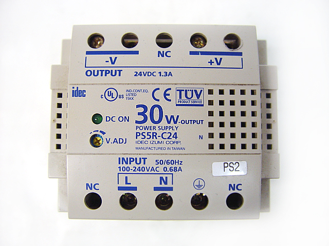

Also, just for my piece of mind I installed a 30w regulated 1.3A / 24v DIN mounted power-supply [PS5R-C24]. So now my 24v system is regulated, I feel much better about that.
