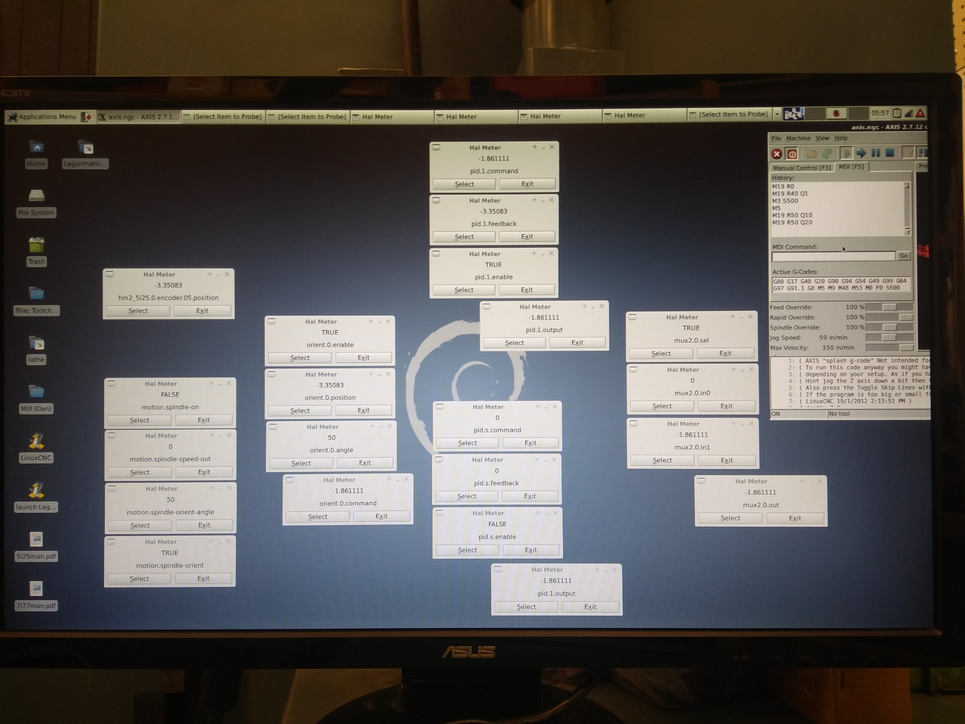

Tonights update - still there there yet but I think it's getting close.
I standardized on pid.s and pid.1 for velocity and position respectively. I tried using the code above but ran into a couple issues - first it seems like I needed to loadrt pwgen (not sure if I did it correctly) and then once I got past that stage the config loaded with this error:
Ok - this didn't seem right so I commented that line out and decided to trace and confirm all the signals just to make sure the logic was happening correctly. Using this diagram I opened all the pertinent HAL Meter boxes and ran two tests:
1. I turned the spindle by hand and ensured all the pins appeared to be reading encoder, velocity, position information correct [PASSED]
2. Feed it codes through the MDI to verify the position/velocity mode logic is working [PASSED]
I took "screenshots" to show the values and confirmation (yes I took a photo of my monitor because I'm completely stupid when it comes to Linux!!) I sent M19 R50 Q20 for the orient command and M3 S400 for the velocity command.
Ok so this seems good so far. At this point I am getting a value out of mux2.0.out fore each scenario but I cannot successfully pass it to hm2_5i25.0.7i77.0.1.analogout5.

Replied by andypugh on topic Lagunmatic 3516-SX Retrofit
You don't need the pwm, just get rid of it.
Make the change I suggested 2 posts back, you don't need the abs, or the other stuff around there.
I don't see any evidence of the mux2 that is used to switch between the two PID control outputs.

My file is a mess but I did get get rid of the abs section and mux2 is in there. In the screenshots mux2.0.out is correctly passing mux2.0.in0 or mux2.0.in1 based on which mode I'm in.
It seems like I should be able to directly assign mux2.0.out to analogout5?
If I get that done, and analogout5 has a single but the spindle does not move, is it reasonable to assume there is an issue with the PID gain values and move on to tweaking those?

Yes, that is what you need
Or, put it on one line
(I am making up the pin names there, you need to check them against your actual HAL)
Is the spindle-enable being set in both cases?
net spindle-cmd mux2.0.outOr, put it on one line
net spindle-cmd mux2.0.out hm2_5i25.0.7i77.0.0.analogout5(I am making up the pin names there, you need to check them against your actual HAL)

Best update of the night is that I remeasured the height of the machine and, as long as I take off the Z-axis servo, it turns out I will be able to fit this machine into the new house. The garage has 8ft doors the tallest permanent hard spot is about 88". YES!!
Ok - so Andy was right about the spindle enable preventing movement. However, I cannot for the life of me figure out how to incorporate it into the logic. Because I have the velocity-mode signal connected to motion.spindle-on I don't seem to be able to drive hm2_5i25.0.7i77.0.1.spinena with motion.spindle-on (through the spindle-enable signal that is standard).
I've racked my brain over and over but I can't come up with a solution - advice?
To keep progressing, I started my config using the .hal below and used halcmd to sets spindle-enable true. This gave me signal on analogout5 in both modes (success) but only resulted in movement when I was in velocity mode.
So once I can get the spindle enabled in both modes, then I need to:
1) determine why there is no motion in orient mode
2) scale the spindle speed correctly
The two might be related? I found a diagram that shows a similar logic setup for position vs. velocity mode that incorporates some scaling but I haven't fully digested it yet. It seems to be setup differently than how I have it now (where 1 spindle revolution = +1 encoder position).
spindle hal section below. It's been cleaned up, I left my attempt at using an or2 component to flip the spindle-enable but, again, I run into the issue of the pins already being in use.

# this switches modes
net orient-mode motion.spindle-orient orient.0.enable pid.1.enable mux2.0.sel
net velocity-mode motion.spindle-on pid.s.enable #hm2_5i25.0.7i77.0.1.spinena
net orient-dir motion.spindle-orient-mode orient.0.mode
# ---Encoder feedback signals/setup---
setp hm2_5i25.0.encoder.05.counter-mode 0
setp hm2_5i25.0.encoder.05.filter 1
setp hm2_5i25.0.encoder.05.index-invert 0
setp hm2_5i25.0.encoder.05.index-mask 0
setp hm2_5i25.0.encoder.05.index-mask-invert 0
setp hm2_5i25.0.encoder.05.scale [SPINDLE]ENCODER_SCALE
net spindle-cmd mux2.0.out hm2_5i25.0.7i77.0.1.analogout5
net spindle-index-enable <=> hm2_5i25.0.encoder.05.index-enable
#loadrt or2
#addf or2.0 servo-thread
#net velocity-enable or2.0.in0 pid.s.enable
#net position-enable or2.0.in1 pid.1.enable
#net spindle-enable or2.0.out
#net spindle-vel-cmd-rps <= motion.spindle-speed-out-rps
net spindle-vel-cmd-rps-abs <= motion.spindle-speed-out-rps-abs
#net spindle-vel-cmd-rpm <= motion.spindle-speed-out
net spindle-vel-cmd-rpm-abs <= motion.spindle-speed-out-abs
#net spindle-enable <= motion.spindle-on
net spindle-cw <= motion.spindle-forward
net spindle-ccw <= motion.spindle-reverse
net spindle-brake <= motion.spindle-brake
net spindle-pos => motion.spindle-revs
net spindle-at-speed => motion.spindle-at-speed
net spindle-vel => motion.spindle-speed-in
net spindle-index-enable <=> motion.spindle-index-enable
sets spindle-at-speed trueCurrent spindle PID section for reference. Just playing with numbers right now to see if they affected the motion:

The lack of movement may also be related to some setting in my VFD. I have noticed that the minimum spindle speed to initiate movement is lower than I expected. As far as the VFD is concerned, it thinks it is running in open loop between a min and max frequency
