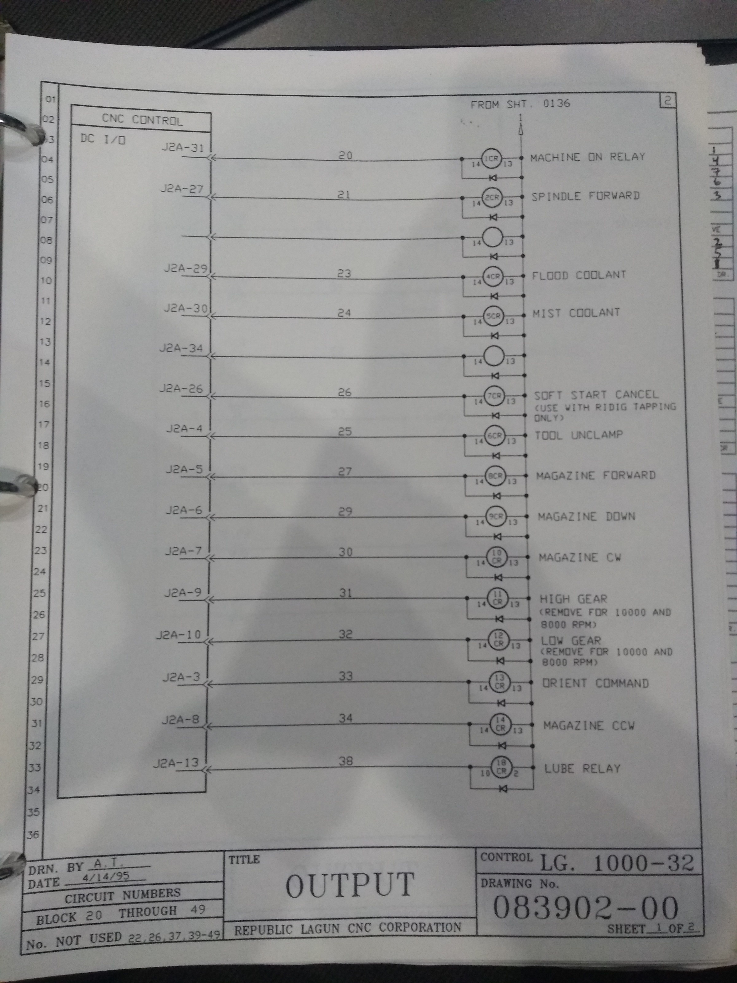

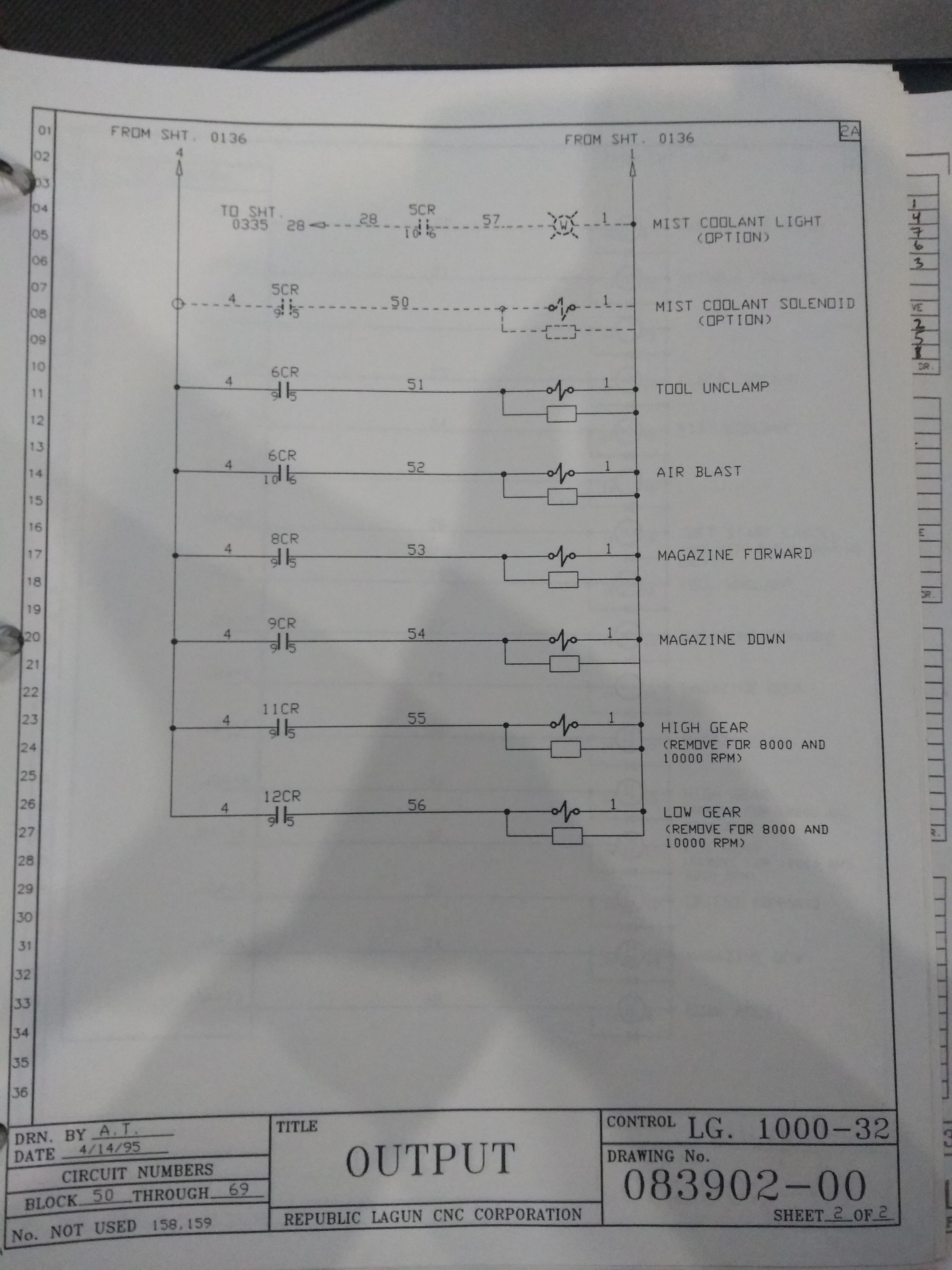

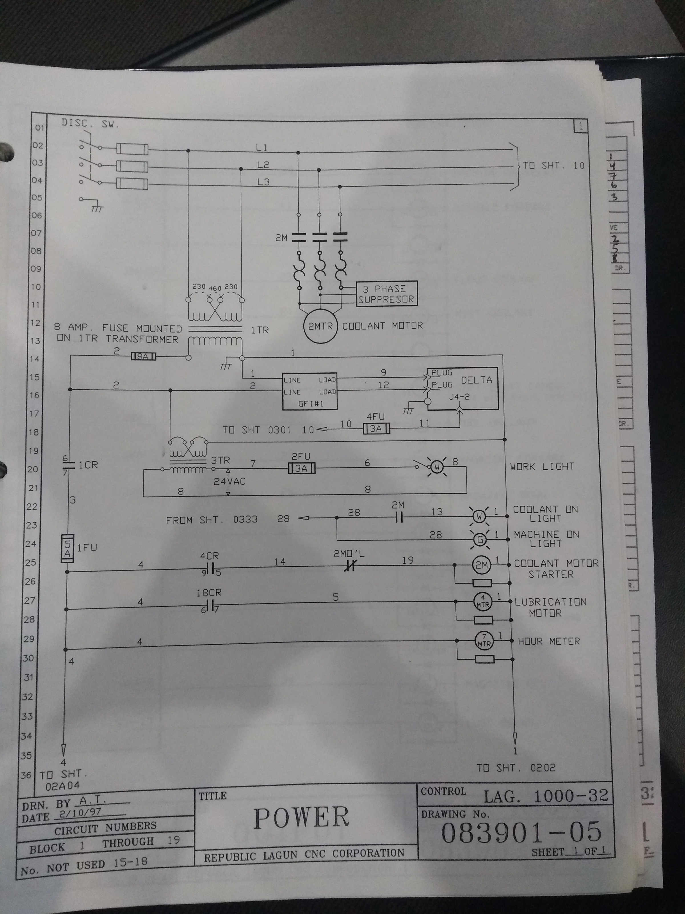

18 Apr 2018 22:50 - 18 Apr 2018 23:14 #109280
by giz
Replied by giz on topic Lagunmatic 3516-SX Retrofit
I ended up connecting a different power supply hoping it would make a difference - it did not. Same behavior as before - it will output 24v and power the 7i77 just fine until I connect the common wire to the V- side of the circuit. At that point, just like the original, the PS stops supplying DC voltage.
I brought in an extension cord and disconnected the input side of the 24v power supply from everything. I supplied power to the PS with 120v from the wall. Same behavior.
Schematics for the incoming power and outputs:
Last edit: 18 Apr 2018 23:14 by giz.

19 Apr 2018 22:34 #109324
by islander261
Replied by islander261 on topic Lagunmatic 3516-SX Retrofit
Giz
Looking at the drawings you posted I can see no reason why you can't make this work. All the power supplies you add need to be completely isolated input to output, this includes any chassis ground connections. Use your ohm meter to check them out. Did you have the safety ground connected in the extension cord you used for your test? If you disconnect all the outputs on your 7I77 does the power supply still fail when connected? A sketch of how you have wired your 7I77 to everything will help. The drawings do not show the servo power supply and wiring, this will also help.
John
John
