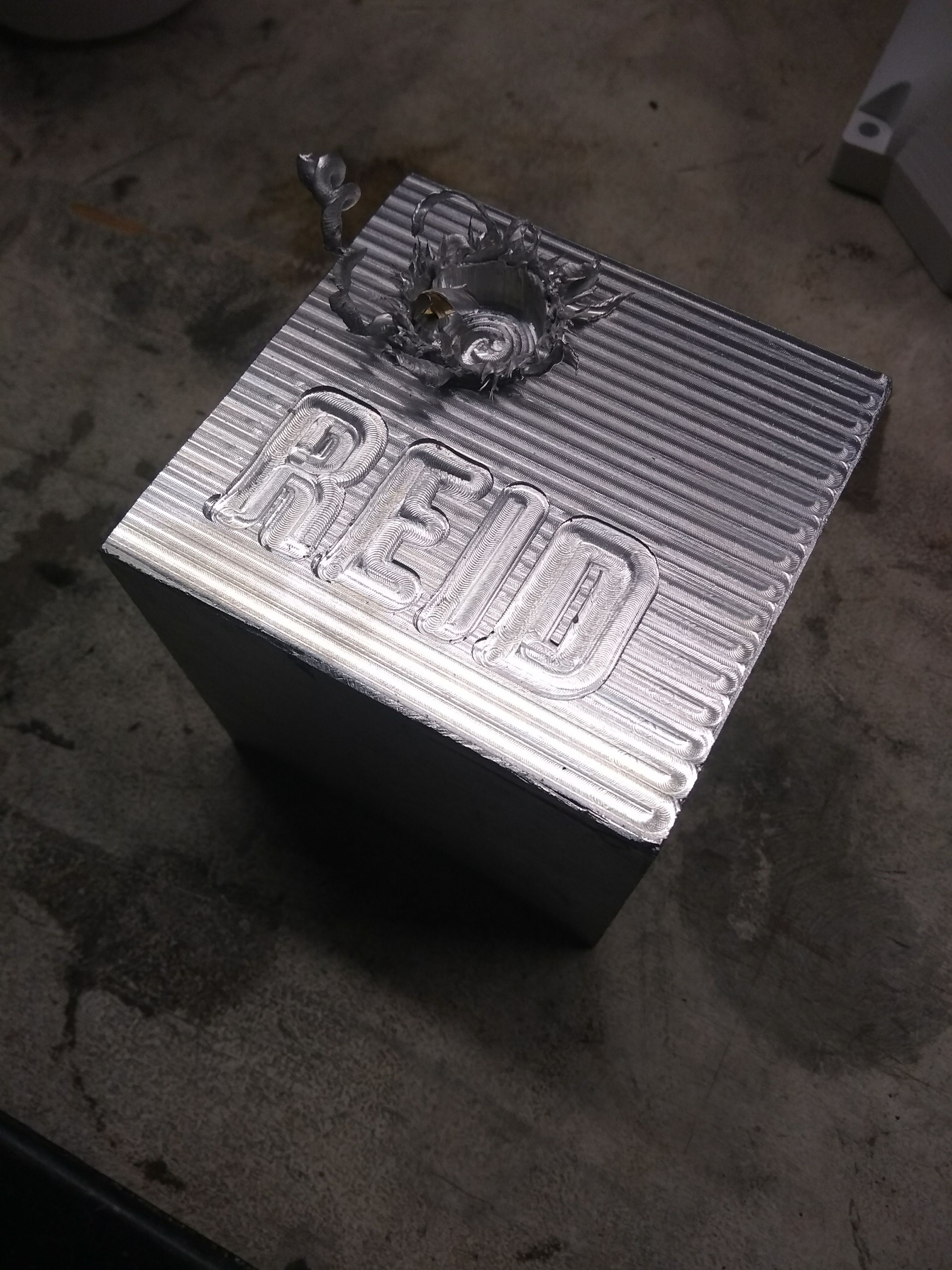

Thank you Peter!
I had to take a break from trying to figure out the spindle/ATC and just cut something today. I've had this machine now for 2 years and haven't made any computer-controlled cuts and it's been eating away at me.
The cuts aren't great - I need to relevel the machine, tighten the X-axis gibs, and spend more time tuning the servos. Feeds/speeds were back of the envelope and clearly too much for the little 3/16" HSS tool in the pocket
But to me, today, this is a trophy. Really appreciate everybody's help and I'm feeling motivated - leaving for IMTS tomorrow and can't wait to get back to the machine next weekend.

Re-tuned XYZ axes and am pretty happy with where they are now. Still believe the X gibs needs to be tightened because I hear a thud when changing directions from X+ to X- (tightening the gibs moves it in the X+ direction).
Thinking about the spindle position PID - is it possible that running my VFD in vector mode is causing trouble with the Linux control loop?
When I was running the part in the last post I heard some variation in my spindle speed so I need to look into the VFD parameters there as well.
