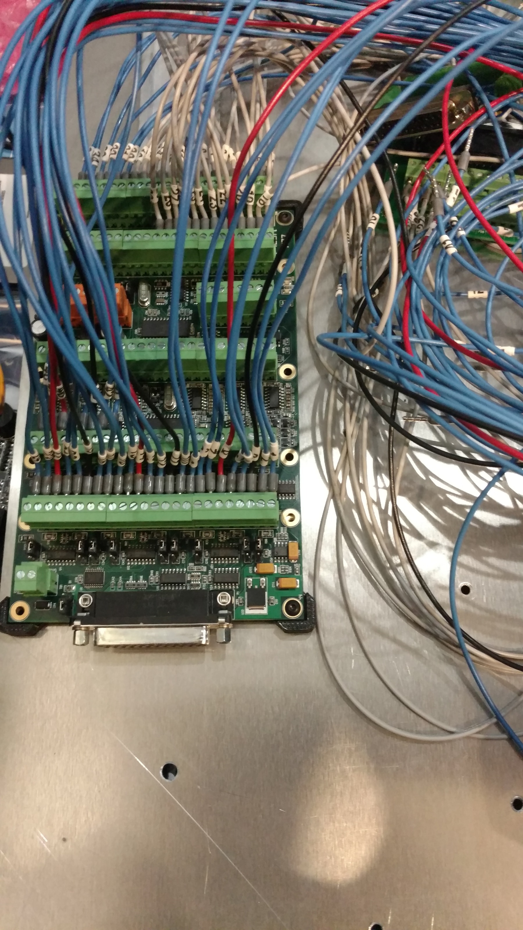

Replied by lunada on topic Lagunmatic 3516-SX Retrofit
looks great, my only concern would be getting to the wires on the breakout boards easily once it's all together. It's pretty nice to be able to easily probe terminals or disconnect stuff as needed, without disturbing anything.

Thanks! I used your panel as inspiration... again, you helped a lot.
I definitely prioritized compactness over serviceability. I expect some headaches but at least it all fits. There is room for an additional I/O card if needed, only have the 5i25 and 7i77 in there right now. I have a USB MPG pendant so not certain how many physical buttons I'll end up with in the end.

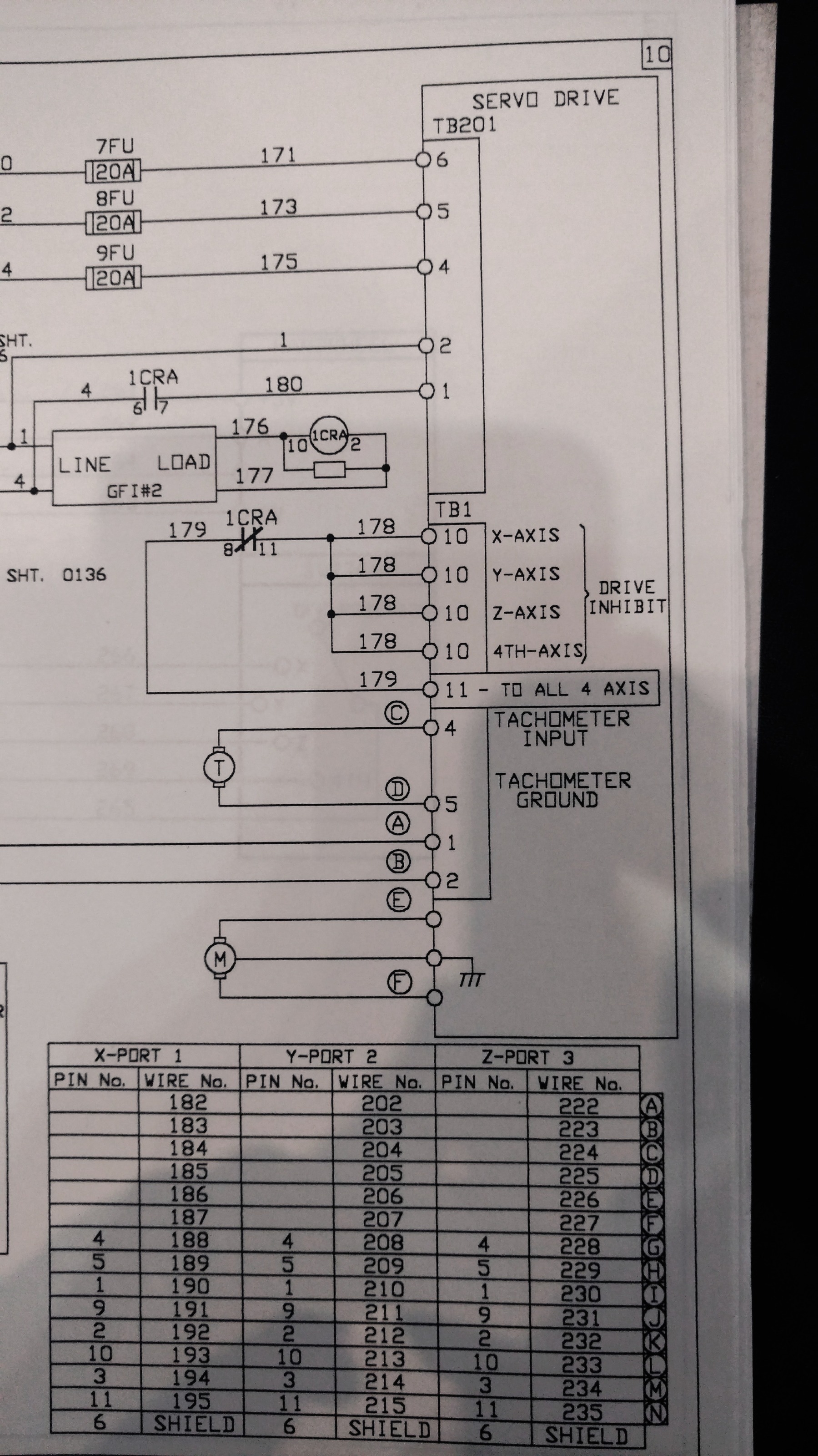

I could use some help finishing the wiring of the servo cards to the 7i77. From my servo cards, I have connectors with the following signals:
I have all but Pins 6, 7, 8, and 15 connected to the 7i77 TB3 encoder pins. What I am confused about his how to correctly connect the 7i77 TB5 ENA-, ENA+, GND, and AOUT signals?
I have shielded, twisted pair cable for these remaining connections. I believe I should connect Pin 8 "Signal Servo Drive" to AOUT and Pin 15 "Signal Return Servo Drive" to GND. That leaves me with zero available pins for the enable signals? I don't see any reference to drive enable signals in the Glentek GA370 manual (attached) either, so I'm a little confused?
Also, where should I connect the cable shield on the 7i77 side?

Your signal connections sound correct
The analog signal shield should be terminated at the AGND pin
The encoder shield pin should be grounded at the encoder GND pin
It appears the drive enable is called "lock out" and must be grounded to disable the drive
this means you will likely need a relay (it may already be there) that has a NC contact that grounds "lock out"
until the relay is activated by the controller

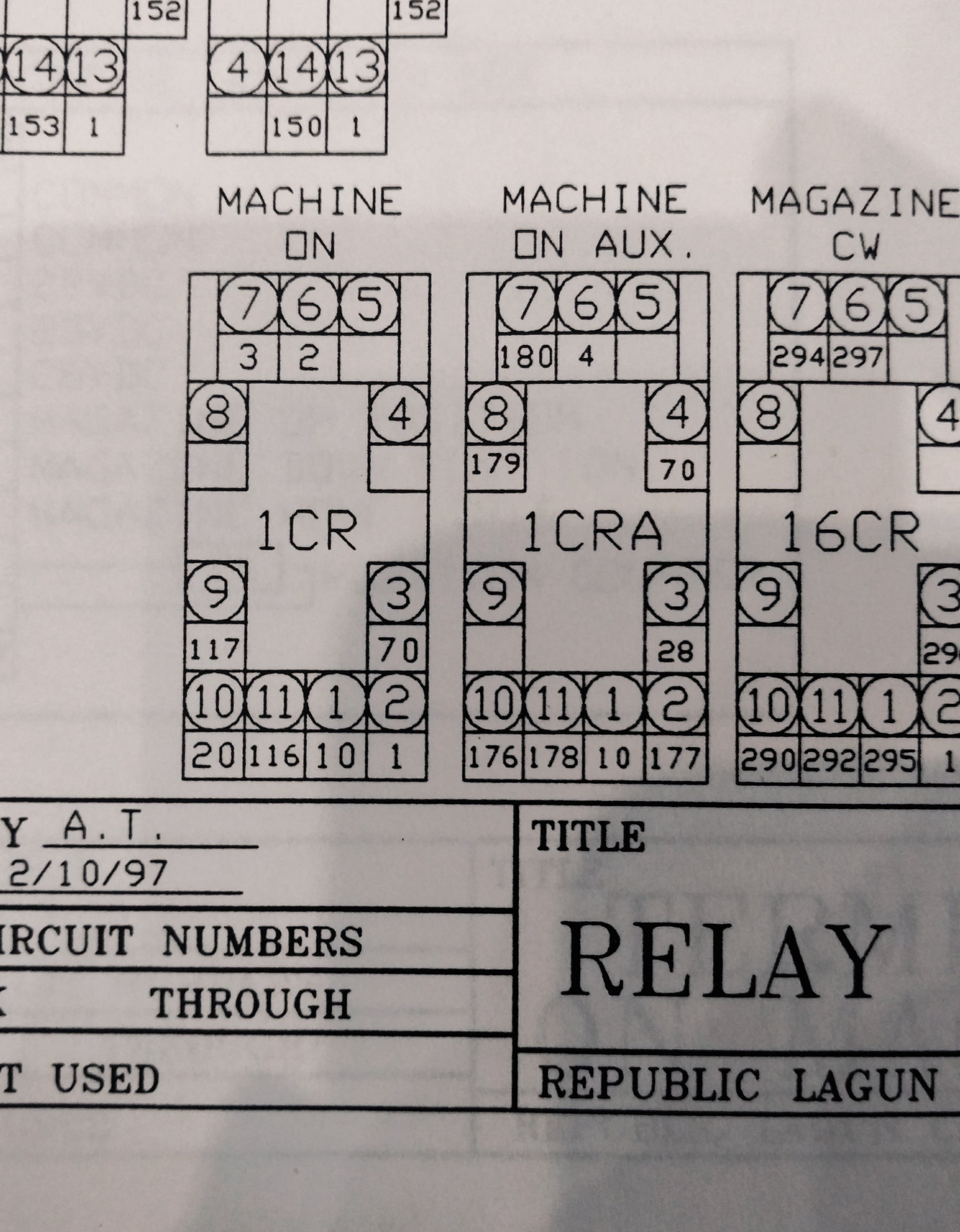

Looking at the wiring diagram, I can see you are correct about the relay existing. I haven't traced all the wires yet, but I believe this 1CRA relay is tied to the "Machine On" button. If this is the case, can I leave the enable pins on the 7i77 empty?

Yes, you can ignore the ena lines and run the lock-out relay from a 7I77 field output instead
