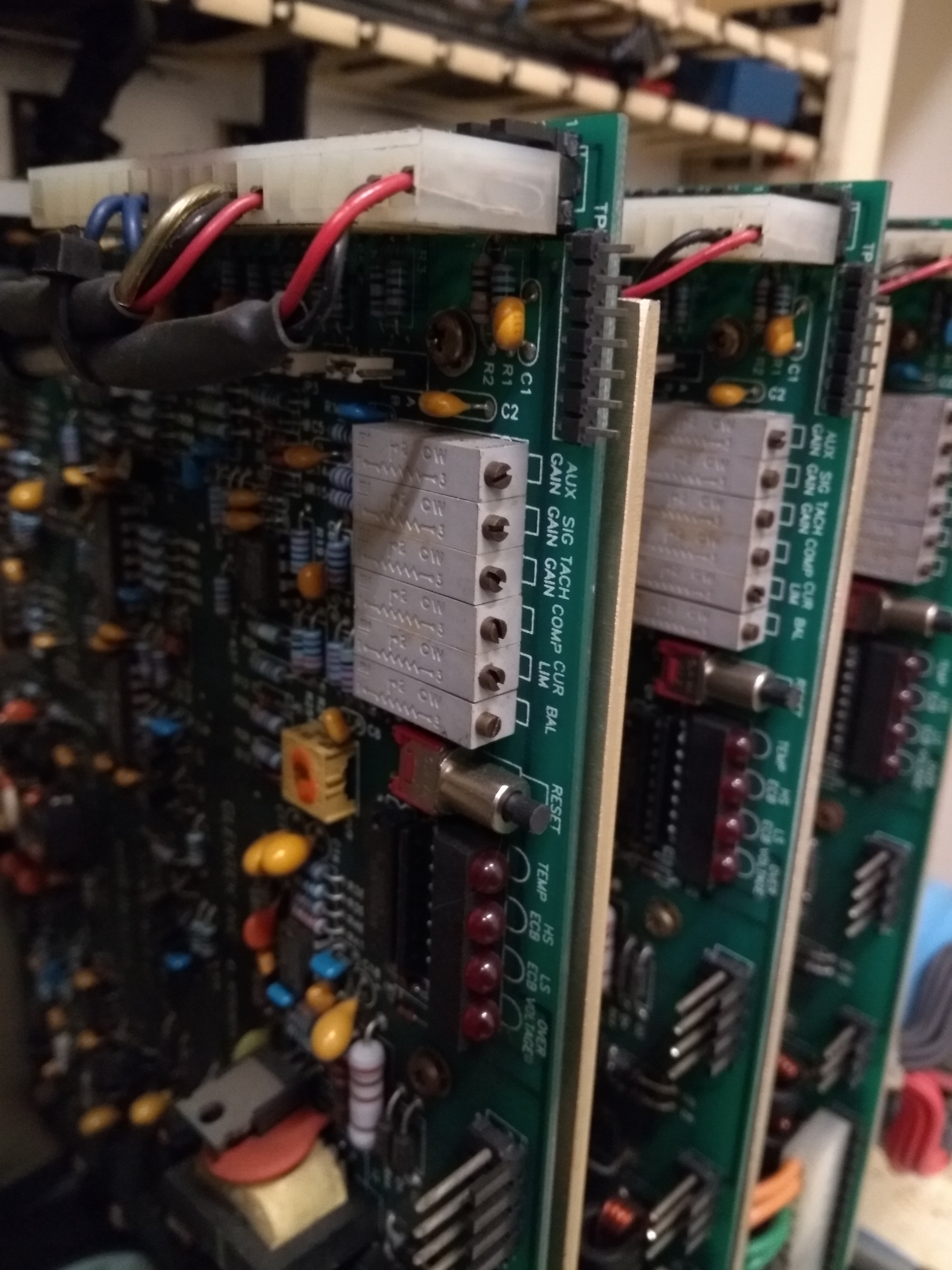

The computer powered up just fine, and I started LinuxCNC. Right away I got error messages saying Joint 0 through 2 were in the Home position. This wasn't true for any axis, but I was able to clear the message by manually pressing the limit switches.
Next problem I realized was that the servo amp cards had no power. These should be activated through a relay tied to the 'Machine On' pin. I confirmed continuity from the 7i77 pin to the screw at the relay, but cycling Machine On did not activate the relay. Instead of investigating further, I simply bypassed the relay for now.
Once I had power to the servo amps I was hoping I would be able to move the axes. Alas, I struck out again. Jogging all axes results in no discernible response except a Joint Following Error.
Nothing has been easy about this conversion! I'm so impressed by all the other builds out there, a couple really went quick and I've floundered at every step. Pushing forward...

I widened the F error and opened up Halscope hoping to adjust the P value for the servos and and see some movement.
No such luck - I went as high as 200 didn't see movement on X or Y (didn't try Z)
So I figured I'd try Peter's suggestion and manually apply a signal voltage to see what happens. To my surprise as soon as I disconnected the plug that carries the signal and tach the table quickly jumped 5-6" in the X+ direction before the control stopped it due to F error.
That caught me by surprise!
I tried unplugging the Y card and the same thing happened only it moved about an inch before stopping.
When I unplugged Z nothing happened. Hmmmm.. with it unplugged, I adjusted the Balance pot on the card (see attached photo) and was able to very reliably move the spindle up/down. Cool!
When I plugged the card back in, the spindle would no longer react to the Balance pot and it still did not move when I tried to jog it through the control. I did not try adjusting the P value.
I thought maybe if I adjusted the Balance in X I could keep it from running away when unplugged. I turned it CCW a few times and unplugged... the table oscillated. I turned the Signal Gain CCW and it didn't oscillated any longer but the Balance was too sensitive to control the table.
At this point I called it a night knowing I was lucky I hadn't already broke something and need to read more.

Replied by PCW on topic Lagunmatic 3516-SX Retrofit
You really should never unplug servo interface connections live nor should you operate
the drives without tachometer feedback..

I would (with power off) disconnect the analog signals at the 7I77 end
The reason you should not run velocity mode servos with the tachometer
disconnected is that they will usually run away, perhaps at high speed.
This is because the velocity feedback from the tachometer forms
a PI loop, and without feedback the integral term can increase to full torque
in a short time with just a minor balance error.
An analog velocity mode servo that is enabled, and has its analog input open
(but has tachometer feedback) will typically hold position but drift slowly
(this is normal and OK)
If you apply a small voltage (1.5V would be 15?% of full speed) the motor should
and immediately stop (go back to very slow drift) when the voltage is removed
If you got no response when you ran LinuxCNC (and you have some non-zero P term)
I would suspect a wiring issue. We have seen people attempt to change feedback direction
by swapping the 7I77s AOUT/GND pins at the drive. This will work if the drive has differential inputs
(IN+ and IN-) but will short out the 7I77s analog outputs if the drive has single ended inputs
(IN and common or GND)
