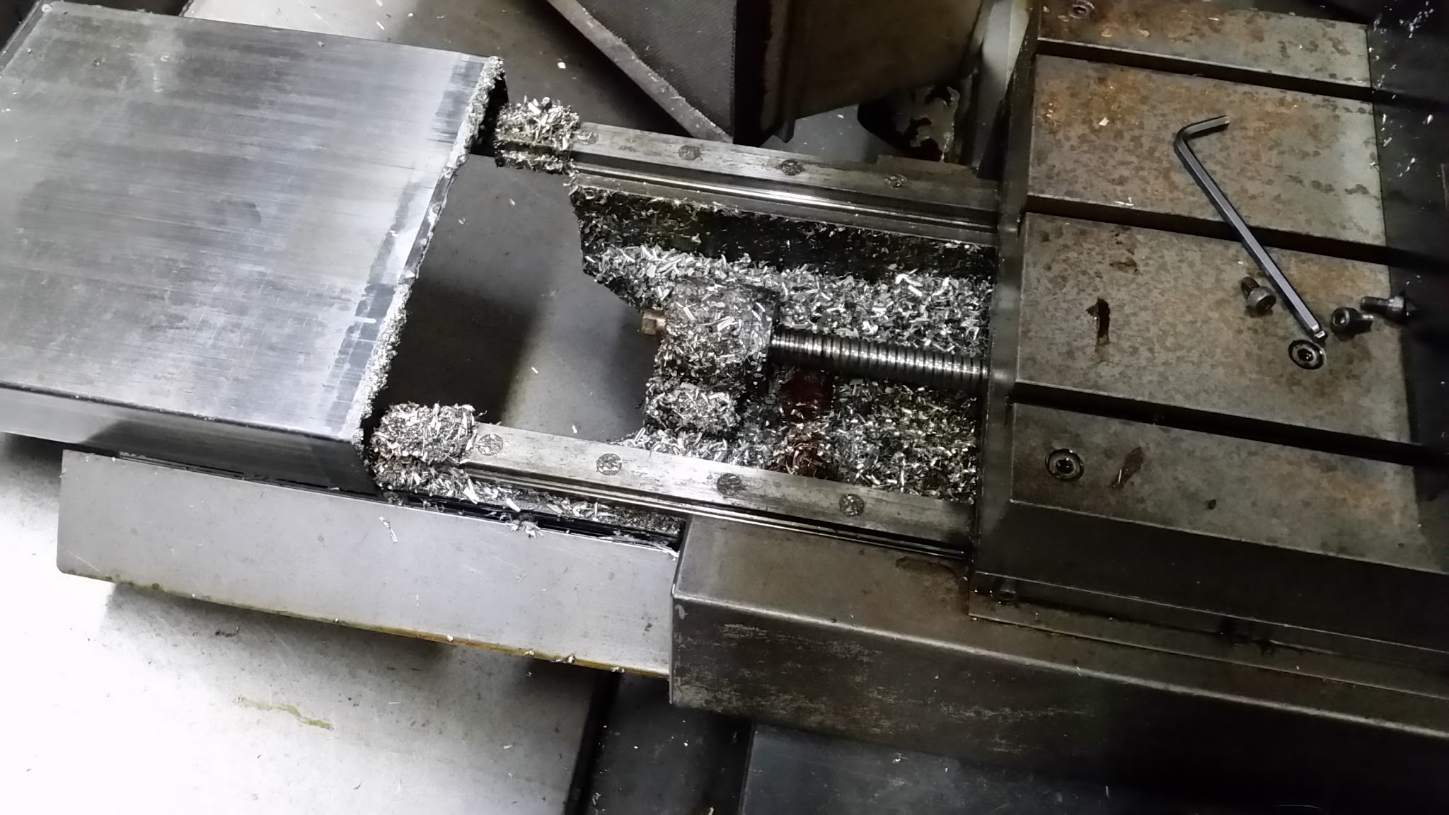

17 Feb 2017 21:48 #88132
by ihavenofish
chips! sady, not new ones. haha. yup, they are a bit filthy, but ive gone over them some more, pulling way covers off and they seem in good mechanical shape. dont feel any play, doesnt seem to be any backlash manually turning the screws on the x and y.
im pleased so far. ive determined that both machines should turn on, as is. so, that is the next step. still waiting on the plug wiring.
fun fun.
Replied by ihavenofish on topic Brother TC-225 / TC-229 adventure!
fun fun.
