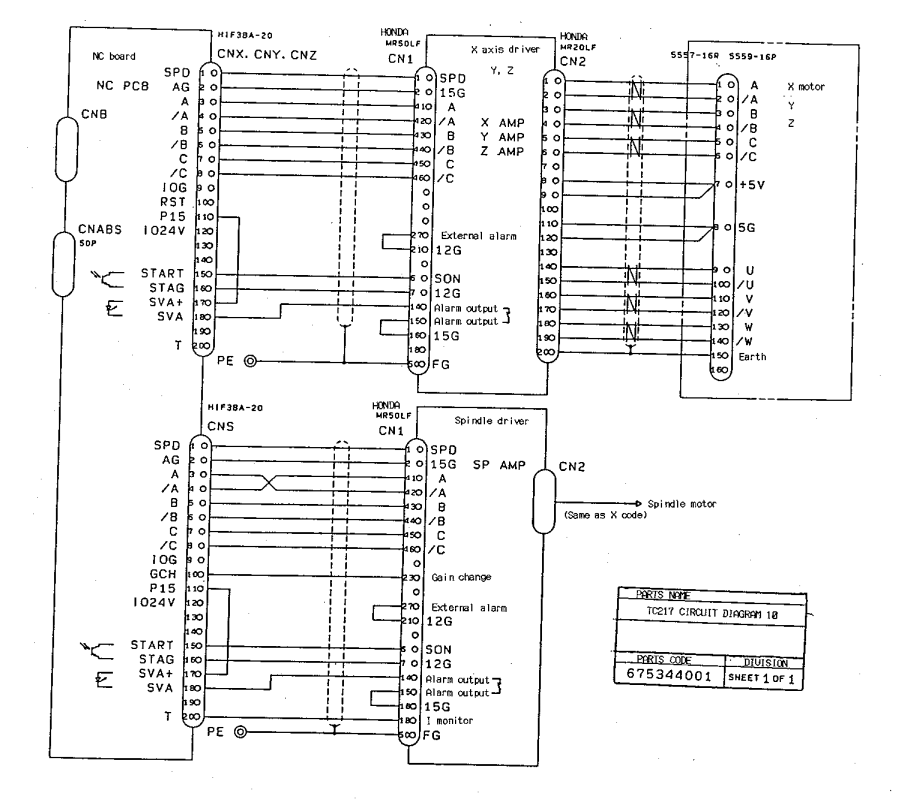

These are ac servos. noise should not be of any issue as it a differential analogue signal.
I think its just connected wrong.

I never got that far with mine. I dont think its covered in this thread, but i think some others did it elsewhere. I think most people switch the spindle to A axis, and then home.Does anyone happen to know how I can connect the spindle orientation?
I have the spindle turning, but not yet the orientation

09 Nov 2024 02:10 #314104
by Philip Lydin
Replied by Philip Lydin on topic Brother TC-225 / TC-229 adventure!
its fixed now, it was some small potentiometer on the drive that was set to set wrong position and after that it runs super smooth
