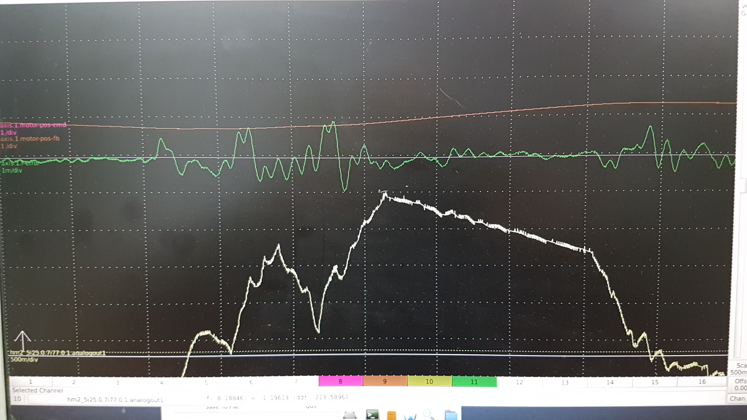

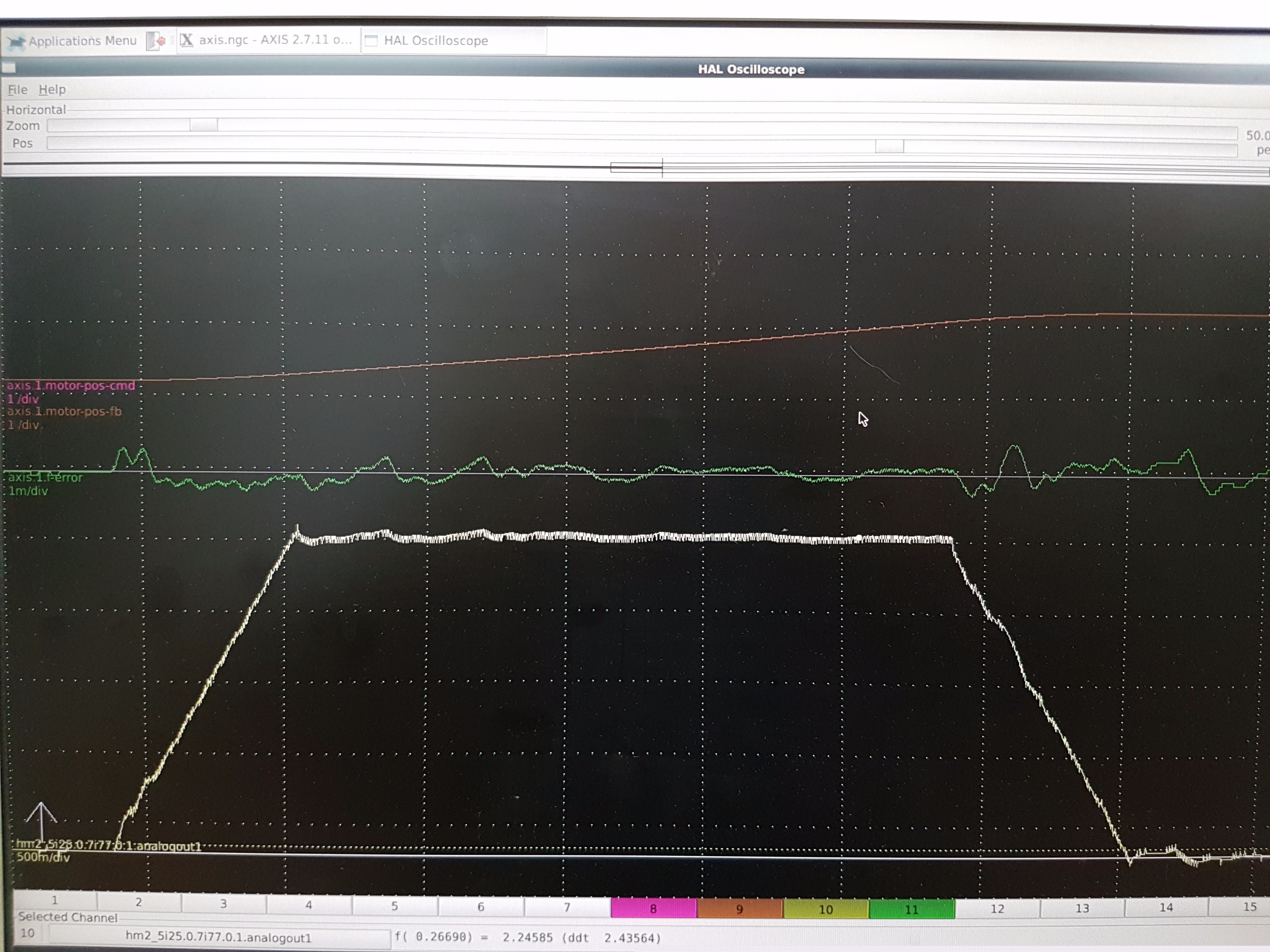

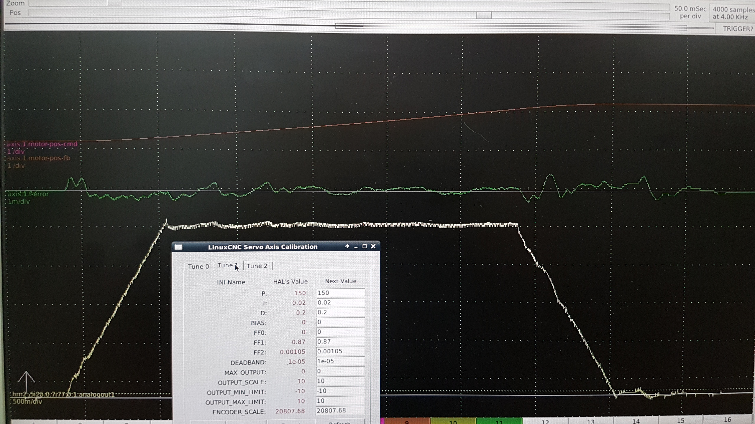

26 Aug 2017 00:33 #98032
by ihavenofish
Replied by ihavenofish on topic Brother TC-225 / TC-229 adventure!
Linux pc not networked and no is stick.. . So here's a pi ov the screen.
This is y axis 200ipm 1 inch move 0.25g
F error is .001 inch per segment. 1 encoder count is .00004 inch.

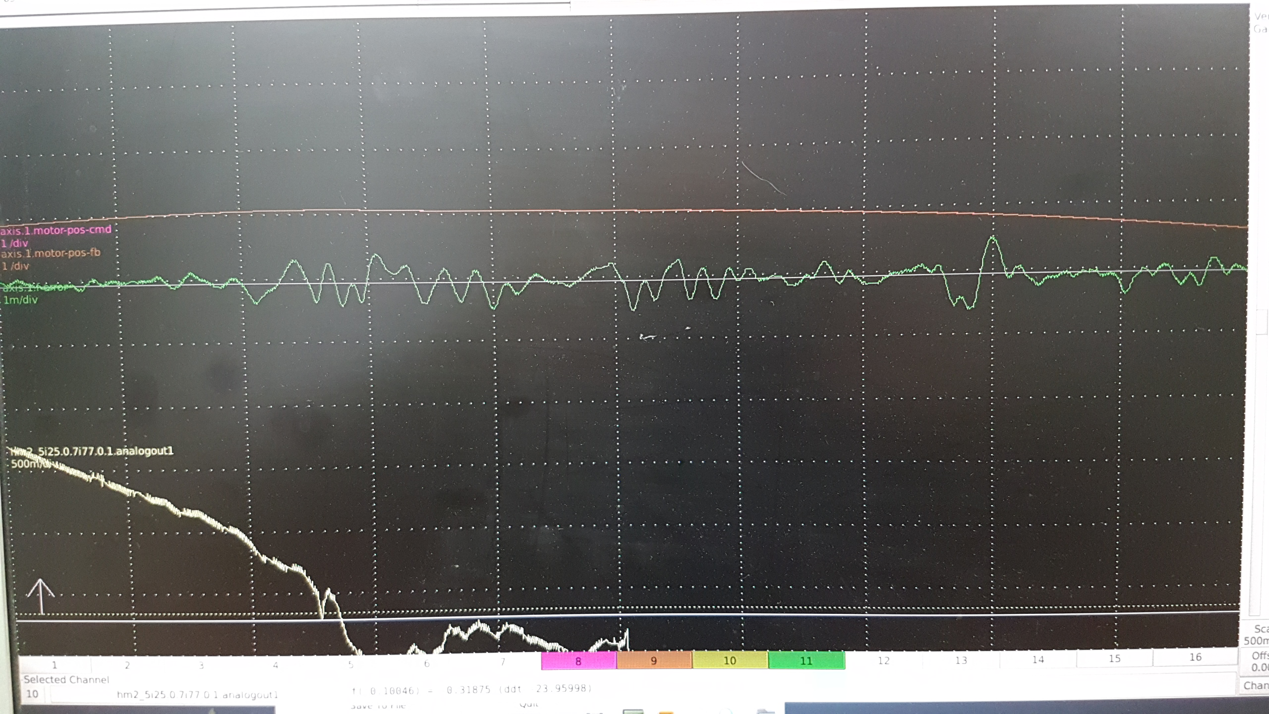

- ihavenofish
- Posts: 1029
- Thank you received: 286
26 Aug 2017 00:41 #98033
by ihavenofish
One pic of 33ipm jog.
One of the clunky jerky part of that adaptive clearing 400 ipm which should have been a smooth arc.
- Posts: 18104
- Thank you received: 5328
26 Aug 2017 03:00 - 26 Aug 2017 03:01 #98034
Replied by PCW on topic Brother TC-225 / TC-229 adventure!
One thing the would help a bit is plotting the commanded velocity and the encoder velocity
The commanded velocity would show the TPs motion better than position does
The encoder (feedback) velocity might shed some light on source of the high frequency oscillation
