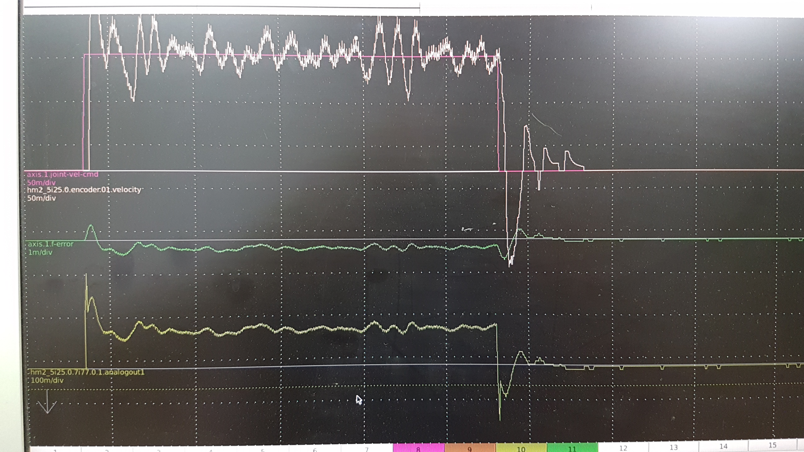

8ipm jog same pod settings as before

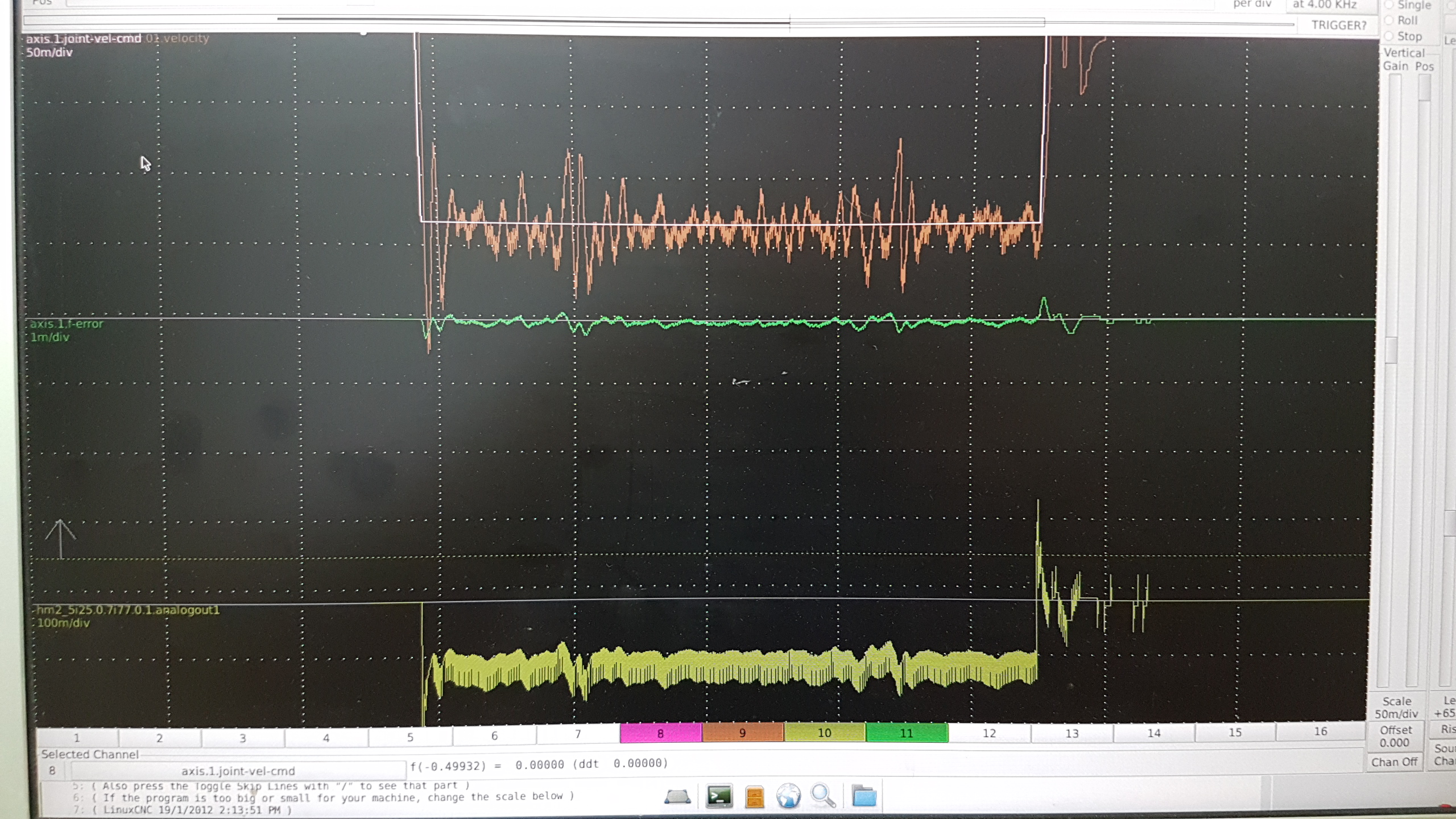

Still not clear where the HF noise is coming from
Can you try the same with D=0 (You really should not need D in velocity mode)

No d is similar looking. I'll do a plot in a bit.

D 0
I'm looking at a out and I see it is almost exactly as f error. This seems odd to me

What were your PID, FF1. FF2, and Deadband settings for the above 2 plots?

P 150
I .02
D .2
Ff0 0
Ff1 .87
Ff2 .00105
Bias 0
Dead band. 00001
P 150
I .02
D .2
Ff0 0
Ff1 .87
Ff2 .00105
Bias 0
Dead band. 00001

I think I would try reducing P to about 100 and setting I and D to 0. See if that gets a mostly smooth velocity plot. Then fine tune FF1 and FF2 to minimize the following error. Once there, then you should be able to add back some more P to try to stiffen things up.
