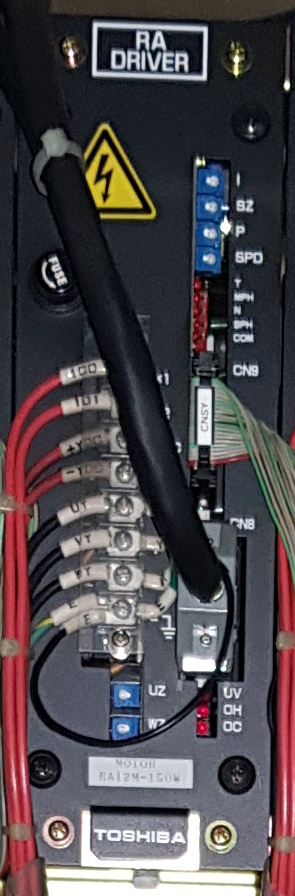

Which brings me to the next problem: I don't have a manual for the Toshiba RA Drive.
There are 6 potentiometers on the front. I, SZ, P, SPD and WZ, UZ
I and P are clear,
SPD = speed?
SZ = ?
WZ = ?
UZ = ?
I and P are clear,
SPD = speed?
SZ = ?
WZ = ?
UZ = ?
